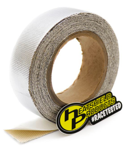

Jeff, I have the same problem I was going to try the insulation, anything special was the insulation you used? a wrap type? WHere did you purchase the insulation? I tried checking my fuel pressure but the Schrader valve must be bad I get zero fuel pressure
oldtimer
May 2, 2016
22
Santa Clara County, CA
I used Thermaflect tape (see post #69) to insulate fuel rails.
Still chasing problem. I will try 15-50wt oil next. Maybe a hot oil, low pressure issue??????
https://www.amazon.com/gp/product/B000QFN3DU/ref=ppx_od_dt_b_asin_title_s00?ie=UTF8&psc=1
JEFFC
Jul 30, 2016
18
22
I would get the pressure test and bleed off figured out before proceeding just to verify that your problem is the same as mine was. I have had several members message me back that this was in fact their problem. Verify by performing the fuel bleed via a few key cycles. No reason to wrap the lines and fuel rail manifold if bleeding the fuel doesn't allow it to start instantly. Refer back to post 14 for the materials and here is a link for the 3/4 inch wrap that I used on the lines. I don't see the 1 1/2 inch listed now but any of the larger sizes should work since you will be doing a lot of cutting and zip tying around the fuel rail manifolds.
3 feet Fire Sleeve Braid Flame Heat Shield 3/4" Fits 10AN for Oil Fuel Lines Red | eBay
