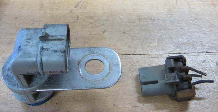

I had similar issues. The final fix was replacing the CPS connector (plug with pigtails).
The added length of wire allowed the mechanic to route wires a little farther from manifold heat source.
