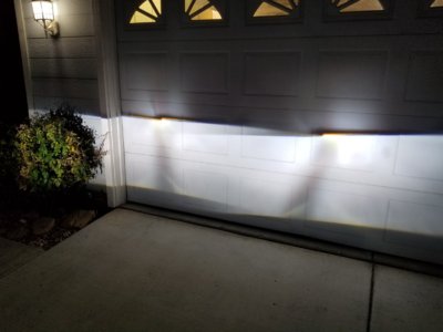

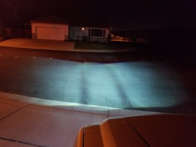

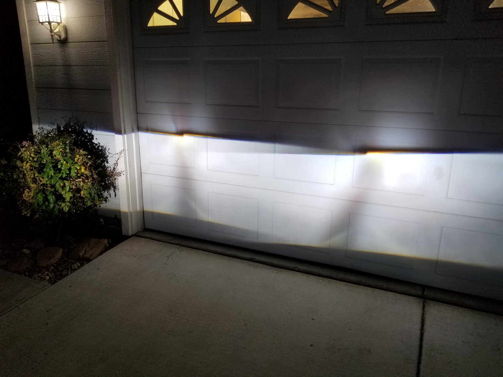

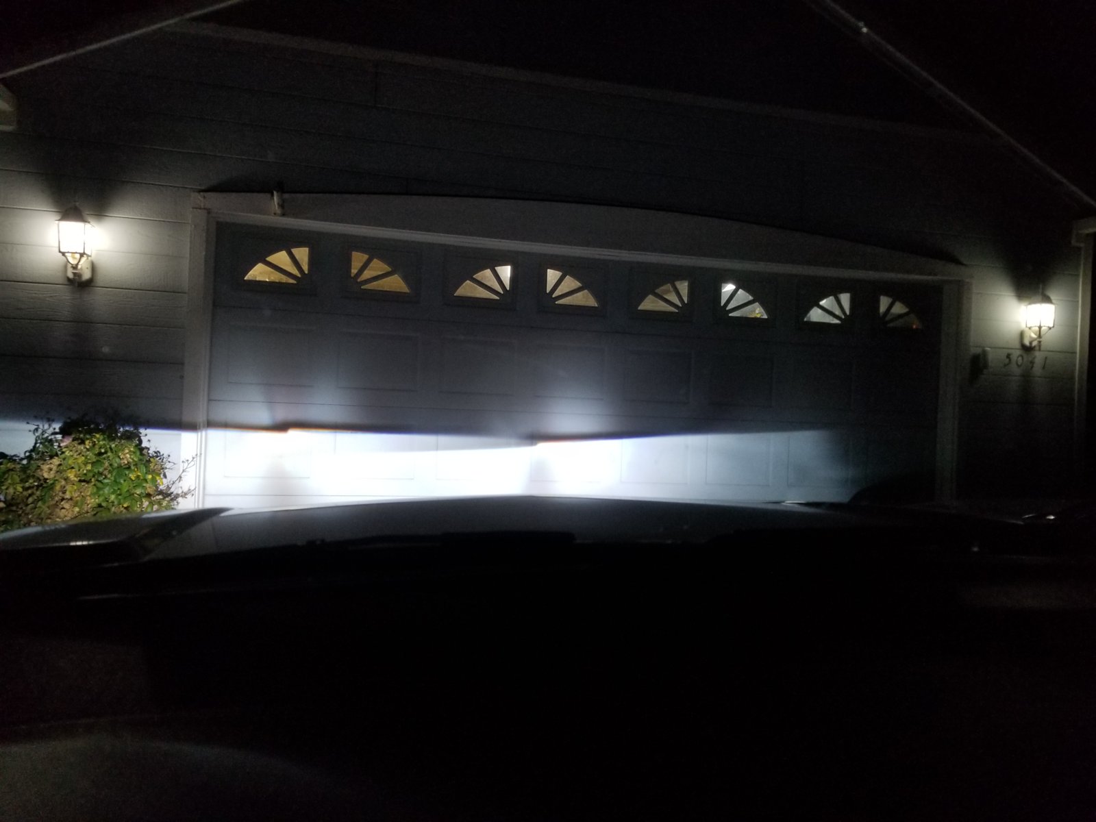

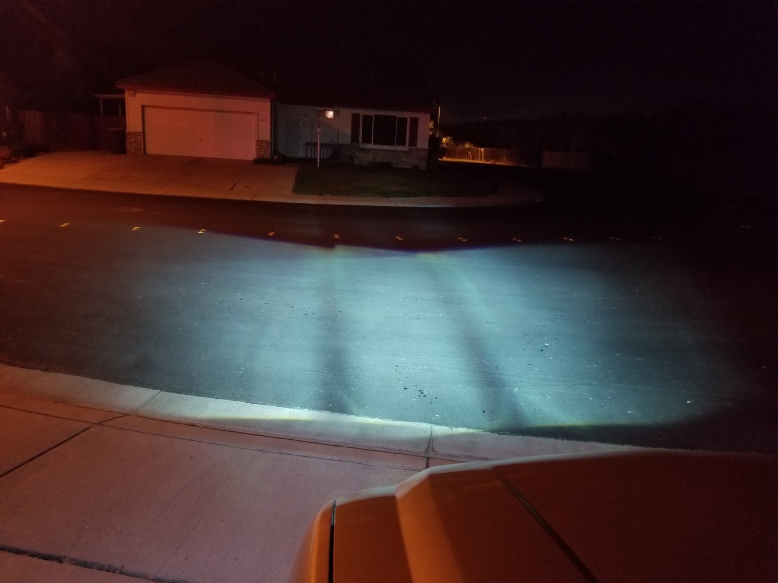

Good Morning/Afternoon,
I purchased these light after seeing them on this forum. I'm at a loss after reading all pages, If there's a way to align the left and right side, like many I find their alignment poor at best.
The biggest issue I have.. because of their alignment, the center is dark, while the side are nice and bright
If any of you are in San Francisco/Sacramento Area and can offer some advice. I would be very grateful and appreciative.
I've been off the forum due to work; I'm now just reinvesting time back into the Tahoe.
Thank You,
TRX
I'll post some pics:
