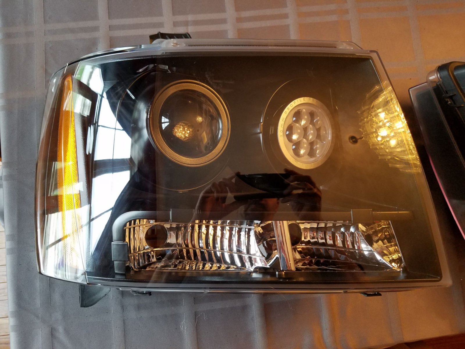

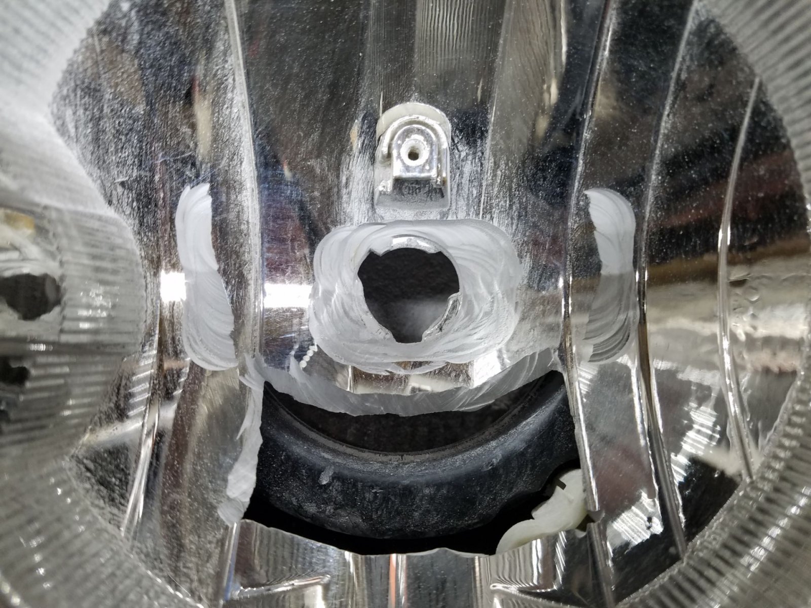

The main issue I encountered in my retro is that these projectors are relatively long, and require a good bit of cutting in order to make them fit behind the headlamp lens. I also had to remove the wiring bracket to make room to move the projector back:
I then had to cut into the reflector to make room for the projector bracket and cooling fan:
Not too bad though. I went with the all black approach (except for the DRL/Turn reflectors I would need):
Wired:
Assembled:

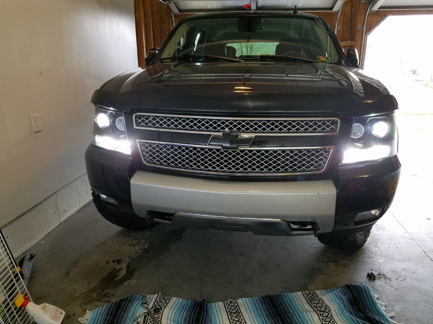

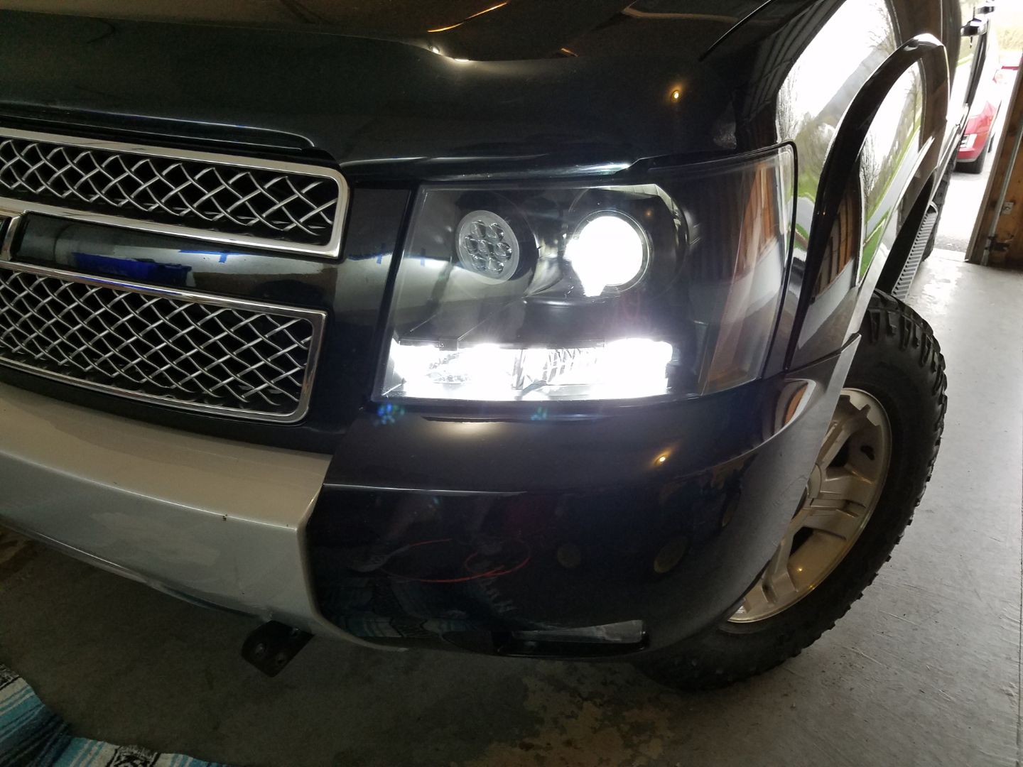

Now the install - this was a pain because the only way to aim the damn things is on the truck...then remove them to modify, then re-install to check aim, then remove to modify...repeat 11 times.
Done:

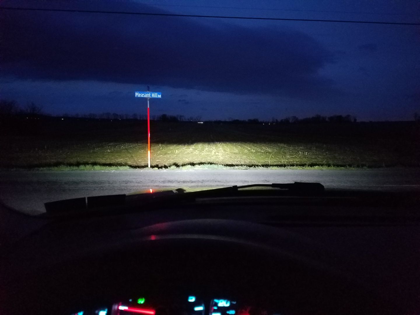

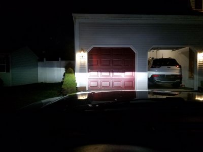

Results - the cutoff pic is terrible because I don't have a place where I can get 24ft from a clean wall and be completely level...so this is it...you'll just have to trust me that they're level:
Low beam:
High beam:
Outside:
I had to get a bit creative with aiming. Trucks are tricky because you have to strike a useable balance between low enough to not annihilate oncoming drivers and high enough to actually be able to see. There's a very small window in which you can have enough length of light but still be below the eyes of Corvette drivers while on level road. I ended up aiming my right side projector a little higher than the left to gain some distance. It's worked out great in the end though.
As for the products themselves, theses things are FRIKIN BRIGHT. I could actually live with them being a little less bright. In doing my research I kept seeing complaints about LED being not bright enough so I was concerned but eventually I realized that these were HID nerds whos standards for "bright enough" were more like "pavement-melting" than "brighter-than-stock" which was all I was looking for. These LEDs are not as bright as the Mini H1 Bi-xenon projectors but make no mistake, they're still many times brighter than stock.
