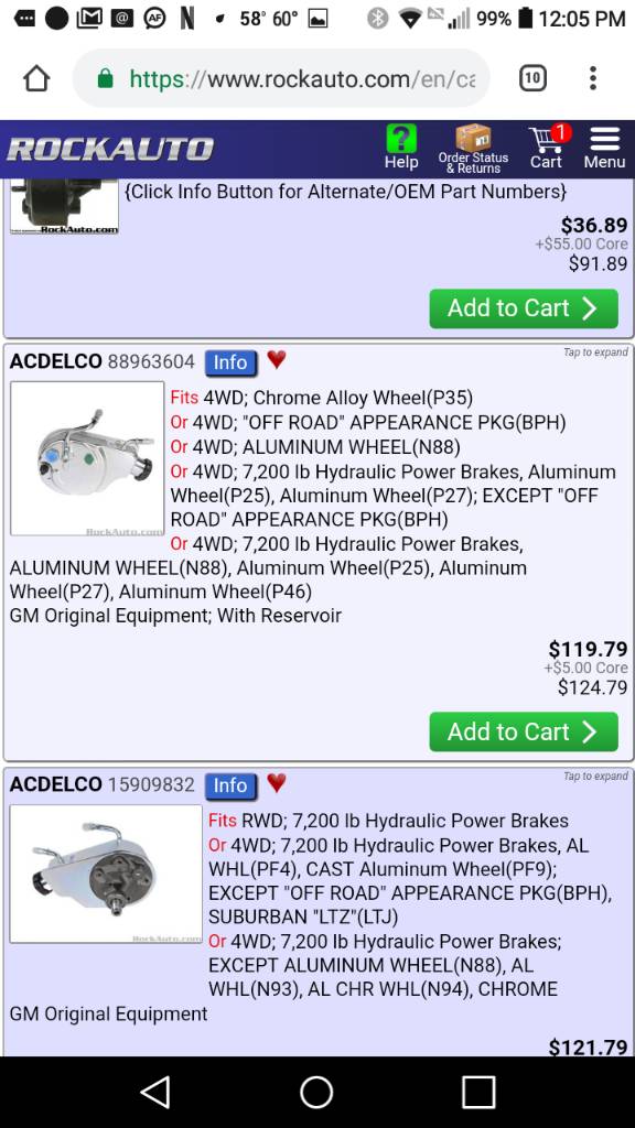

I have a steering gear box leaking out the seal by the pitmen arm .. I put new seals in and started leaking again . How can I tell if I have the right power steering pump . As looks like it might have been changed by previous owner. If I look in Rock Auto it's ac Delco silver pump I have a Black pump .
I'm wondering if owner before me changed it with none hydro boost pump. Any info be great.

Then whats difference in power steering pump between a Yukon with hydroboost and vacuum brake boost ? In Rock Auto there $50 more with hydro boost.
Sent from my LG-H900 using Tapatalk
Not really sure it's a "then" question
Could you provide the part numbers you're looking at?

Here's the right one I have the 4x4 7200 lb and rim P27 but without BPH

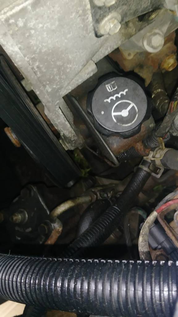

Here's the steering, hydroboost pump. It's black is others with hydroboost brakes have a black pump ? 2006 Yukon XL ?
