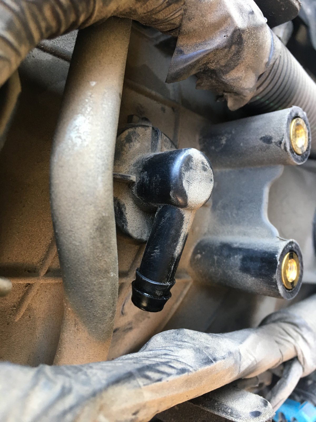

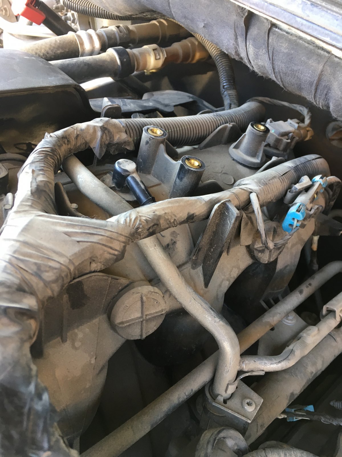

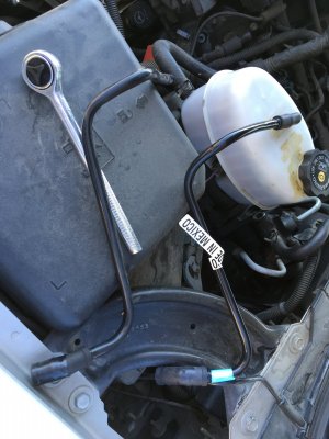

so I know on the older NBS trucks there’s a vacuum hose going to the top of the valve cover and that’s where the PCV valve is that can be replaced. However my 2006 just has a little plastic piece of piping from the top of the black back over to the valve cover. I replaced it today because the plastic piece connecting it to valve cover was cracked. However I’m confused as to where the actual valve is itself. @HiHoeSilver , the PCV you pulled up on rock auto for my year truck is nowhere to be found. Here’s a pic of the old and new piping:
This is where the piping connects at the top side above the coil packs on the top of the engine block. Could this black piece have the valve inside it: F1BB090C-95B8-4A38-B2A4-EC31D73BC0BF.jpeg 5B20488A-59C4-49F8-802A-3870EE214F86.jpeg

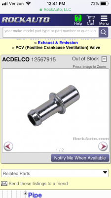

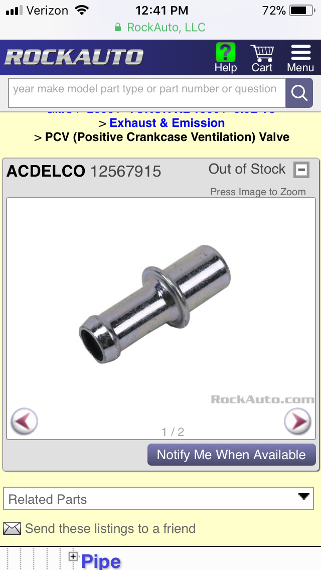

Anyone else got any ideas? This is what rockauto lists for my truck so it’s gotta be somewhere... lol: 3D8C8E2F-DD29-45B5-87D5-AE061DB03130.png
And for the record this last piece^ did not come attached to the new piping.

I don't remember ever seeing it either when I put my catch can on, but my guess would be what @SnowDrifter said. The other end of that pipe where it comes out of the crankcase.

Rear of drivers side valve cover
So then my guess is that it’s integrated into the valve cover. There’s a spot there where the piping plugs in, on my valve cover that looks different from the valve covers in all the videos I’ve watched on the older trucks.

Can't you rule out a clogged port, then? What did it look like under there?
It was grimy but not terrible. I cleaned it out pretty thoroughly. But wasn’t under the impression then that the PCV was integrated. Lol. Now I have my answer. It’s just weird to me that rock auto lists that valve for my truck given that I don’t think that part would go anywhere on my truck. Haha.
