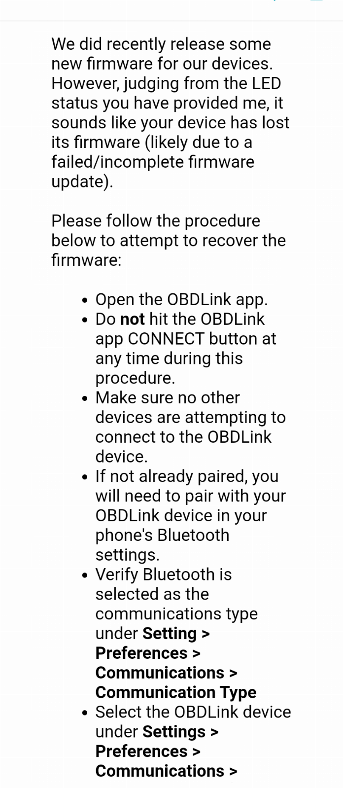

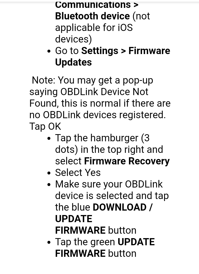

Ok I figured it out on MX Bluetooth . It's the firmware updates that make them stop working .
First turn off all bluetooth on cellphone ..
Power cycle the adapter ( plugin light on and unplug and plug back in ) should have solid green and fast flashing blue .. Turn Bluetooth back on cellphone Then pair to Bluetooth. Then open the obdlink MX app . don't hit connect instead go to settings. Then find firmware update tik and when that open just tick on top right dots. It says firmware recovery. Tap that and follow prompts. Check for updates and then download and In stall. Makesure battery on cellphone and truck charged good .
Because takes bit to do and it tells ya keey needs to be on to update firmware..
And make sure you have latest app.. it updated here just yesterday .. My cellphone has Android 9.0 .. There might be more info on there website just search firmware recovery .. Mine showed me in the reports that air bag code was B0100 .. Remember my yukon xl is 2006 but has 2007 electronics stock it's just how they did them ..

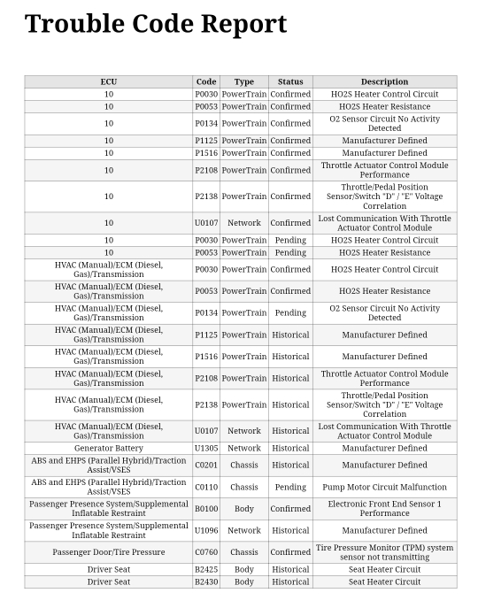

I got p,u,b,c codes .. Pretty scary when you can see them all .. I'm hoping good ground fix some of them .. lol..

Look at this code nightmare.. I'm hopping cleaning ground cables make some go away . lol

Actually I cleaned the ground cables under the drivers door today and that cleared some of my electrical problems right away. Problem is they were rusted bad. My stereo died last fall, just today I heard the sweet sound of music from my Yukon today. Plus seems it fixed a few other things. Still have the odd problem but it makes it one less possibility. Oh when you clean those grounds under the driver's door the guy said to put undercoating on them so they don't rust again.

I would be surprized if it didn't clear a bunch of those. My battery ground was at the front by the driving light. The two under the drivers door and the one I didn't get yet is the end by the engine block. The top firewall connection was easy. Had to use a dremell and it was great. Used a blue stone.
