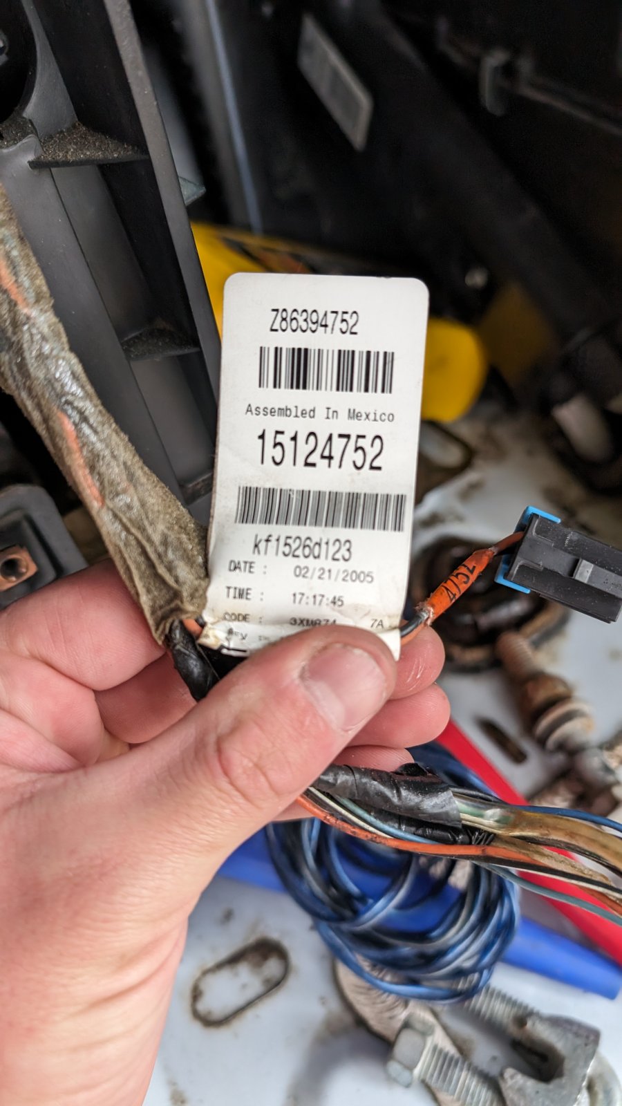

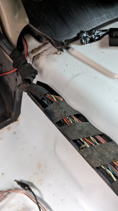

Thanks for those links,
We gutted the interior to find replace the carpet with vinyl flooring and ran across what may be a lot of our issues.
I appears that his dad cut into this harness,
(pictured the harness from the dash, as well as the connector that it plugs into under the console, the blue one)
And I think this might be the cause of some of his A/C issues too.
Just wondering if you know if this Part number tag on the console side is the part # for the harness coming from the dash.
I'm gonna attempt to find a pin out diagram for the black connector to repair the chopped harness there.
Thanks again for all your help!
