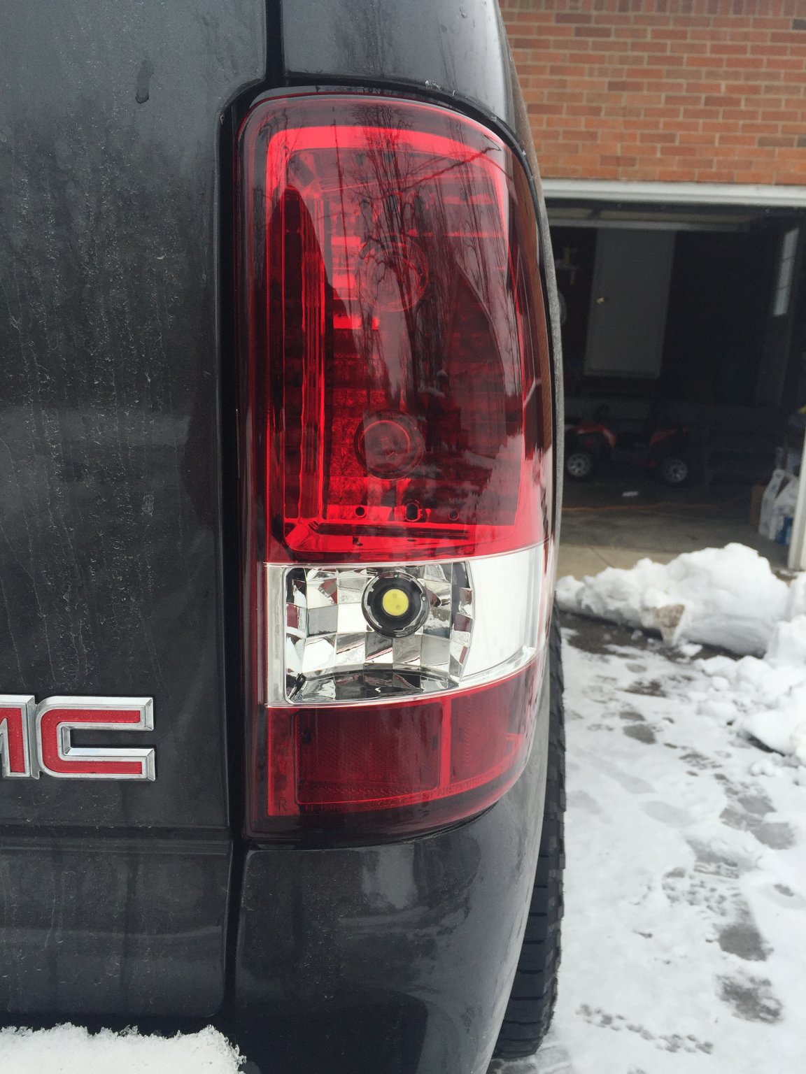

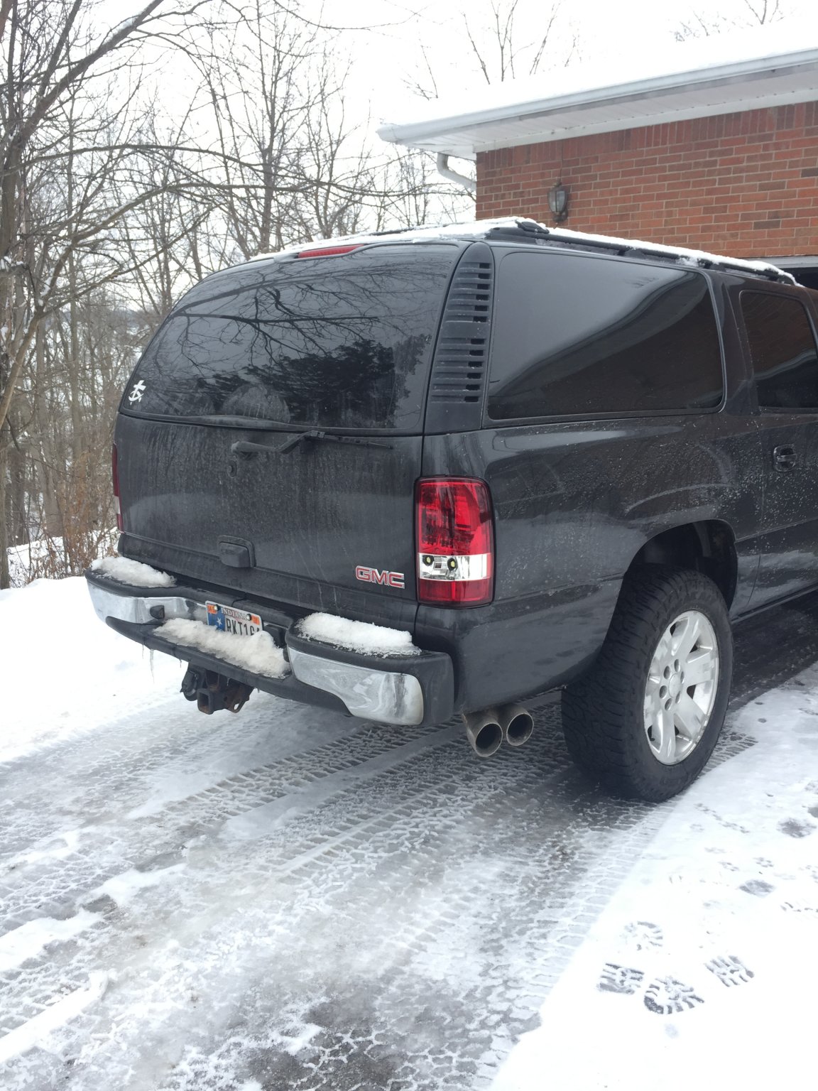

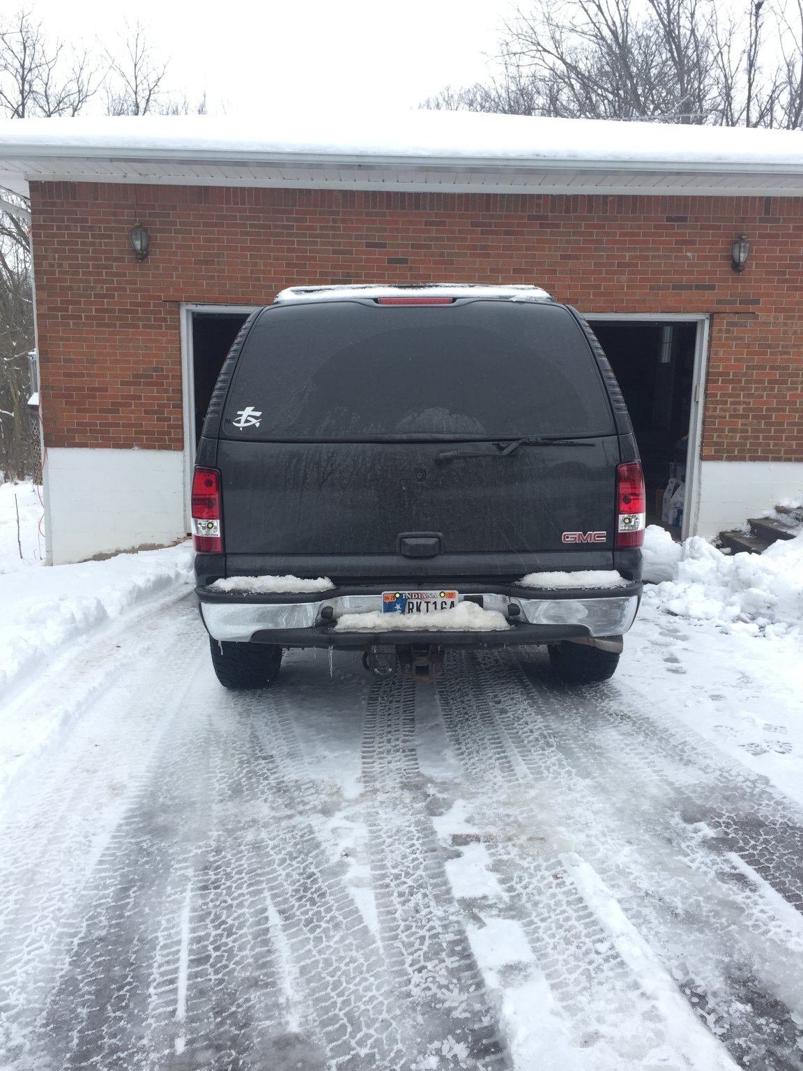

New taillights!

Looking good. Cleanest part of your truck in this picture. :)
What LED reverse lights are those?
Agreed :( Hate this time of year for that exact reason, can't keep anything clean. LED reverse lights are Eagle Eye brand off of eBay. Copied @05Single and how he did it. Pretty simple if you have a drimel and a little time. Have less tha $10 in the entire reverse light set up.

Thought those looked like the 05Single Eagle Eyes. I bet they are super bright too. Nice work. Be cool to see some night shots when you get a chance, just to see the output of those lights.

I'll have to get some. Should be better than the stock lights being that they are clear.

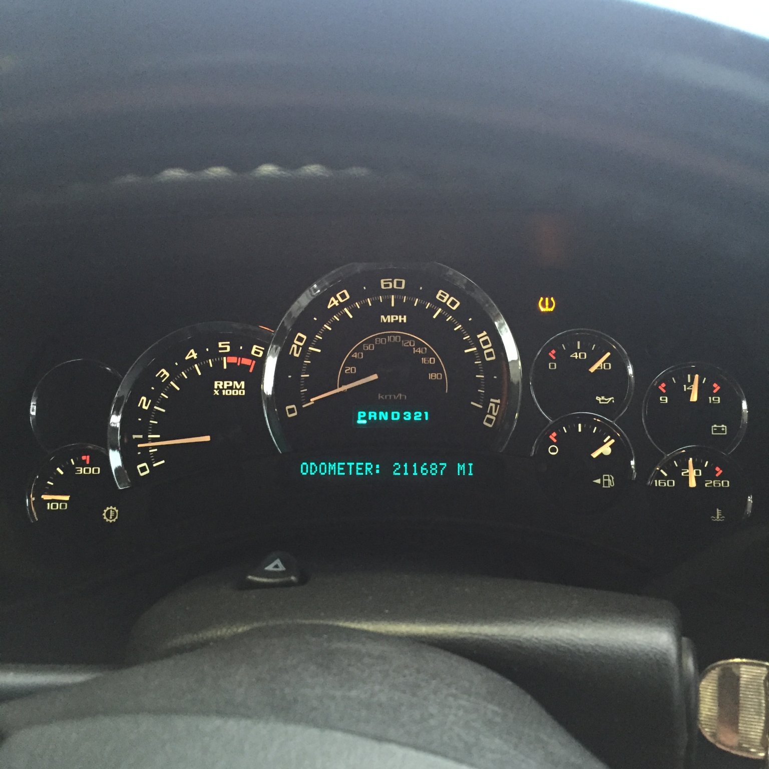

Made it a whole 987 miles before my oil pressure gauge crapped out on the reman cluster. Going to call doorman on Monday to see what they're going to do…

Ah man that sux. Hopefully they get you straightened out quickly..
Looks like your gas guage is broken too, mine never reads like that :think:
Yea I think the stock fluted lens diminishes the led directional output. Interested in seeing night shots too.

Are you sure it is the cluster? One of the ways that an oil pressure sensor failure can show is the 80+ reading when the ignition is in the "run" position with both the engine off or running. I had to swap the one in my '05 Yukon out this summer.

Any updates on the instrument cluster?
Not yet, have called and left a message. Going to try again after work.
Didn't think about that... I'll look into it.
