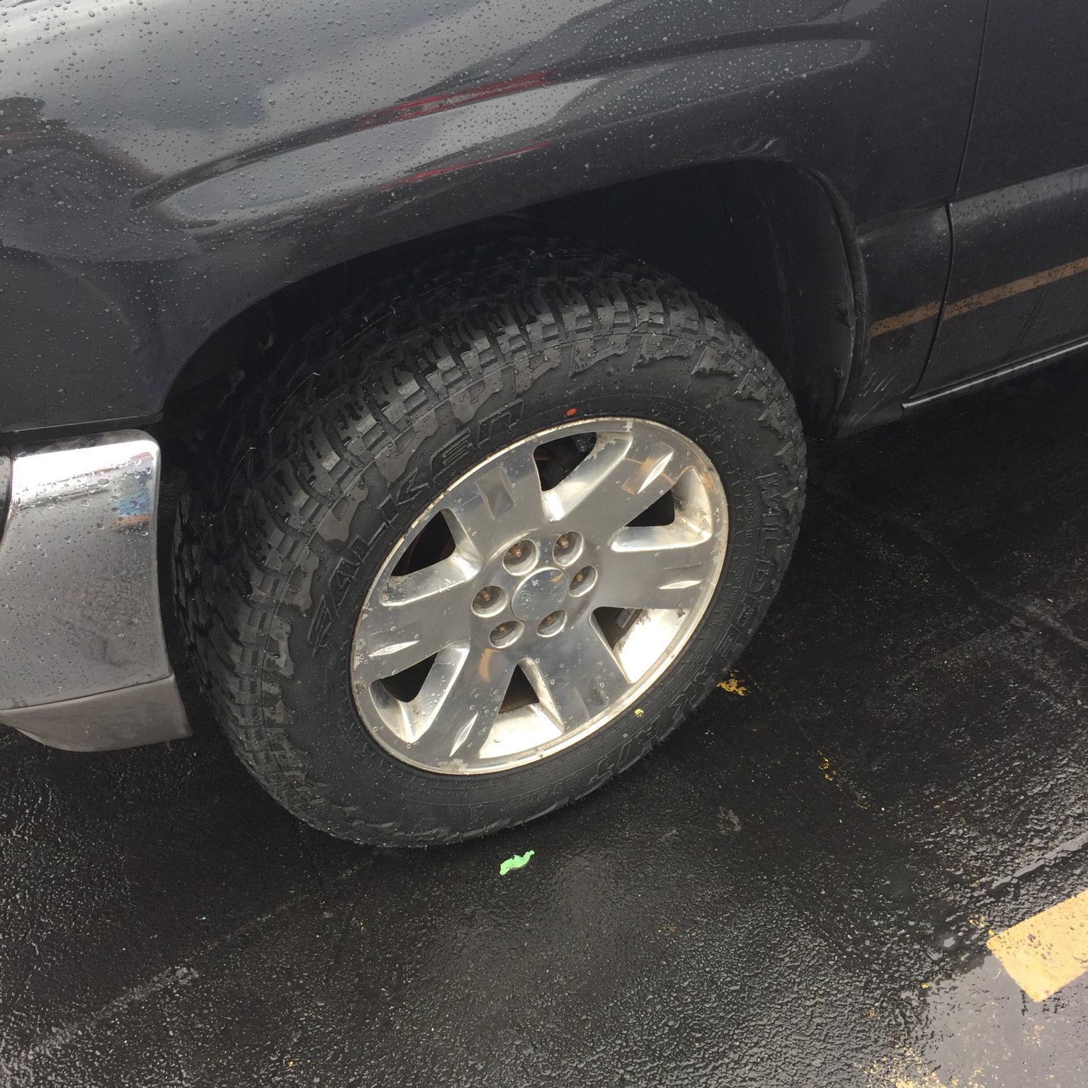

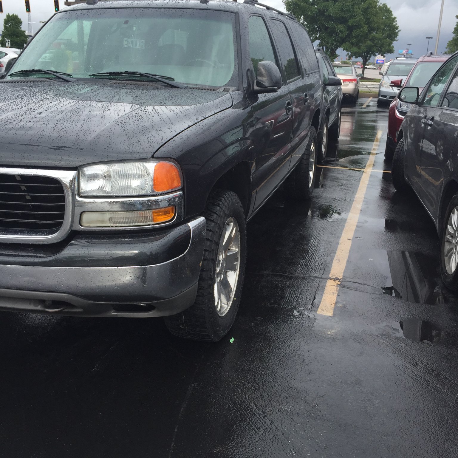

Thank you! I'm running 275/60/20 Coopers right now, but they are toast. Bought a set of the new Falken AT3 though in the same size and should be on Saturday.
As far as suspension goes, I'm running eBay keys in front, stock coil springs in the rear with 1.5" eBay spacers, and 1.5" wheel spacers on all 4 corners.

Nope, not necessary. 1.5" still doesn't push them out as far as most aftermarket wheels, I just like the look of OEM wheels with a little offset. No issues so far in the 15,000 miles they have been on.

Waiting at Discount Tire for our new Falken AT3's
Yukon looks goofy without the spacers

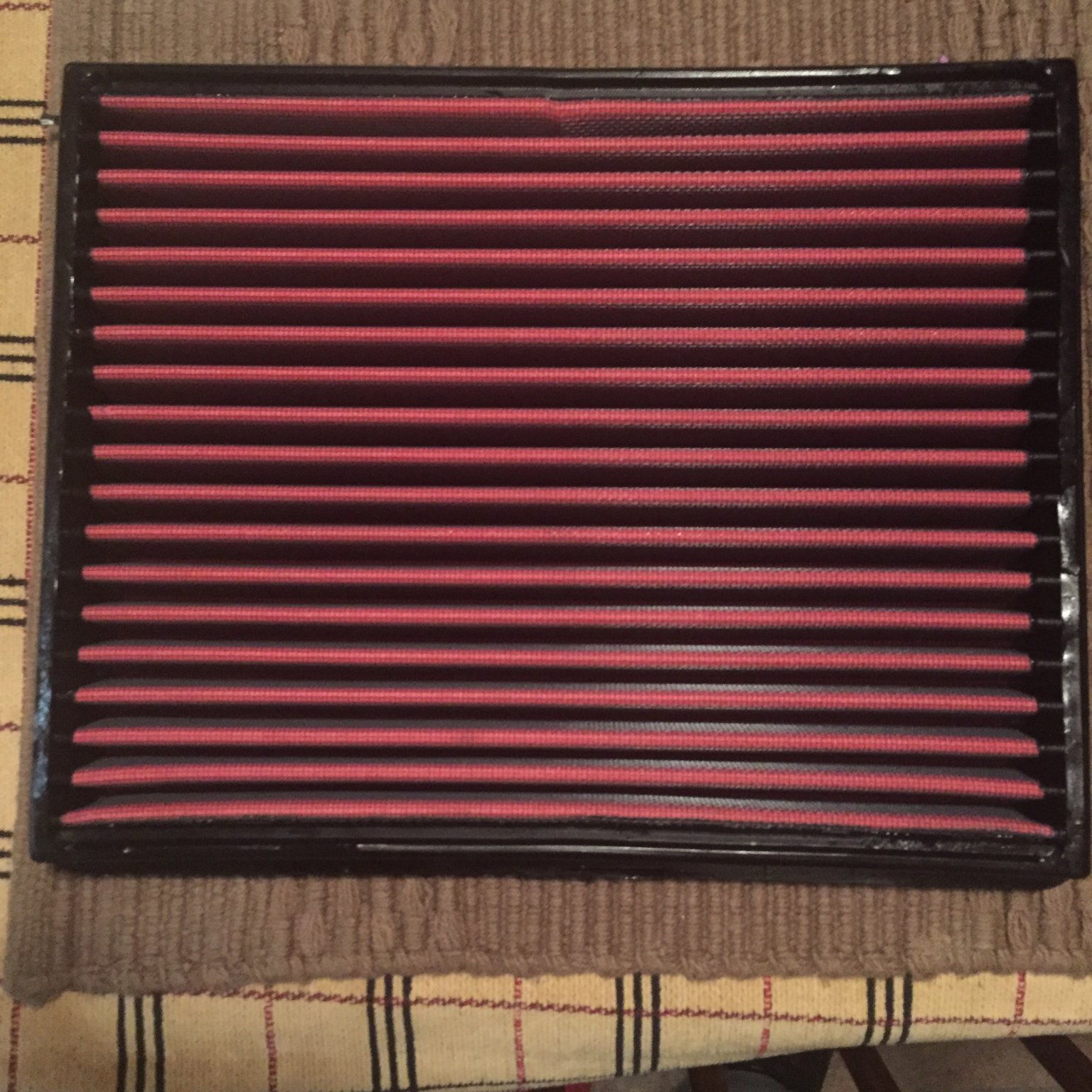

Threw in an Airaid 851-135 dry air filter tonight to complement the MIT I put on a couple months ago. Can definitely hear more air flow!

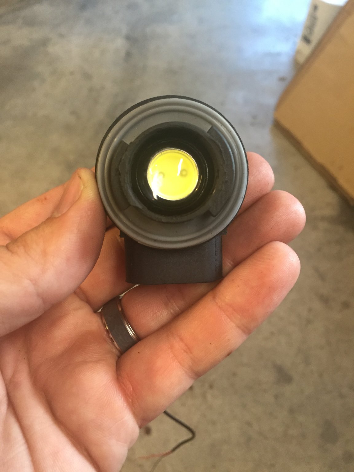

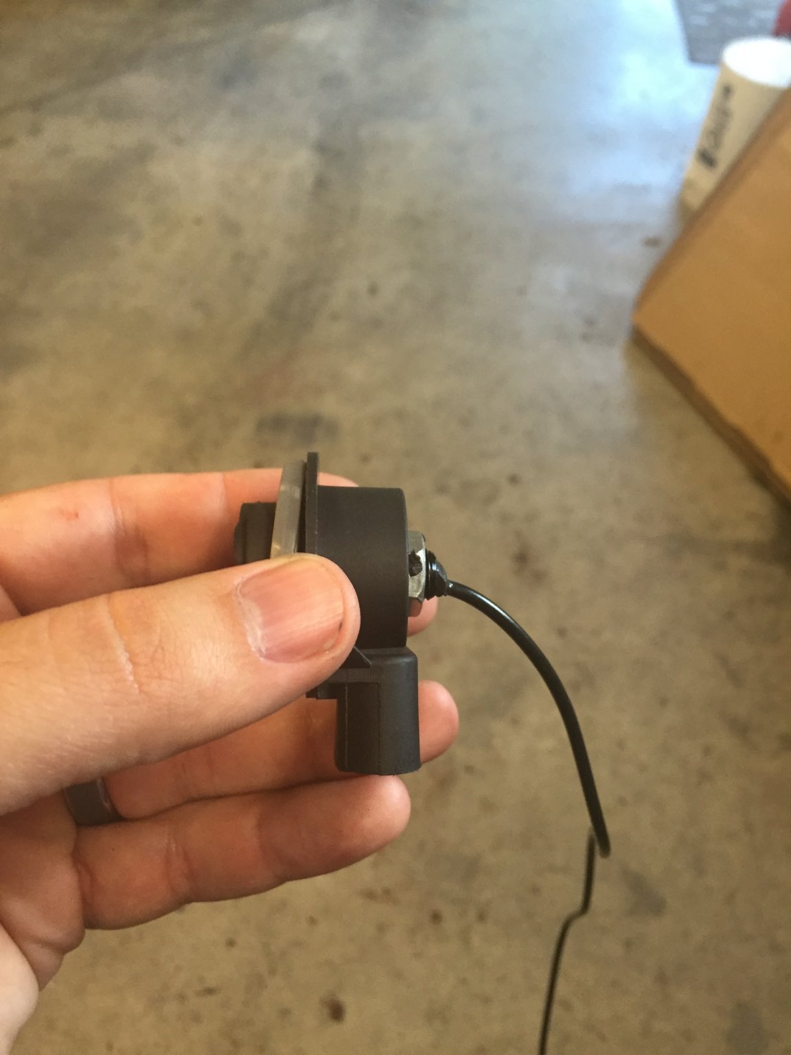

I copied @05Single... Don't recall if he had a write up on his page or not. It's super simple though;
1. Buy these: http://www.ebay.com/itm/2-x-White-D...-Black-Case-/141607722158?hash=item20f87a5cae
Will need quantity of 2 if you are wanting to do all 4 lights. 2 lights come with each order.
2. Buy these: https://www.amazon.com/gp/aw/d/B00D...F8&qid=1475177166&sr=1&pi=AC_SX236_SY340_QL65
3. Wait for parts to arrive
4. Gut 3157 sockets until your left with just the socket itself, no wiring. Drill a hole in the center of the socket for the bolt on the light to pass through.
5. Bust out your drimel with a tiny cut off wheel and go to town. You'll need to trim inside of the socket so the light can sit down inside it and the bolt protrude out the back. I didn't take pictures, but it's pretty simple to figure out once you get going.
6. Test fit the light to be sure it all fits.
7. Modify the locking tabs on the 3175 plug to fit your stock taillights.
8. Cut your stock reverse light plug off and wire the LED's.
9. Enjoy
