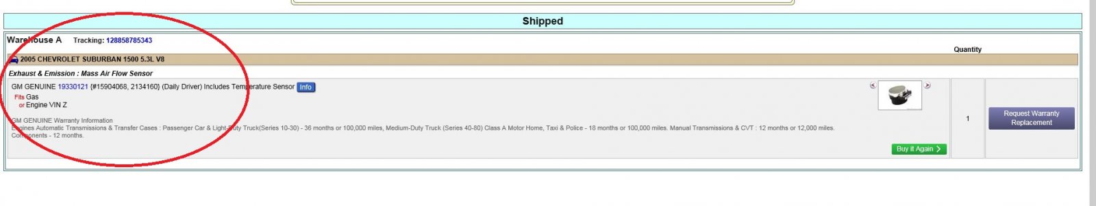

if you throw on another MAF be sure it is the right one, I replaced the one on the wifes 05 i bought her last year when I was doing some maintenance when we first bought it and it hiccuped on me like a dam bucking bronco, I knew right right away what it was. hasn't done it once since.

if you throw a another MAF be sure it is the right one, I replaced the one on the wifes 05 i bought her last year when I was doing some maintenance when we first bought it and it hiccuped on me like a dam bucking bronco, I knew right right away what it was. hasn't done it once since.
Was it the GM maf that hiccupped?
It was the transmission that hiccuped due to the maf giving erratic data, had it happen before on a 04 and 03 and a 00 the 04 took a while to figure out thought maybe the transmission was taking a shit it would do really weird stuff like you would be driving say 50mph, give it some gas and it would act like it was slipping and downshift into 2nd or 3rd then back to 4th and then if you just babied it then it would just keep on cruising normal. then other times it would drive just fine, after a while it FINALLY threw a maf code once. replaced the maf and it shifted perfectly afterwards and kept on working perfectly. On my 03 it would keep on throwing a lean code and other's I knew what it was because I had a modified performance maf and if you did not keep it clean constantly it would throw codes finally got tired of it and put a oem one back on and walla codes gone, on my 00 it would bogg down like it had no power you could be doing 50 punch the pedal and get nothing no power at all, no downshift nothing gutless...bad maf...
all those things led me to figuring out they start taking a shit at about 160k, on the 05 it was 154k (close enough).
