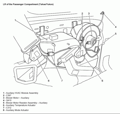

So There is no HVAC control module on my 05 rear blower motor just a blue connection right where the HVAC module would be on most rear unit's I have seen. No plugs that would connect to it so does that tell anybody what is different about mine I

as far as I know they all have one, let's see some photo's and how long has the problem existed? has it been like that since you owned it?

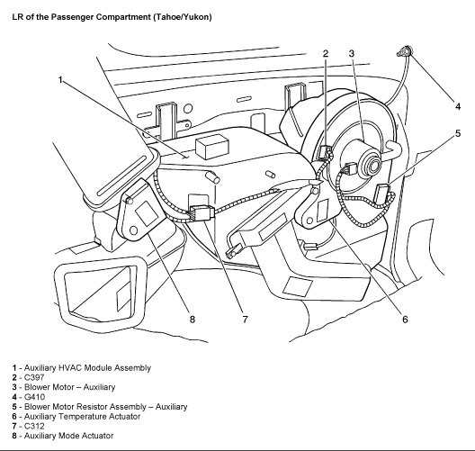

Its all back together now but here is a schematic of the way mine is. I believe that it's my blower motor so I can replace that or take to the dealership and let them figure it out .....I tried

So I replaced the actuator, the resistor, the blower motor, the overhead control, all the fuses are good but it only runs on number 2 . I have the HVAC control module but mine is a bit different then most I see it's not mounted on the outside of the blower unit, mine looks exactly like the schematic I show in my last post.........Guess it's going to the chevy dealership . I'm sure it will be something simple throwing parts at something is not the way I usually roll but got a little sucked into this one ...
