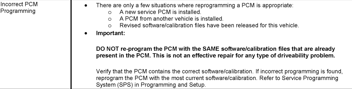

I don't know if this applies to your situation or not.
Maybe swap the coil packs out and see if that helps anything, if you are having consistent misfires listed on your scanner.
