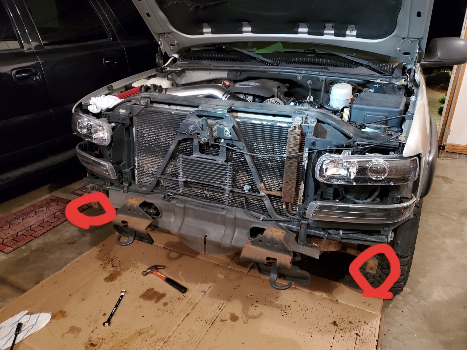

been thinking about buying a Ranch Hand bumper forreeevverr, like since my first Tahoe in 2016
but didn't like the $1200 price tag and couldn't find any used
FINALLY found something similar today. it was a 20 minute old post when I saw it
just 2 bolts and some welds holding it on, so we were in and out of the dude's garage within 30 minutes or so
tomorrow we'll try bolting her up and see if it fits :)

after many hours of swearing, grinding bolts, WD40-ing rusted out crap, etc we were able to come very close to mounting it up
the OEM bumper came off easy enough
4 18MM bolts was all that held it on there
however, the new bumper required a lot more clearance
we're hoping to have it up and running tomorrow

4 18mm bolts plus the 2 side bolts ?
mine only had 4 18mm bolts total, nothing else. I'll get pics the next time I have the OEM bumper
Mine are all 15s. Four in front, then the side brackets.
ALL of the videos I watched showed 15mm, but we made damn sure, and mine were definitely 18mm
I think mine were 15s too. But I was making sure he had bolts on this side bracket too :eek:
no bolts on the side brackets that I'm aware of
anyways, between Saturday night and Sunday night, 3 of us (myself, my dad, and a college roommate) probably spent 13 hours or so on this dang thing
nothing was fitting right. tons of grinding, beating with hammers, messing up stuff, etc
we finally got it to mount up
but there's absolutely no way to fit the other set of headlights (DRLs, turn signals, etc), or the OEM grille
so it's back to the drawing board tonight
I spent Monday and Tuesday in New York for work so I couldn't get any progress on it, but tonight we're going to try to make out own brackets to drop the bumper 2", and then weld it in place

we have the bumper kinda jerry rigged in place now
we're going to attempt to cut up that 1999 s10 blazer rear shackle that we had lying around, and use that to drop the bumper 2" from the OEM holes, so that the grille and lights will fit
