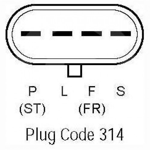

in case anyone is wondering how I'm charging higher than the normal 14.4v - 14.8v that our alternators are generally regulated for, I added a Chanzon 1N4004 Rectified Diode to my alternator
I should've taken some pictures, but was just trying to get it playing and forgot to do so :(
here's a short style explanation and some pics from Hunter Martin
order yourself some diodes:
and then on these alternators you want the diode in line with the S plug
add the diode in line as seen:
grey line towards the alternator plug
shrink wrap it, add a zip tie for rigidity, etc, and you're ready to roll

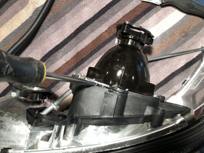

I also got all of my retrofit stuff in today, so I started that project
Amazon Depo projectors
CB&D Brackets
MoriMoto Mini H1 7.0 bixenon HID
38w nhk ballasts
XB 4500k bulbs
if the Yukon retrofits were 6/10 difficulty, these chevy ones were probably 8/10 difficulty
didn't even get around to testing them yet, because its downpouring out and I don't have garage space to pull the truck in, but I already know I'm going to have to rebuild these.
the guides I read made it seem so easy, but there were a lot of intricacies that were not mentioned
for one, the quality on these Depo headlights was much better than the eBay ones, including the fact that no matter how long I heated them, the damn silicone would not come off. ended up breaking off a bunch of the plastic housing in frustration
hopefully tomorrow I'll some output shots of juts how bad these are

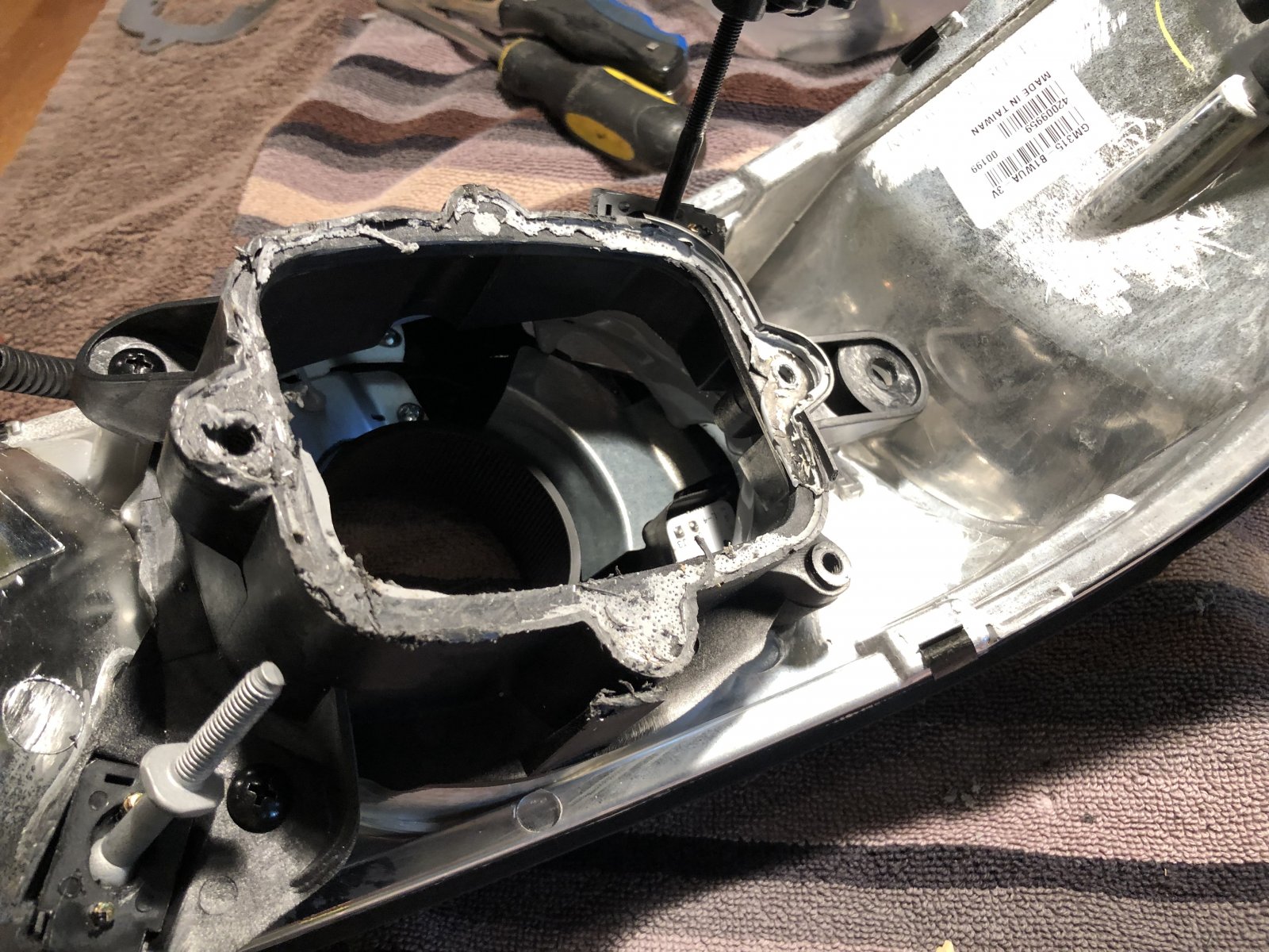

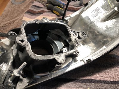

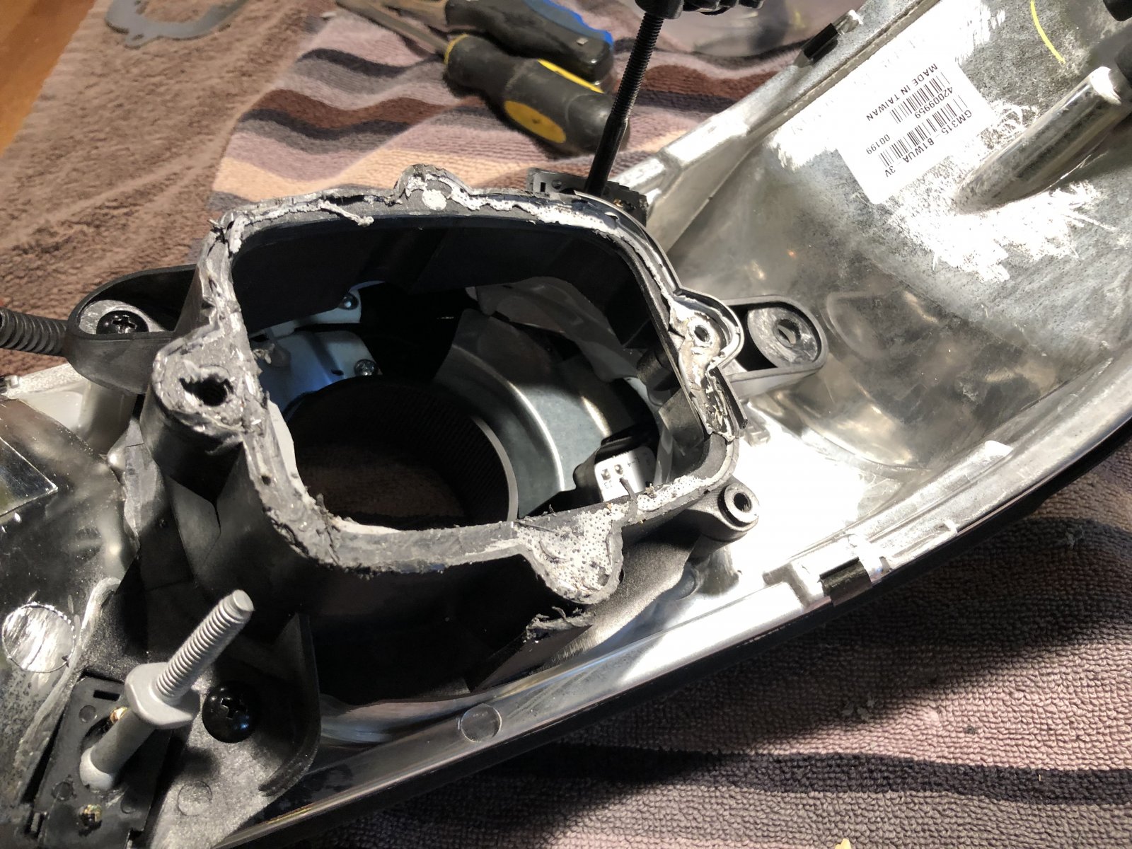

It’s not silicone, it’s called permaseal. Look it up. Were you trying to open them up or just remove projectors? I’m not familiar with the Depo for Tahoe’s so idk if you can just replace the projectors like my Denali’s. Mine were permaseal and just removing the projectors was super hard. I’d like to open them up to paint them but I’m pretty sure I’d destroy them.
Galandorian
Galandorian
Jul 24, 2017
450
646
Albany, New York
I thought the Denali ones were permaseal, and this was much different stuff than those were.
I had no issues removing the Denali projectors, but a TON of difficulty with these Chevy ones.
I was strictly trying to remove the projectors from the rear, not open the headlights.
52,956

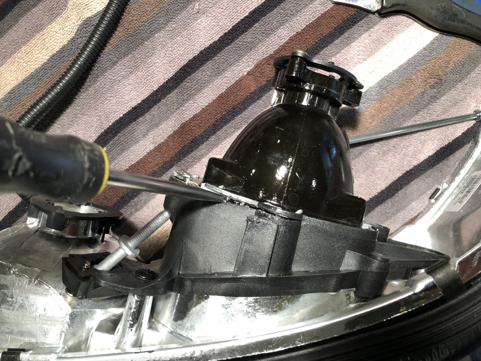

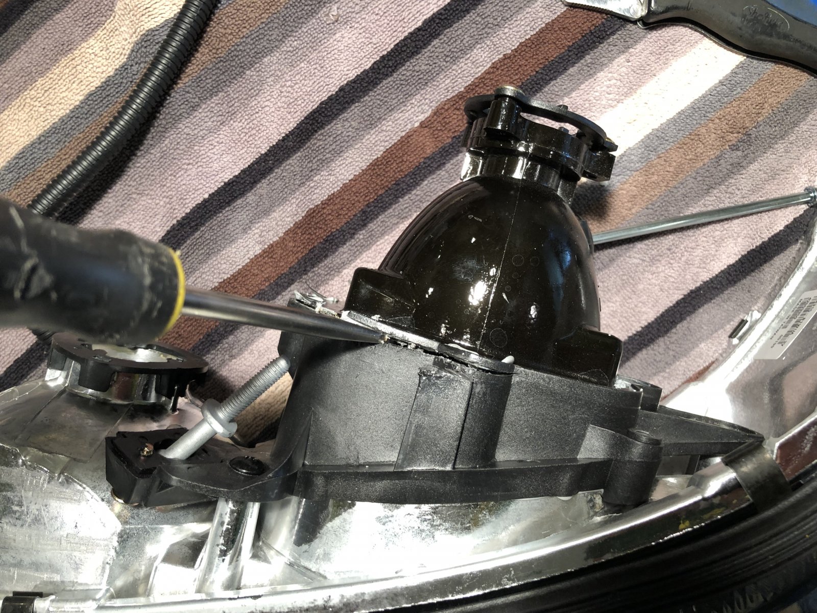

I think you just encountered your first real permaseal. Here's what mine looked like after a LOT of effort to get them off. Lots of heat and cutting and prying, about 2 hours for each projector.
View attachment 231909 View attachment 231910
whatever was on the Denali was not what was on these Chevy ones, and the Denali stuff was much easier
I was able to do those retrofits in about 30 minutes each
