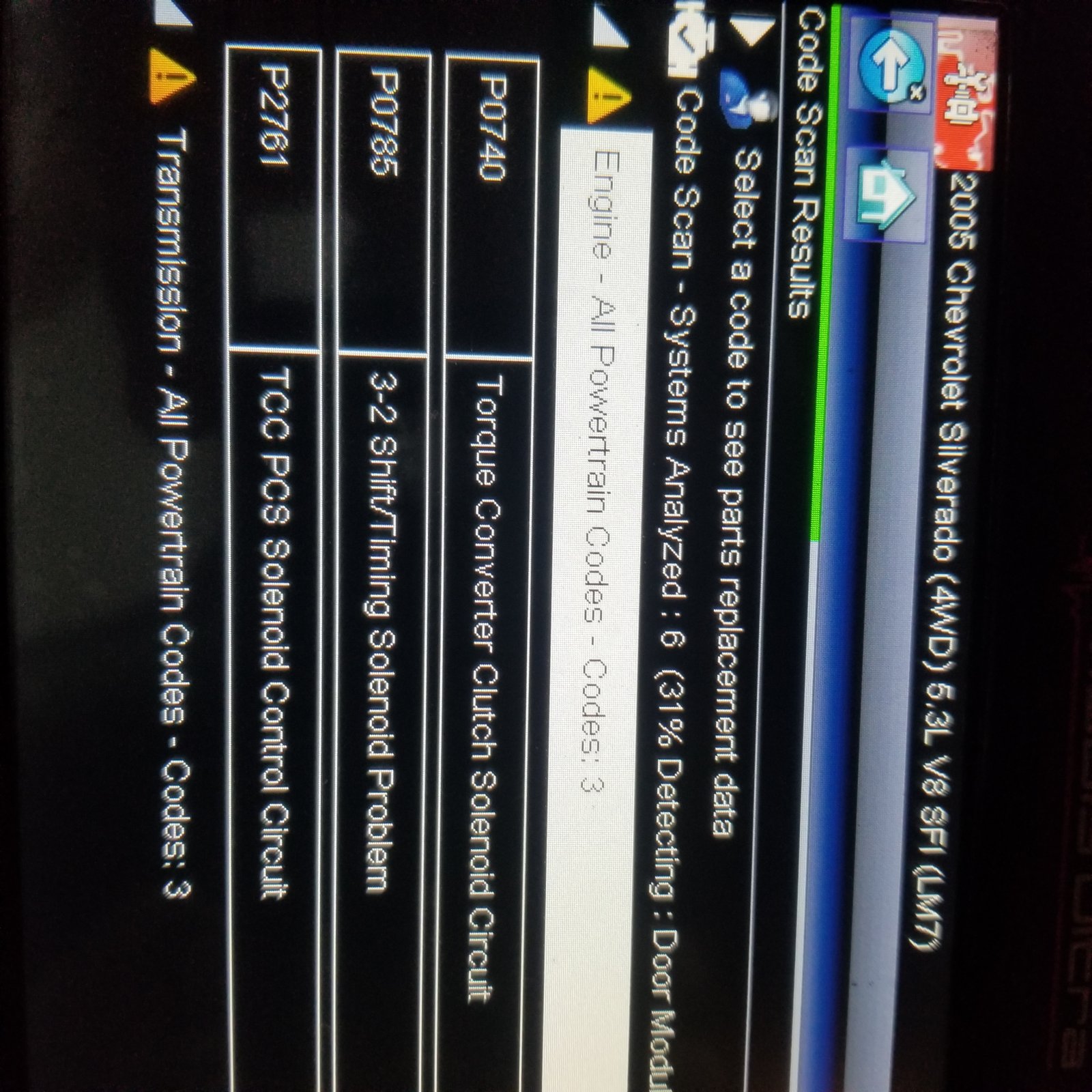

I have an 05 Silverado crew cab 5.3L L460E transmission. I am getting codes, 740,758, & P2761.

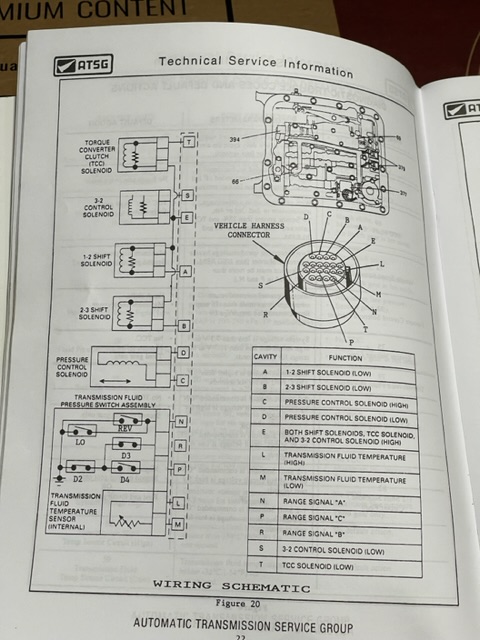

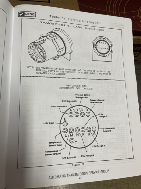

Here's those images, sorry for the delay - it's been a busy day...

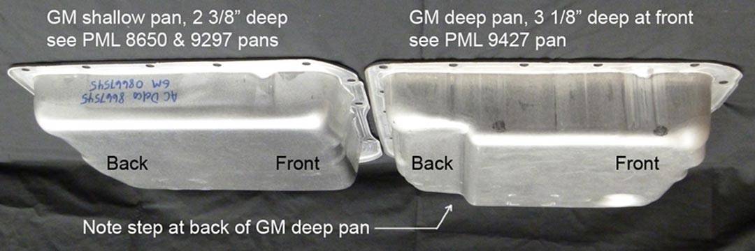

The solenoids just dont fail commonly. But the problem lies in the wiring harness within the tranny. It is constantly bathed in very hot tranny fluid and is cold/hot cycled. The wires and their insulation can get brittle. You may have caused a break in a wire and it just isnt worth the hassle to put a used harness in there. The wire (copper part) can be broken and the outer insulation can be fine. A simple ohmeter check can be made on the harness but id just yank it out and install a new one since yours is probably already baked to death from the tranny fluid heat. Check the old one on the bench to find the exact fault. While you are in there verify the filter is fully engaged into the valve body and make sure you have the correct filter installed. (Deep pan or shallow pan)
