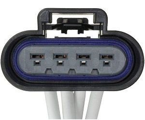

So it's the flat four pin connector, not the square one. I hate that aftermarket connectors don't use color coded wires.
I wouldn't change anything at the cluster unless you can determine if it was swapped there.

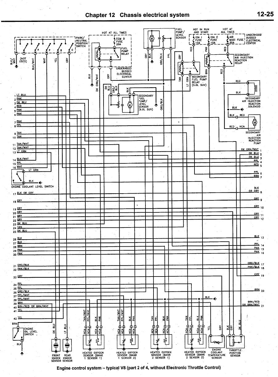

This diagram (also attached as a PDF) is from Haynes and shows the wire colors (if it's correct) at the top center of the page. (Others here may be able to provide better diagrams from AllDataDIY or somewhere else.) From that you can see which wires are which at the pump, but I don't know if the lineup equates to how they're in the connector. Might want to peel back the harness to see if perhaps the connector was replaced and wired incorrectly. You could also verify that the level sensor ground is the orange and black at the wiring harness. In case you're wondering, the level sensor wires go back to different connectors on the PCM.
