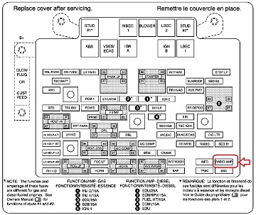

It sounds like the radio has power and the display lights up when you turn it on. True?
Have you checked the separate fuse for the radio amp? It's in the underhood fusebox.

That was one of the first things that I checked and the fuse was good. Replaced it anyways just to be sure.
