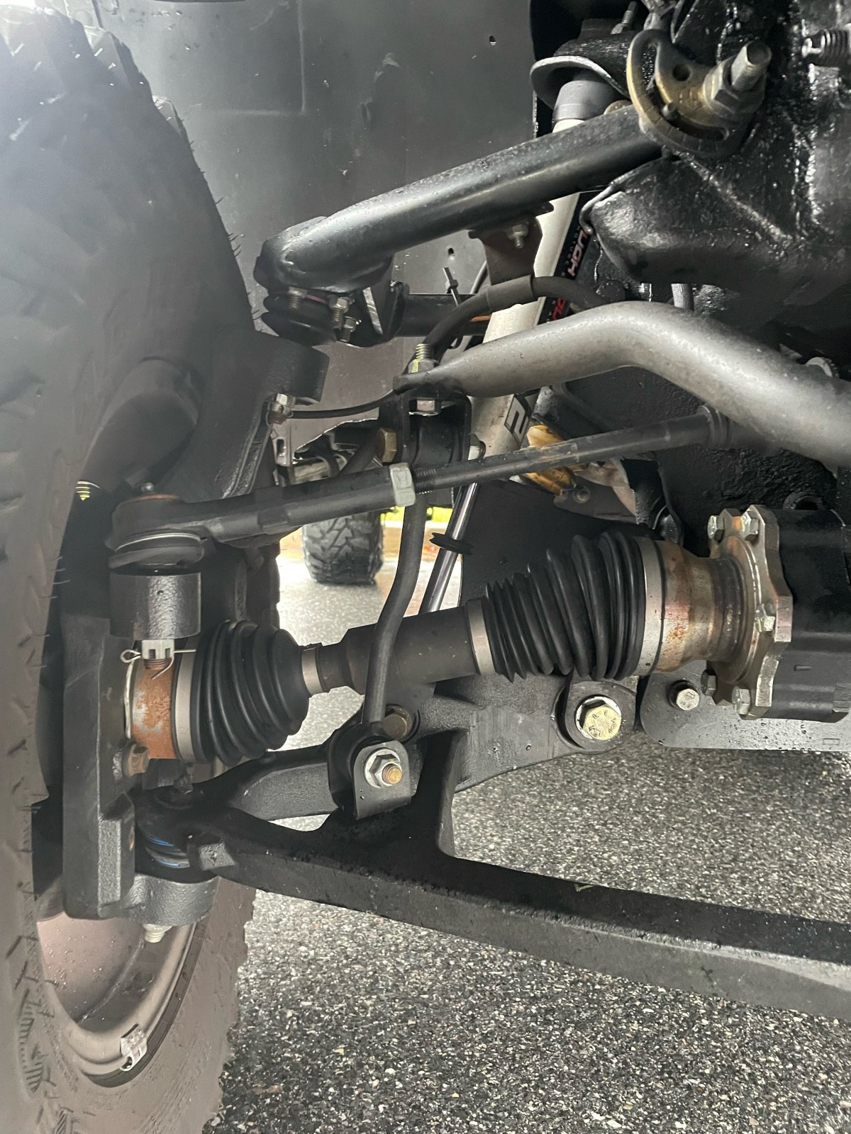

My Tahoe has a 6" Rough Country lift (installed myself Sept'22), Cognito Upper control arms, 33" Yokohama Geolander M/Ts wrapped around 17" Pro Comp 69 series wheels. Volant Cold air intake (but it's too loud, I think I'm going to put stock one back on). Extended travel CV axle from NAPA on passenger side (plan to add matching later, already ordered). Magnaflow catback and of course a back up camera!

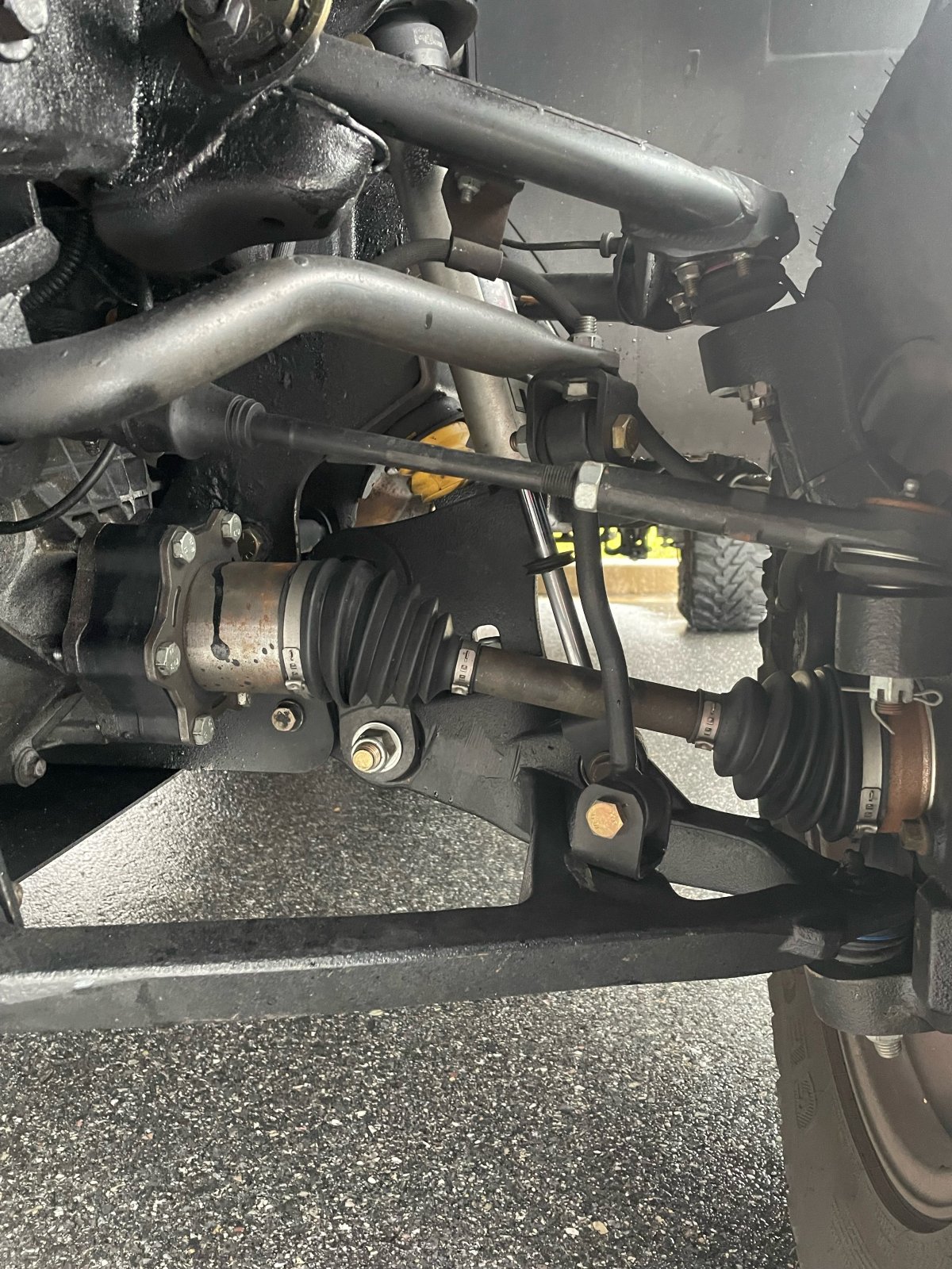

The new Extended Travel CV axles I ordered from NAPA are for the 2008 Tahoe...since they're longer than the 2004 axles I plan to ditch the 2" spacers and get better angles with the longer axles. I saw in another post that it works. Love the NAPA axles that allow max travel!
