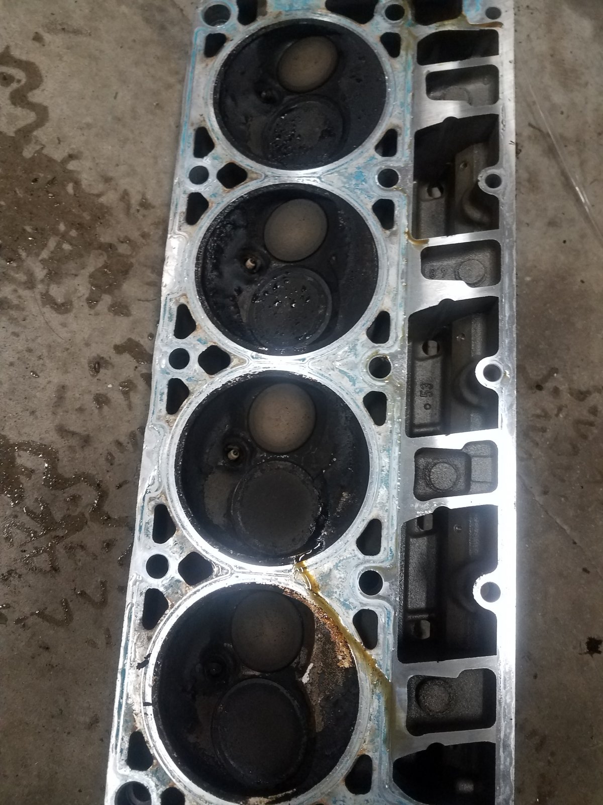

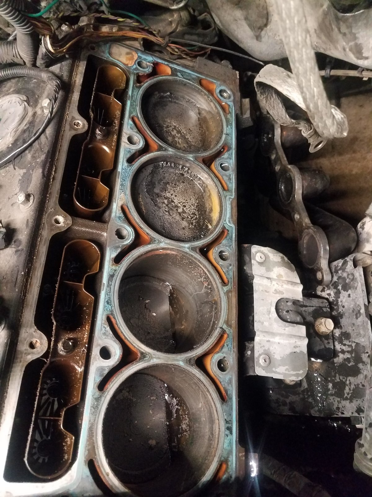

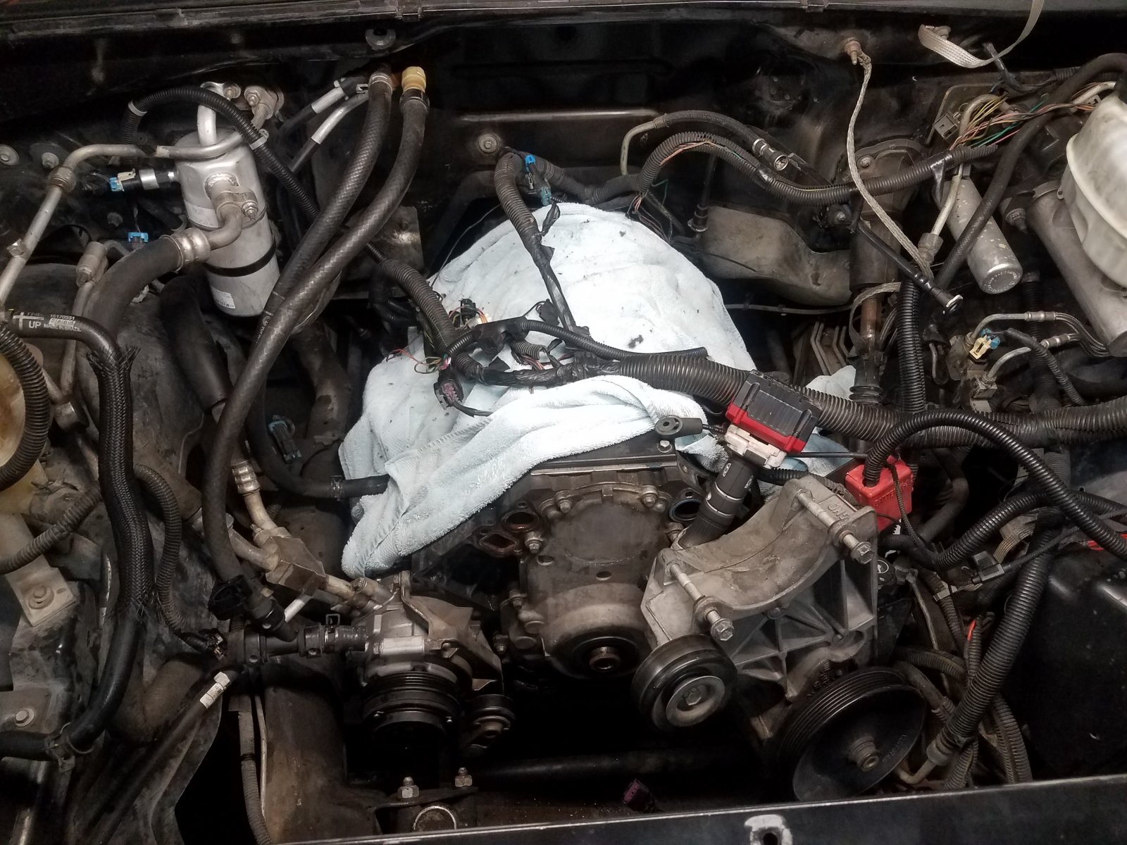

First an update then I'll get to @iamdub awesome response. :happy175:
Machine shop is bumping me to first in line and I might even have the 862s back this weekend. The 224/228 is going in because its here and @randeez and @Rocket Man made me.
I got everything torn down except moving the ac compressor and pulling the front cover. Need to do a garage clean up before I tear anything else down. With any luck this thing will be rolling mid next week.

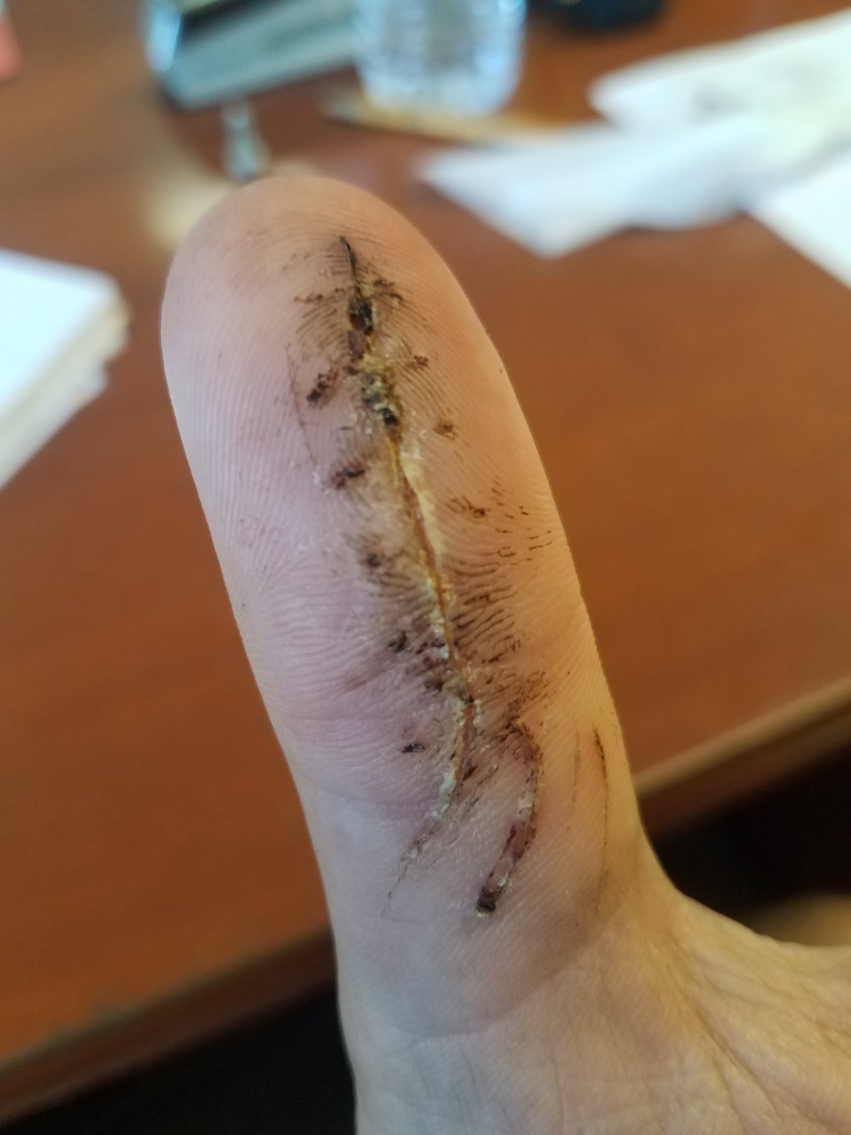

Oh and my thumb is doing good I'm glad the valve waited to drop until the day after the stitches came out.
View attachment 257831 View attachment 257832 View attachment 257833 View attachment 257834
Better wrap that thumb up!
Oh hell I forgot about the thumb so yeah glad that’s healing good. Too bad an engine can’t self heal, that would be awesome.:cool:
Yes mother.
It's honestly been 99.9% painless since the stitches.
Pulled the firewall insulation down and I so badly want to clean the engine bay it's just not possible while it's in my shop.
52,949
Yes mother.
