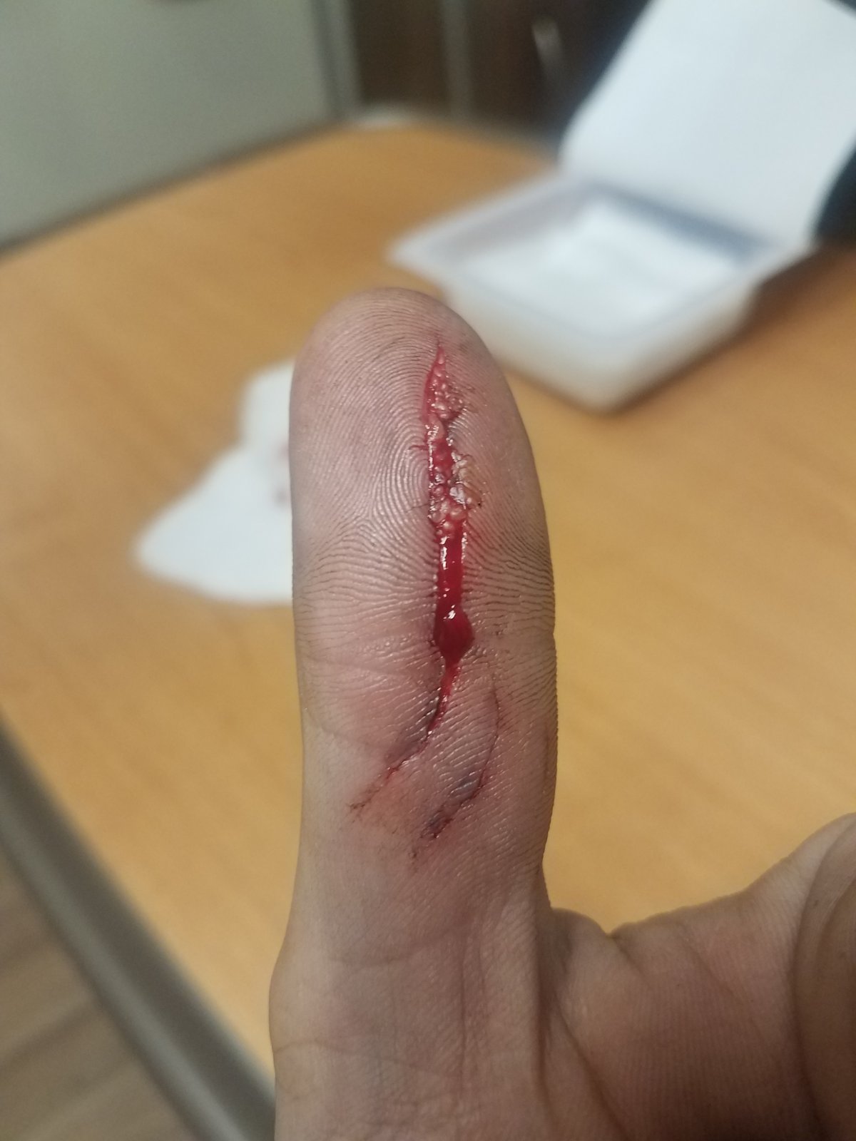

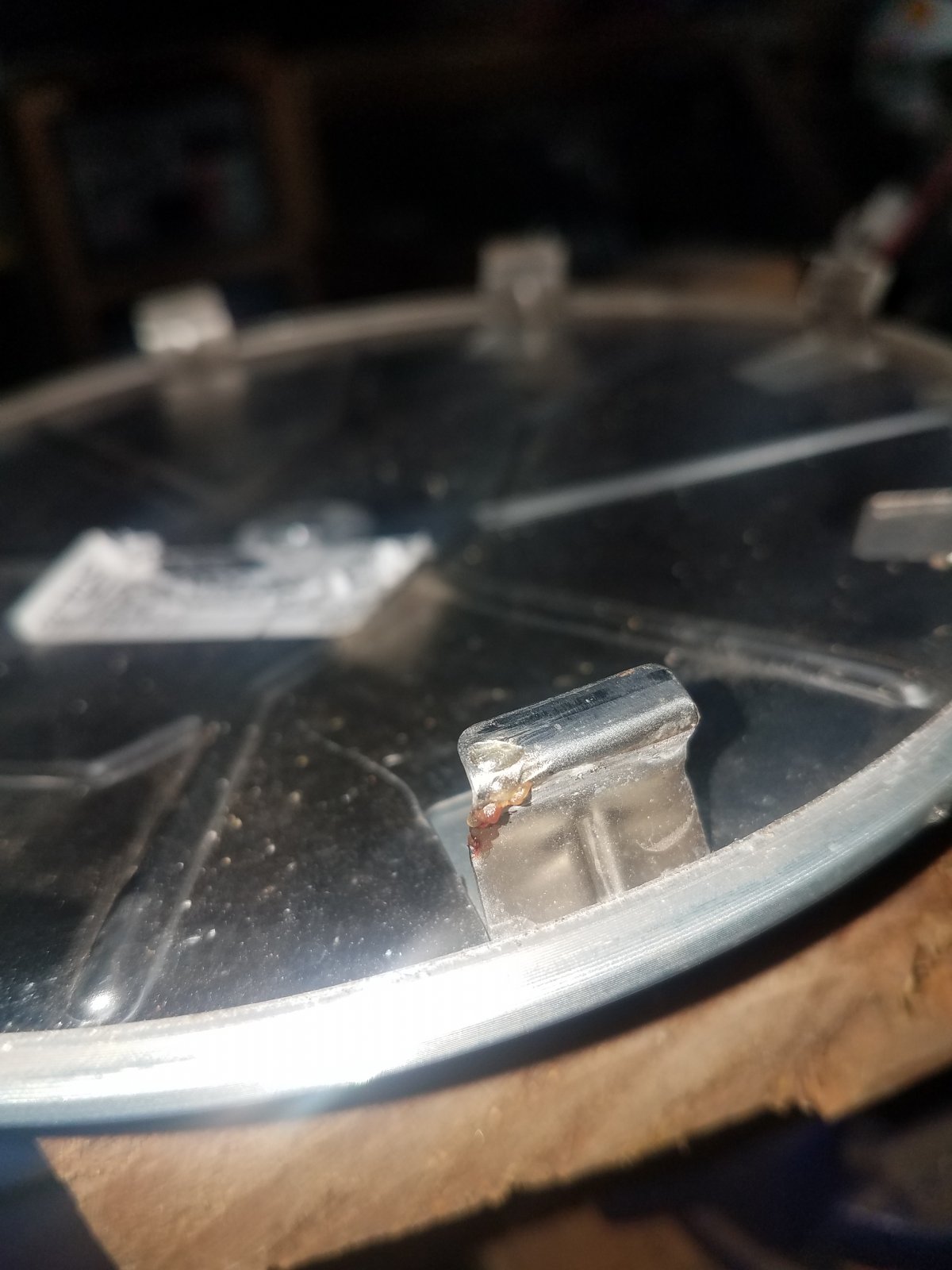

Not sure if booboo pictures are allowed but here is a reminder not to hold onto the thing you are drilling with a 2" hole saw :Stupid Me:

JEEZZUUSS!! That looks painful dammit!!

It's probably not as bad as your shoulder but its certainly not something I hope to do again in the future. The last picture is a bit of meat stuck to the center cap I was drilling. Ended up with 6 stitches and an appointment to go to a joint specialist they think I might be missing some tendon.

Damn Dan! I hope everything turns out ok. What happens if you did damage the tendon? Internal stitches? Reattachment?

I have no idea I think it's fine I can move it, it just hurts when I do. It will be fine it's my left hand luckily, I would be devastated if it happened to Palmilla Handerson. More ticked off I won't be able to do many projects for a week or so. I will finish drilling the hole when I get home!

Thanks compadre, hope the shoulder is doing good. Tore mine 6 years ago and although its 99% better every once in a while I do something that makes an ouchy lol.
Thx buddy--it's coming along--slowly but surely. Keep that digit wrapped up! I hate when I hurt my hands or fingers--especially a right side one. I'm righty also.

I really think it's going to be fine but better safe than sorry. I typically wear some Tig welding gloves anytime I drill, cut or grind anything but my current pair blew out a finger just before this incident and I threw them in the trash vowing to pick up a new set on my way home the next day. They likely would have saved me completely and for just $7 at China Freight.
