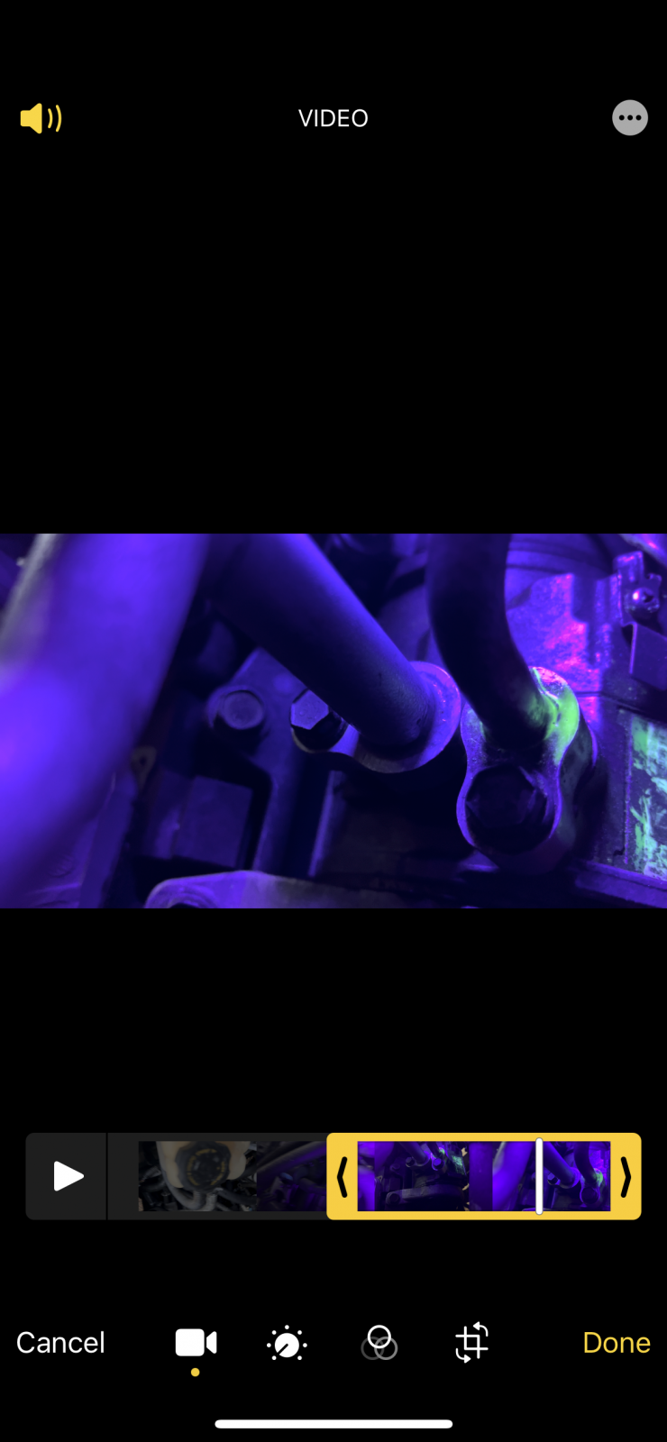

Found the problem I think, I spent a ton of time cleaning every speck of UV dye off everything on the entire truck. Previously I had a line from my shit HF gauge set bust and spray dye everywhere! Anyway I cleaned it all spotlessly and waited for nighttime to attack if with the UV light. Even in the shop with the lights off it’s a tad too bright to get as good of an inspection done.
Anyway I found that the lower line connected to the compressor was leaking right before my eyes! So I’m going to replace it today and hopefully put this saga behind me.
