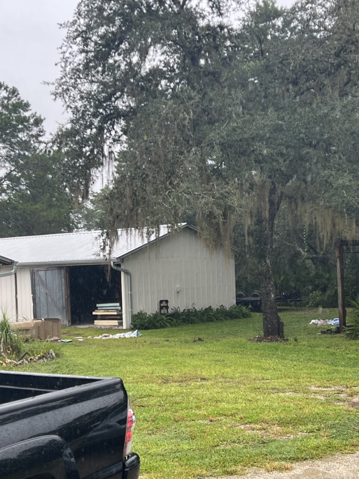

It’s just raining, I contemplated going for a jog but then saw my FP arrived so I’ve been messing with that.
Super pissed, I’m getting 12v to the connector, good ground, 5v reference, and the feedback wire to the fuel sender but the pump is not kicking on. Not sure what to do at this point, the pump is a clearly brand new Bosch unit and looks super nice.
