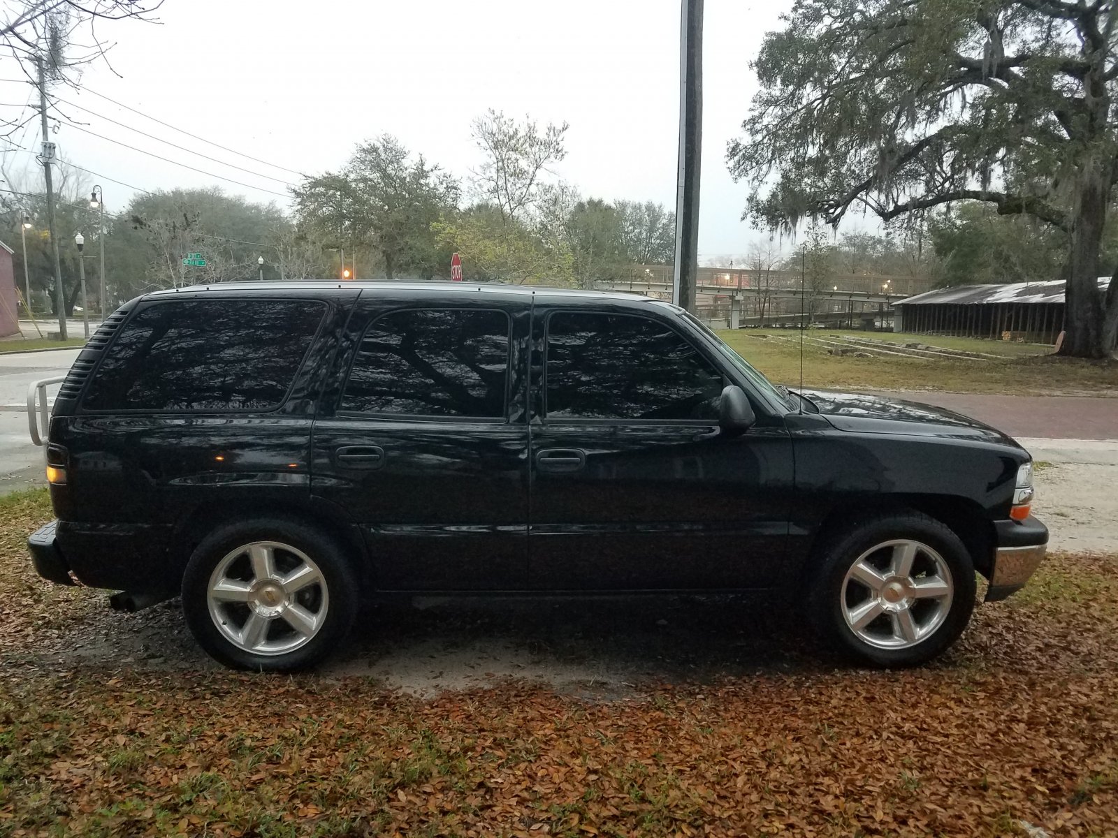

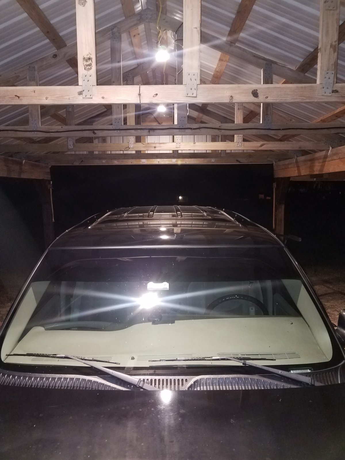

Well got bored tonight messing with clutch master cylinders and decided to delete the roof rack. It's easier than I thought and I put RTV on the threads when I put the bolts back in. Going to look for another option to make the bolts stick up less but those rivnuts are really the issue. Oh well if I wasn't so tall I wouldn't be able to see them.
These are terrible pics but here you go.
Also does anyone buy roof racks? Or want one? Free if you meet me somewhere in Orlando.

Thanks I really hated the rack just been lazy I guess. Watching the kid try to wax under it Saturday told me it was time to go. Might do a few other minor cosmetic upgrades soon.

Looks great! Black too! My favorite color. Mine is similar, 4x4 at the moment, soon to be 2wd. I have same wheels I think but i painted mine satin black. I like the blackout look, your front window tint looks super dark. How is it to see out of at night? I have noticed my 30% fronts reflect too much everything else inside add I don't think I like it, but the look sometimes outweighs the practicality lol.
I like the removed roof rack. I plan to do the same to mine but just like you, then stupid rivits/nutserts are really the issue. I might have to weld mine up. I have seen the hard plastic bolt hole plugs (GM) but I can't recall exactly where at the moment, they might look more 'flush'?
Your Tahoe a sun roof model? Looks like it in the pic but my phone small to really tell.
You are lucky not to have the stupid little rubber ducky antennae up there as well. Mine has 2. One for factory xm maybe and one for the defunct on-Star. Gonna have to weld those up also.
Looks good! Keep us posted.

The windshield is actually just a 5% AS1 strip nothing over the entire windshield. The AS1 is pretty low and lower than I wanted at first but I like it now.
No sunroof thankfully, I never use them and find they just end up leaking or causing the headliner to sag.
Do you have any pics of yours with the black wheels. I've considered painting mine but I also want to find something lighter weight so idk what ill do. I actually just order 1/4" spacers because the 285s rub a little up front.
