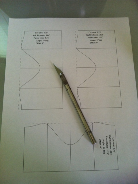

I'd make a cardboard template and use that as a guide then trim to fit so you aren't welding up a big gap.

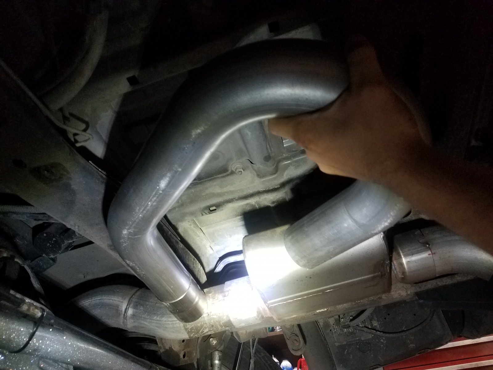

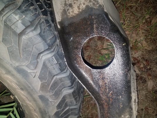

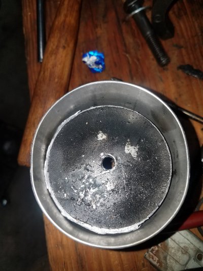

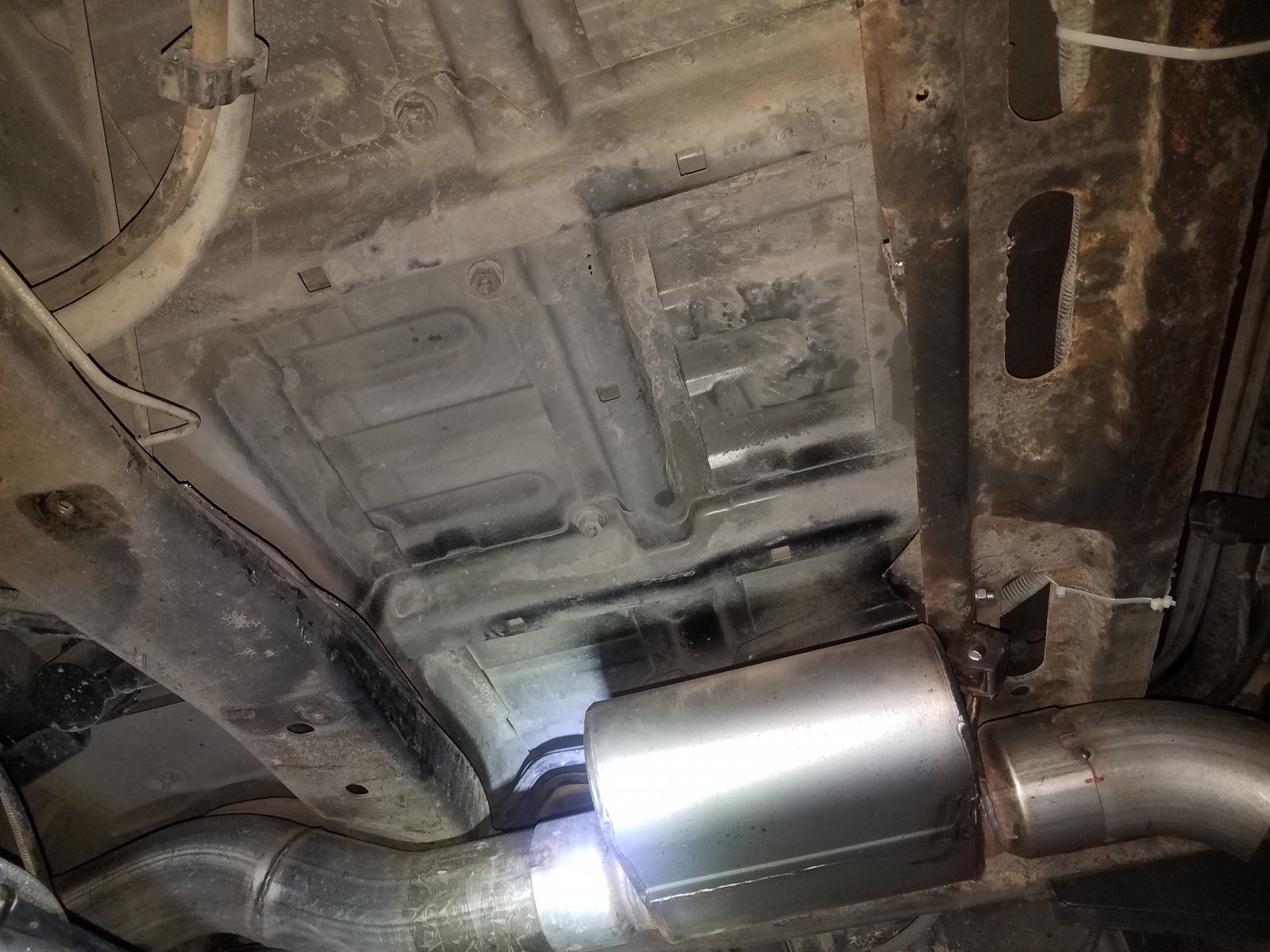

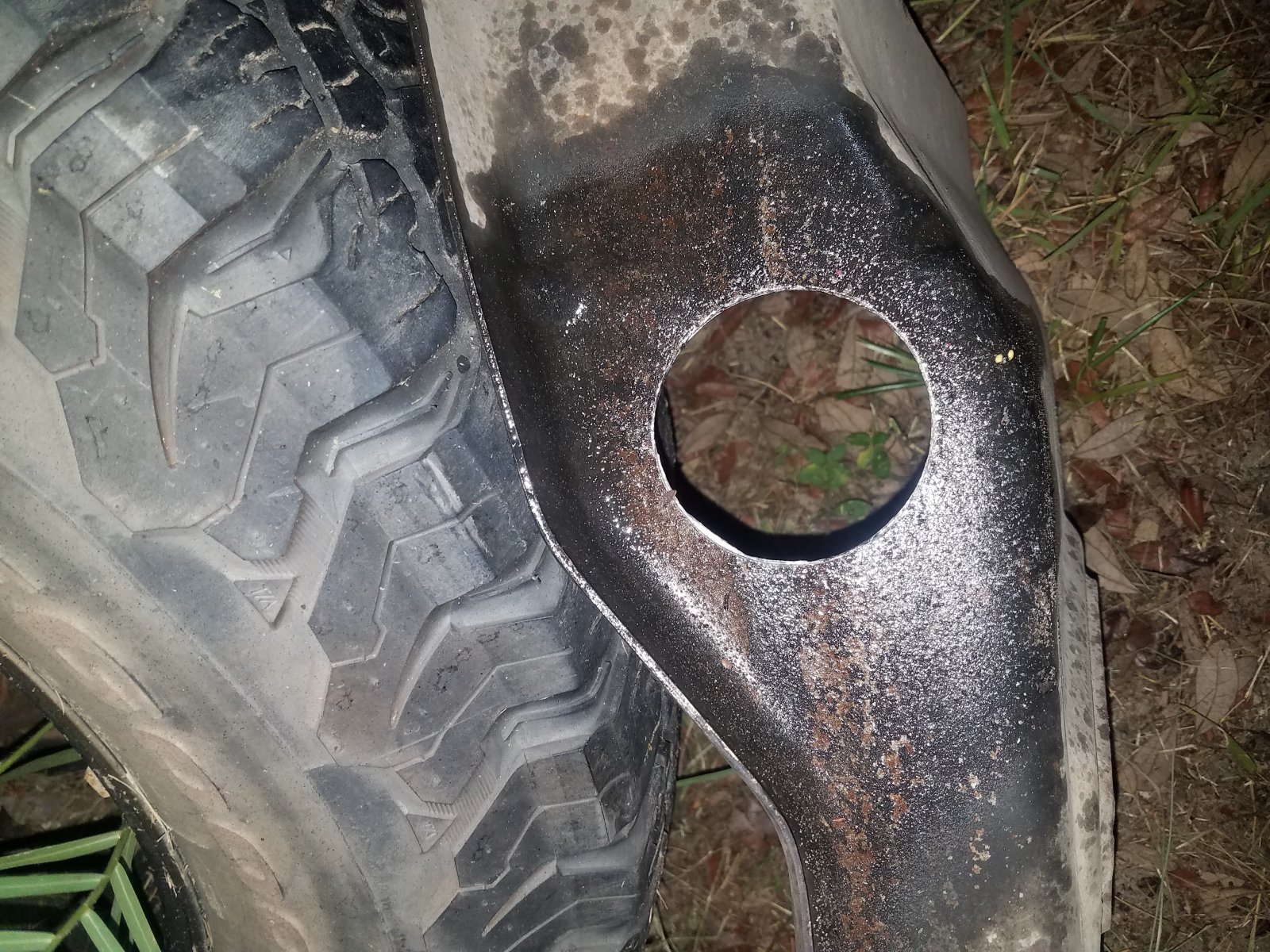

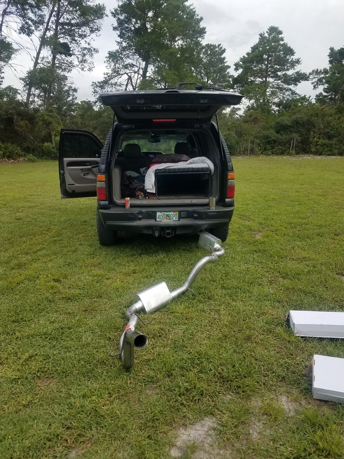

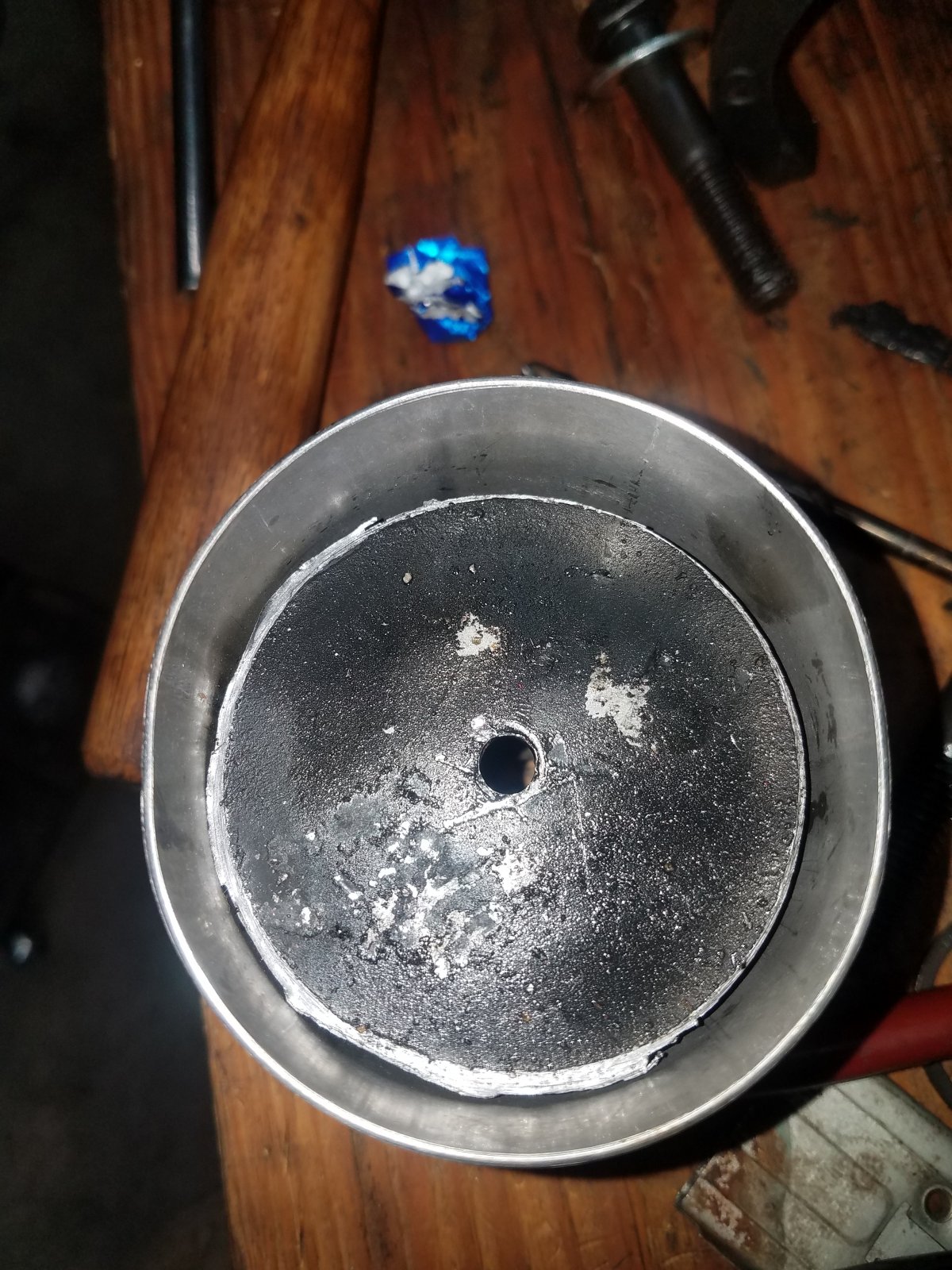

Got some time tonight to play with J pipe location and chopped the remainder of the spare tire bracket out. There's plenty of room now and it will all be way tucked up out of sight. Also ended up using the old bracket to cut the end cap for the j tube since I was having trouble finding any on Amazon.
Lastly my 408 Denali buddy came over and we practiced Bozozuko or whatever it's called with the crazy exhausts lol.

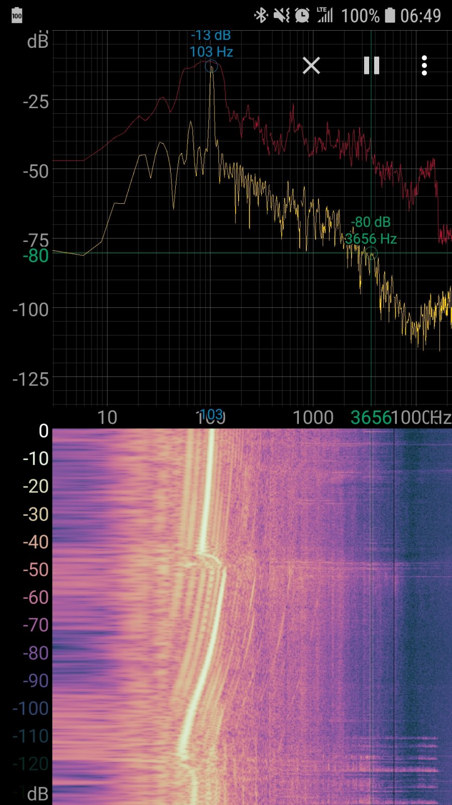

I used that spectroid app the guy in the video suggested and got exactly what his excel spreadsheet guessed, 100hz at 1,500rpm. which means a 42" J tube, it's so odd the drone totally clears up at 1,700-2,050 but at 2,100 it creeps back just not as bad as at 1,500. Hopefully the 42" pipe will help at the higher rpm as well, I do have an idea to make a slip fitting and play with length a tad so that will be fun.
