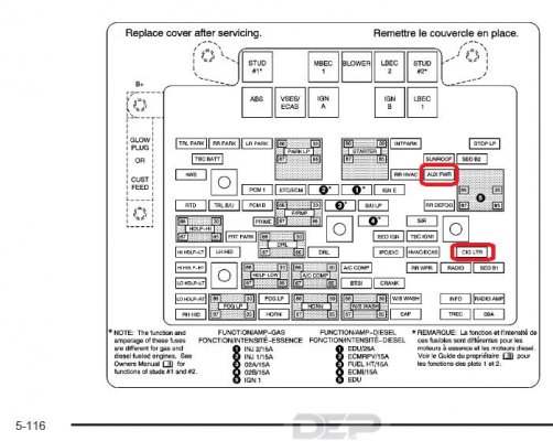

Check for voltage at the power outlet that doesn't work. Fuses for both Cig Lighter and Aux Outlet are in the underhood electrical center.
