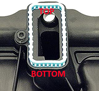

I have read a lot about the Dorman intakes leaking. Are you talking about leaking where the runners meet the heads or at the seam where the intake halves are joined? To remedy any potential leaks at the seam, I completely sealed the joint running around the circumference of the manifold, with plastic welder epoxy. My seams won't be leaking for sure. It could be possible for a poor fit at the heads though, is that what you were referring to?
That's correct the leaks are normally at the runners, I read on another forum that they put a strip of permatex to keep them from leaking. You can check for leaks spraying carburetor cleaner on the runners.
Gotcha. Leaking at the top, bottom, or sides of the interface where the runners meet the heads?
or run a bead all the way around the gasket piece?
