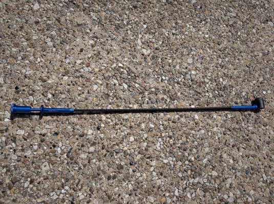

You'd think we were related! I got some claw-like grabber tools and extending magnet wands from my Dad. Those get used a lot!
