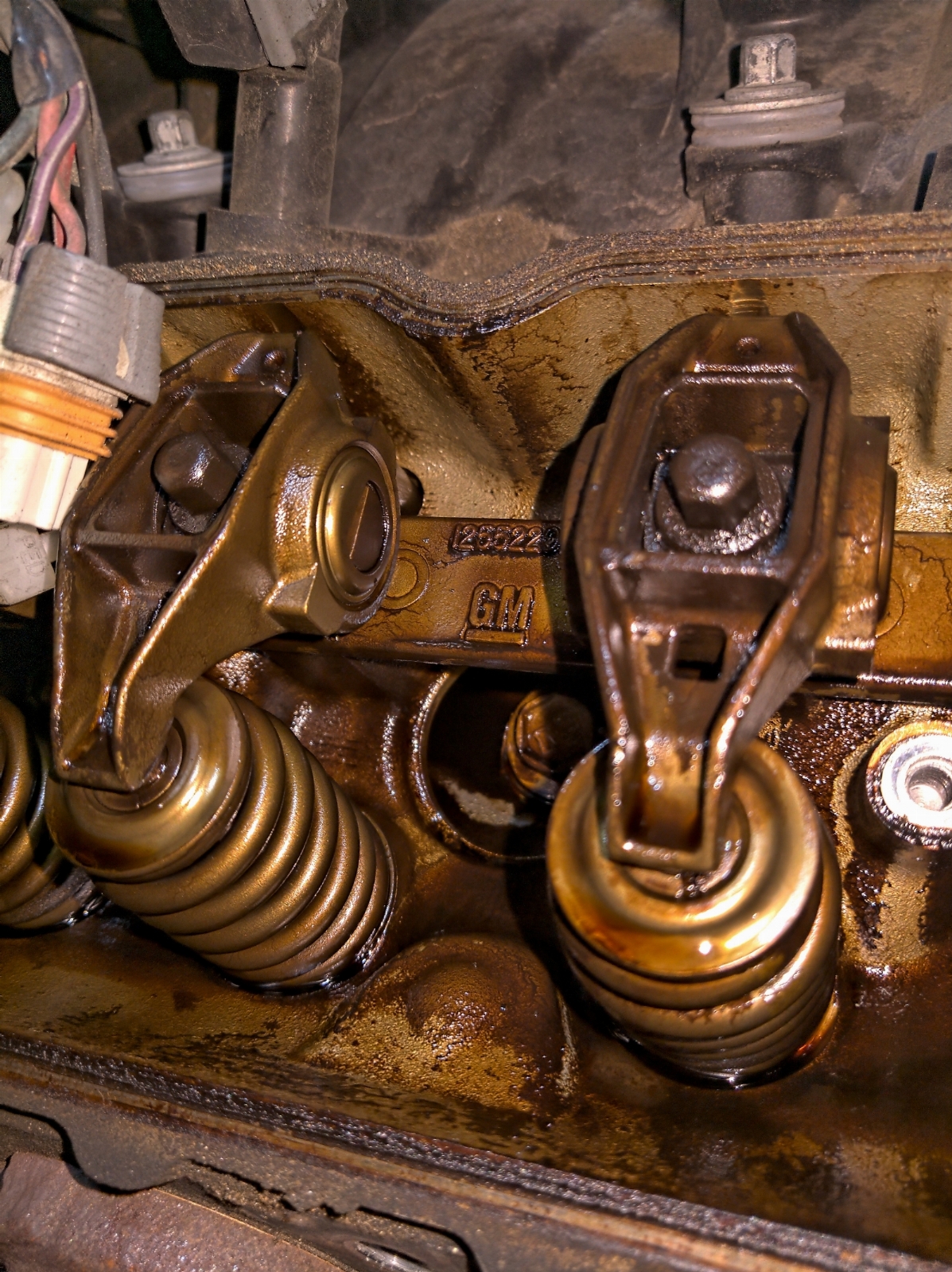

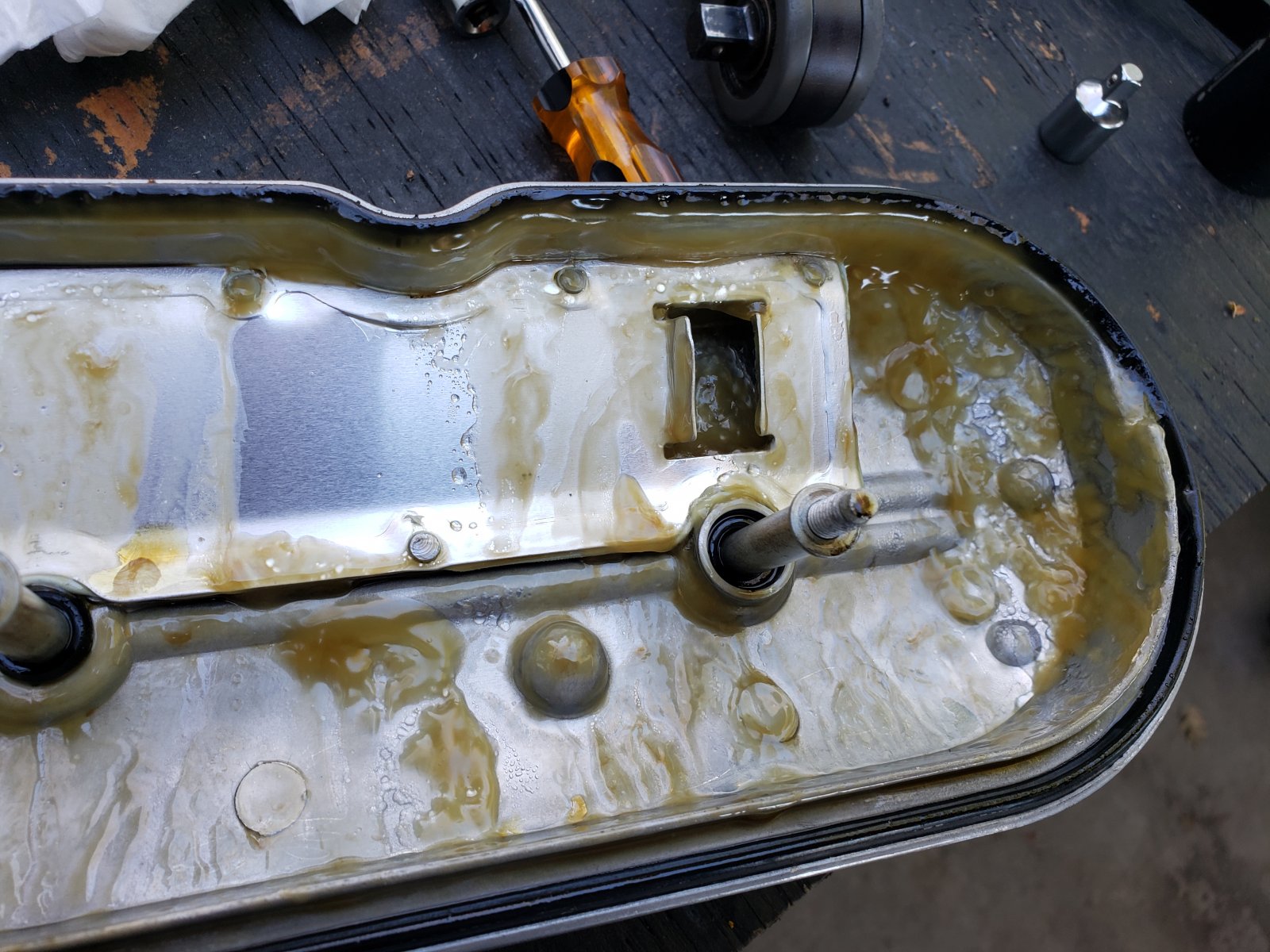

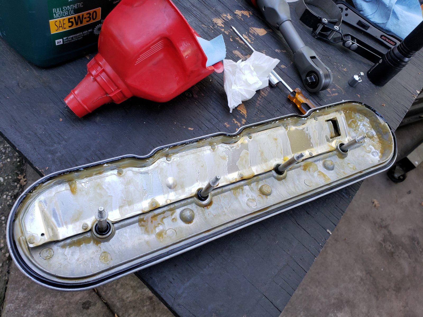

In my amateur opinion, that's definitely water/coolant mixed with oil. When my refurb head cracked, it looked like that as the oil was practically brand new. Get the dye and light and pressurize it and you might spot the leak. Otherwise, just prepare for swapping both heads, again, in my amateur opinion.
This is mine with unknown miles on the oil with the OEM heads.

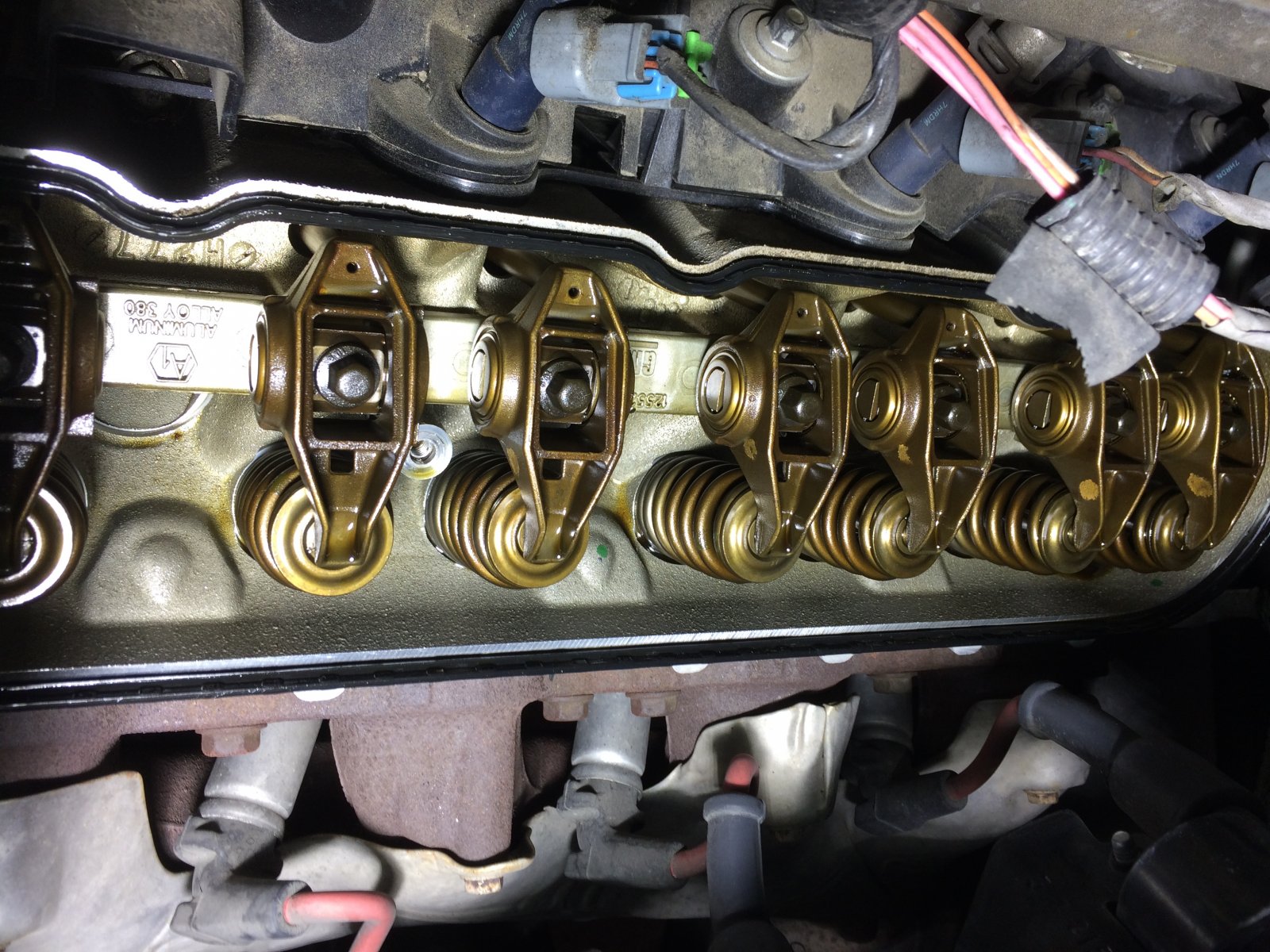

Same gunk but a darker background. The only reason mine doesn't look like yours is my valve cover is nearly new. I just hope the engine is still in one piece after running partial coolant as oil. Good grief. Not going to bother with any further inspections. 203k miles and I have the 706 Battery heads. It is time to take care of this. Thank you for pics.

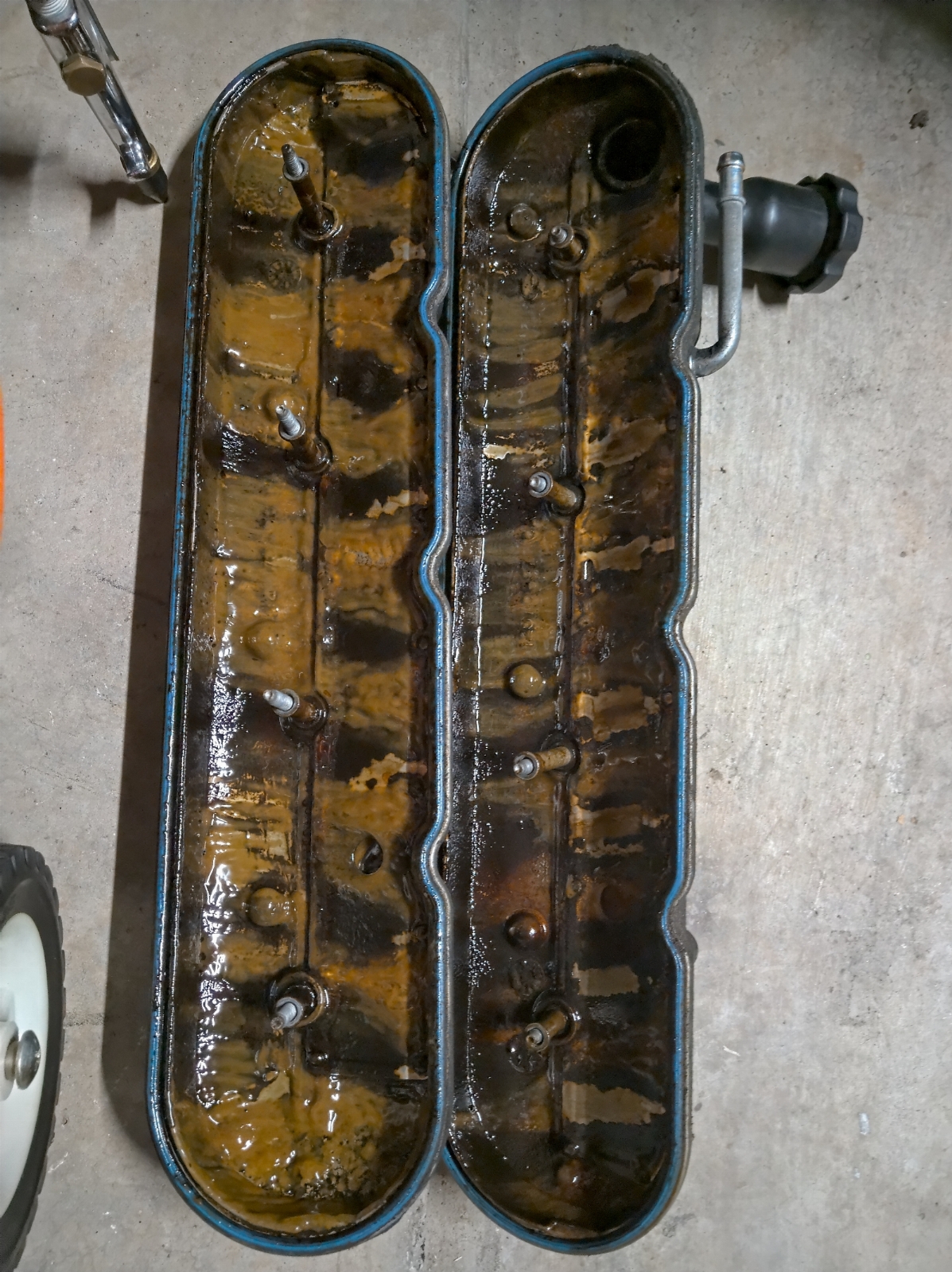

OK Major Update!

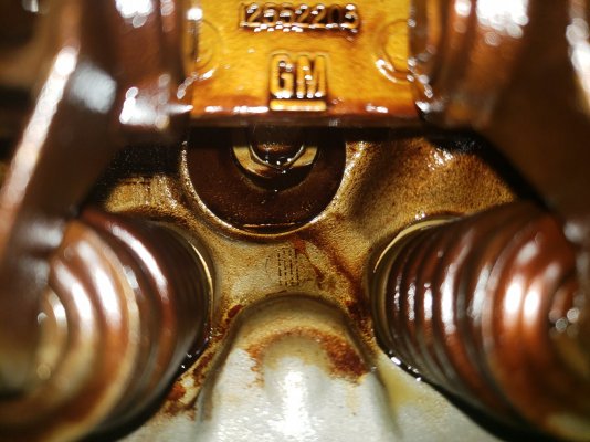

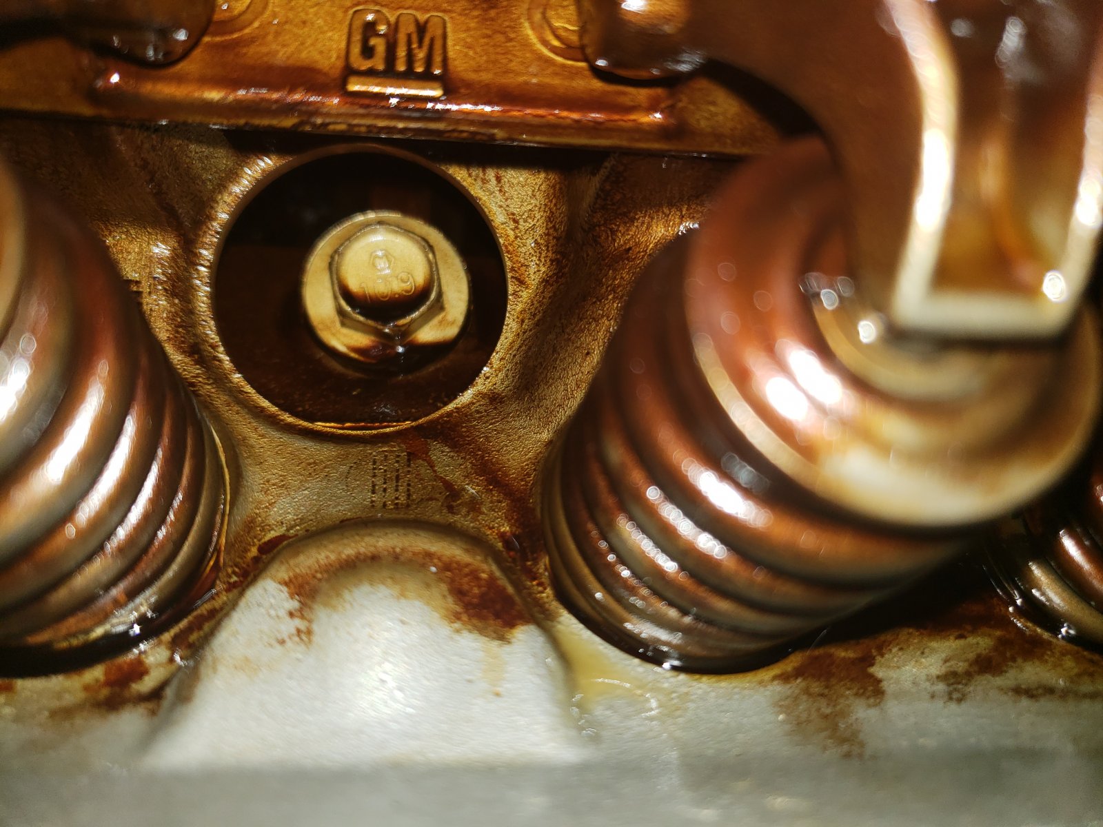

See Pics. I just replaced the valve cover 6 months ago and about 2300 miles ago and here is what it looks like. The gunk seems to have built up the cylinder head between the 5th and 3rd cylinder most ( dont have a picture of this )... Any conclusions?
View attachment 362709View attachment 362710

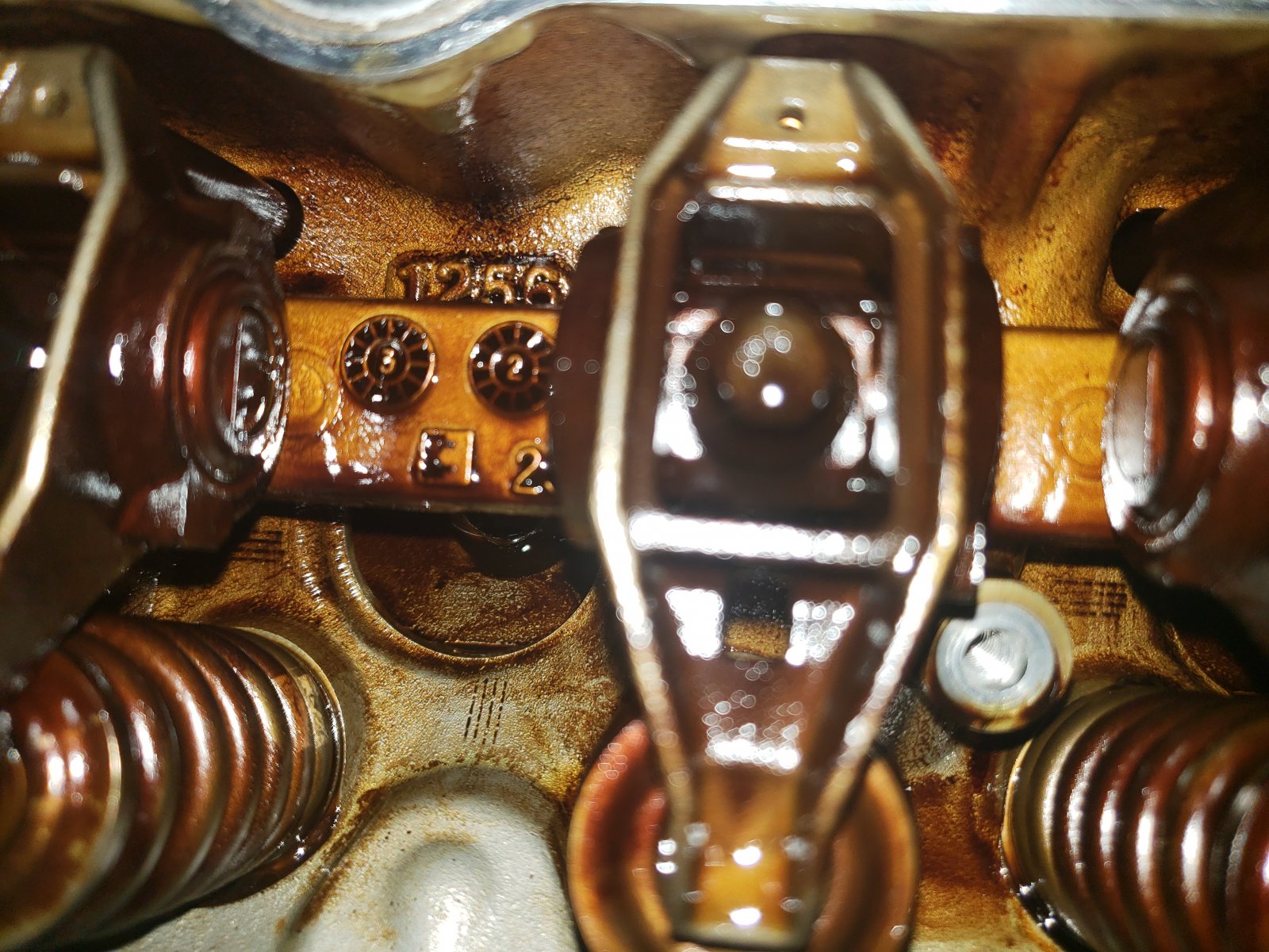

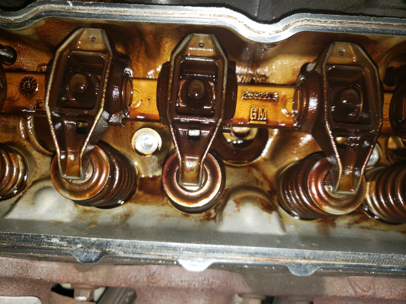

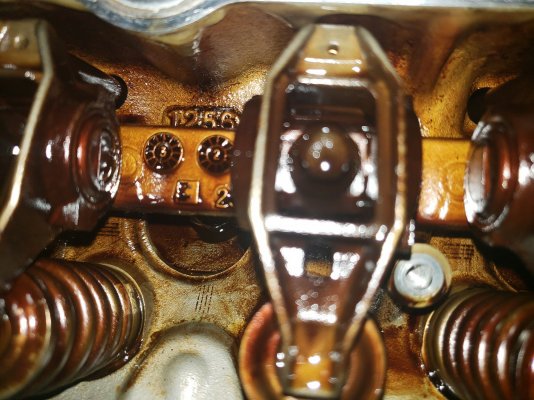

What do the heads and rockers look like? Any real clean spots on them? Pics?

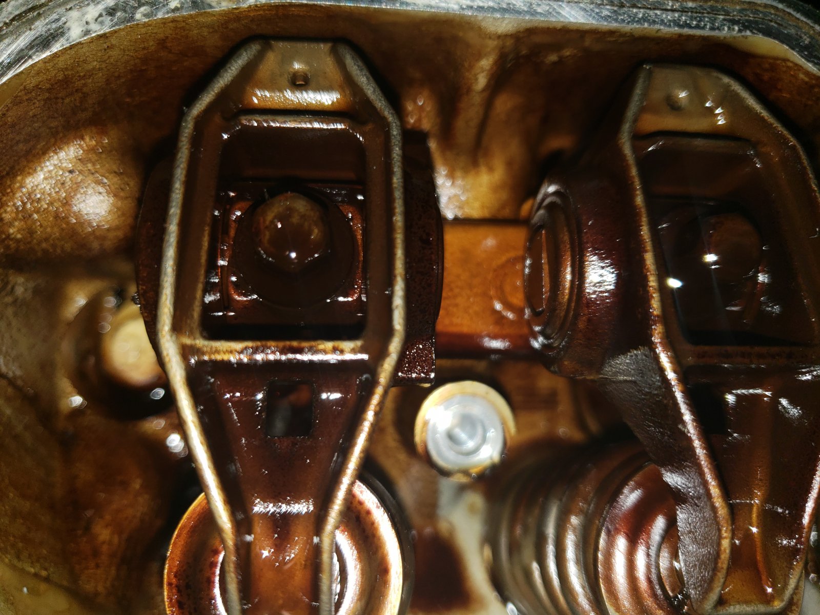

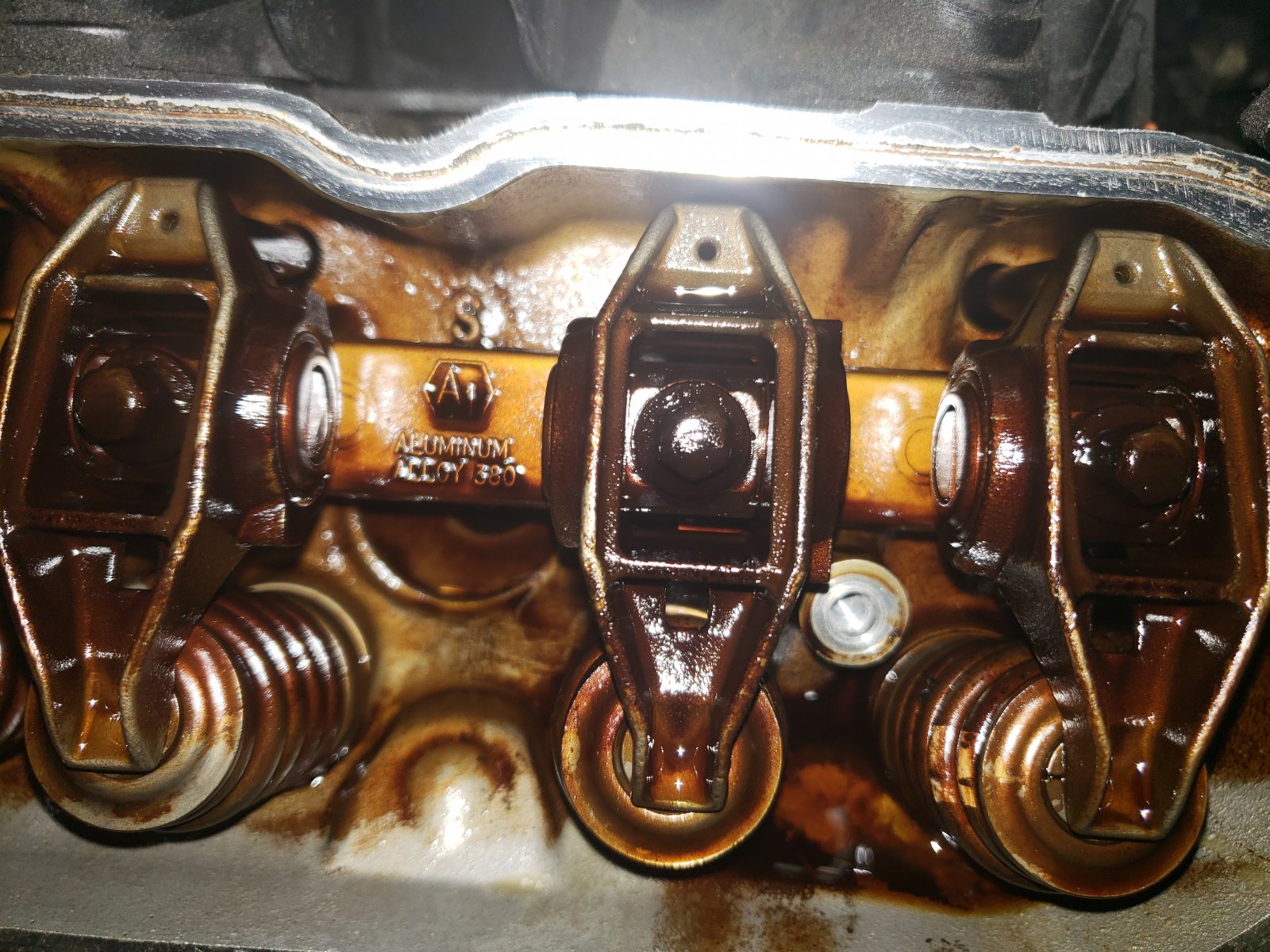

It's common that it only leaks when hot. From my experience, either you're running some really crappy oil or that's the beginning stages of the coolant/oil mix, meaning you caught it early. Honestly, if it runs great, has normal oil pressure and it's not full of black gunk, I'd say you're golden. Replace the heads and keep truckin'.

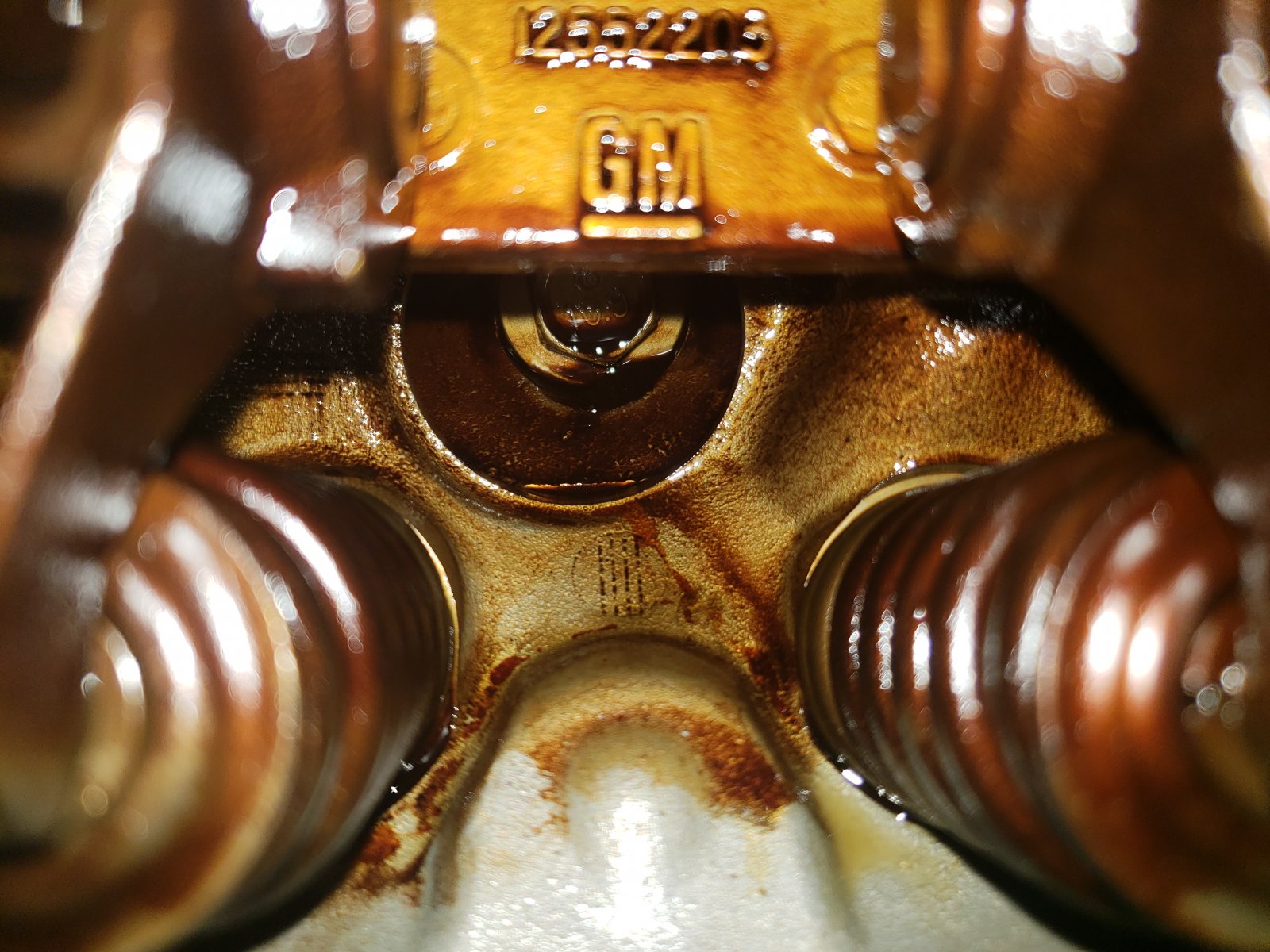

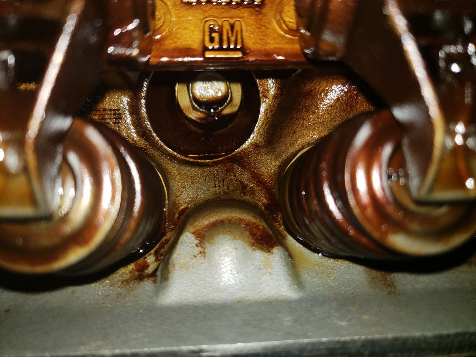

Can we get a good pic of the springs/rockers/etc.? Have you looked at the areas around head bolts, particularly between #3 and #5?

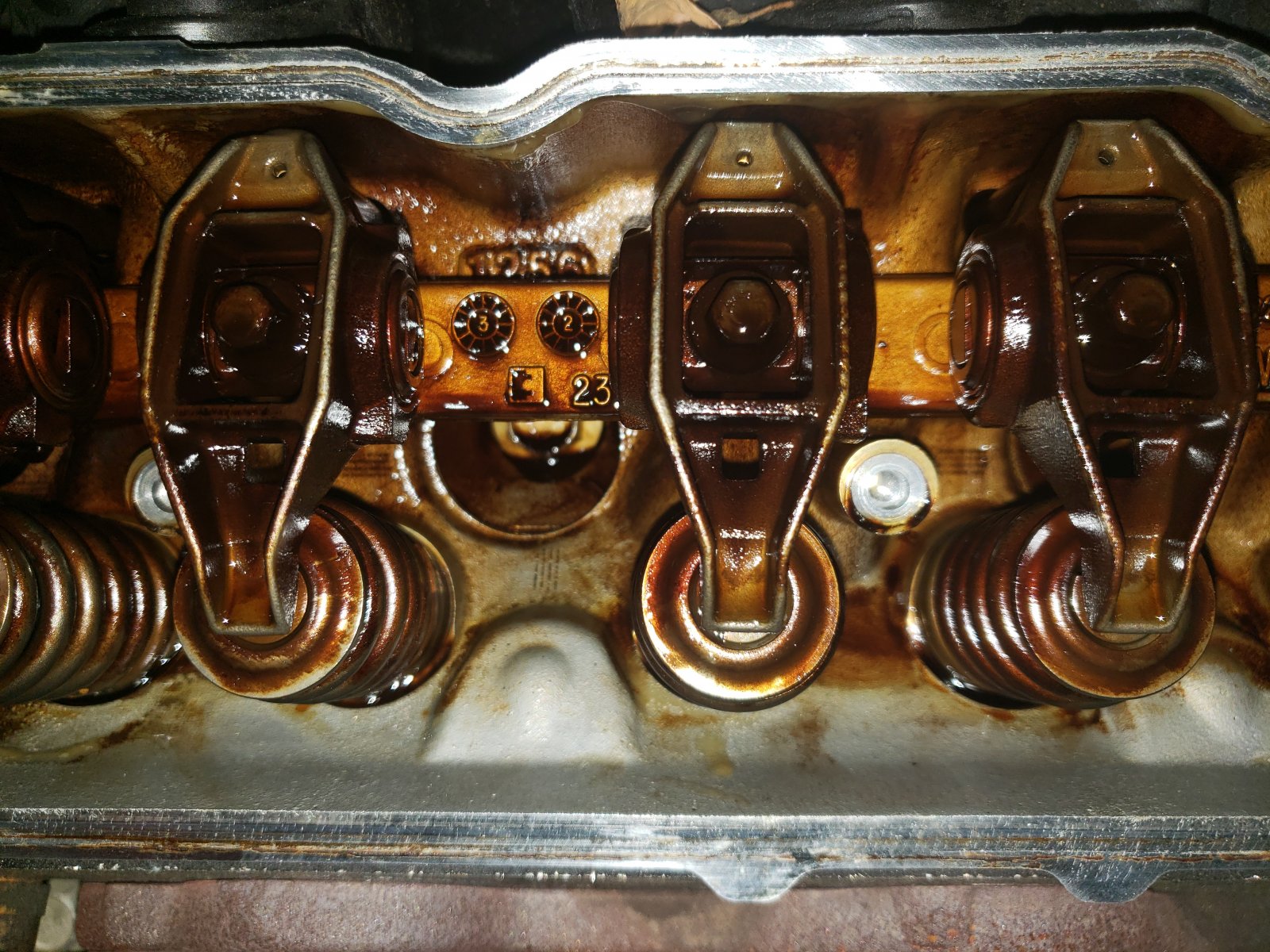

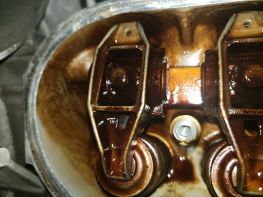

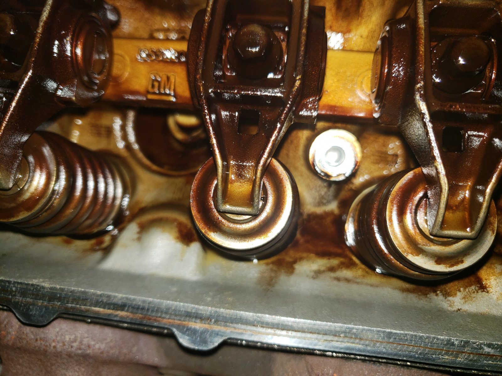

I don't see much here. One thing to note before I took this picture earlier today, there was bunch of gunk built up in between 3 and 5.

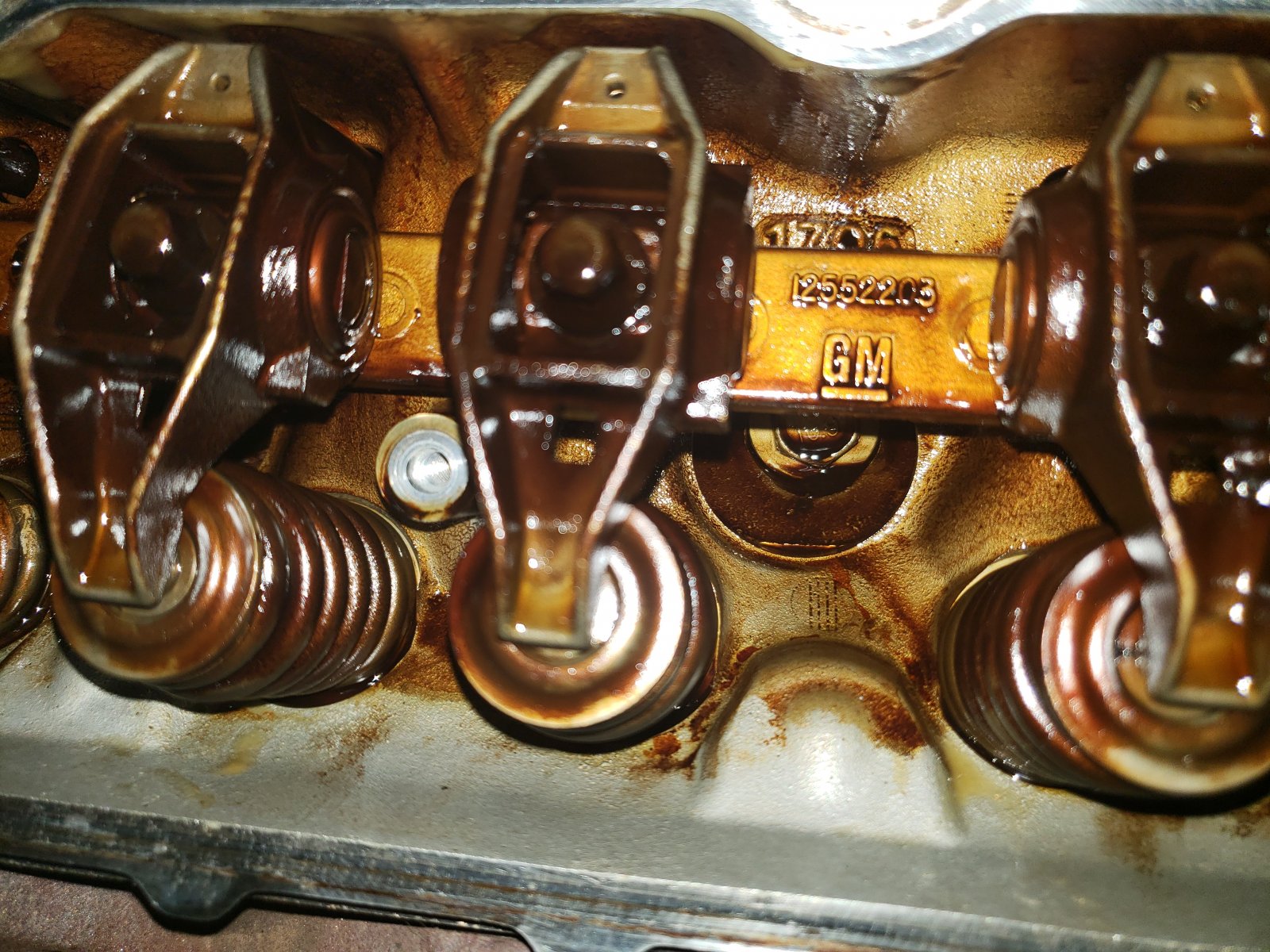

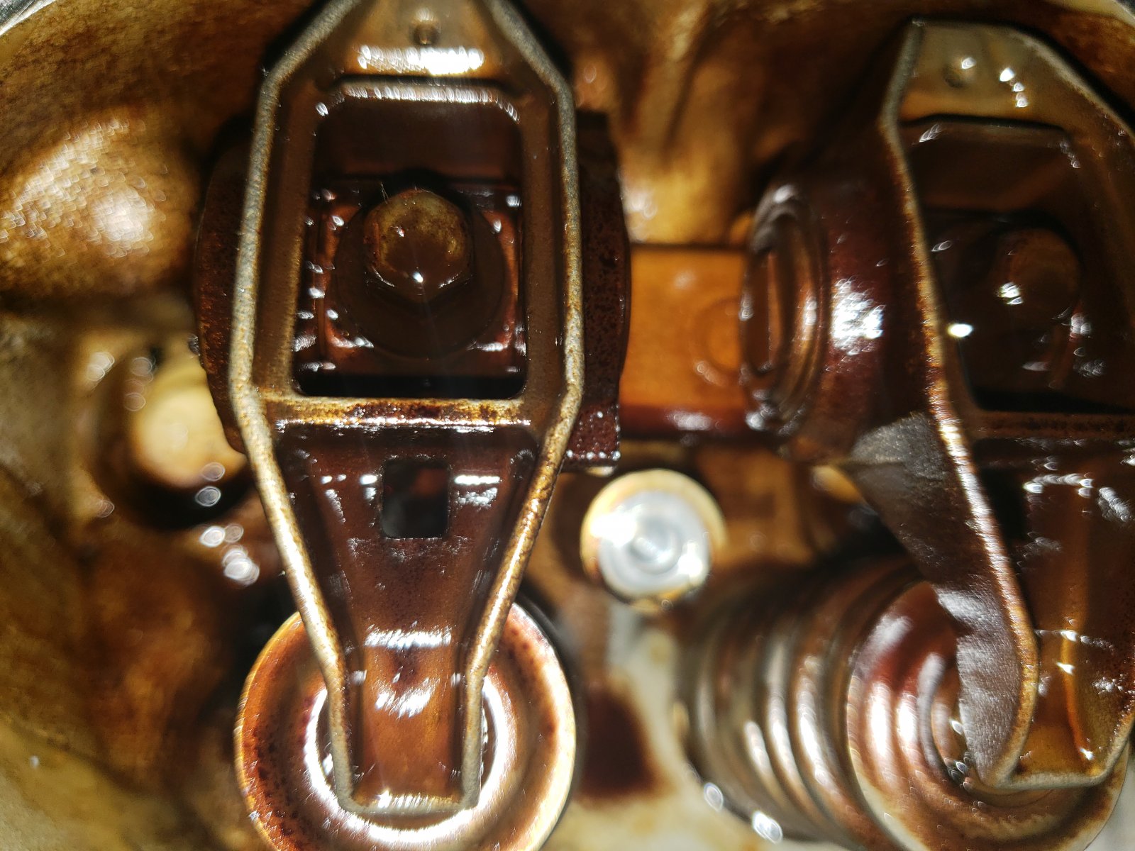

Again I don't see anything obvious. As mentioned, my engine is super clean as you can see in the pictures. Not bragging but very clean for 200k miles. I don't see anything that jumps out at me except the lumpy stuff which I wiped off prior to these pictures. Most were in the valve cover and in between 3 and 5.

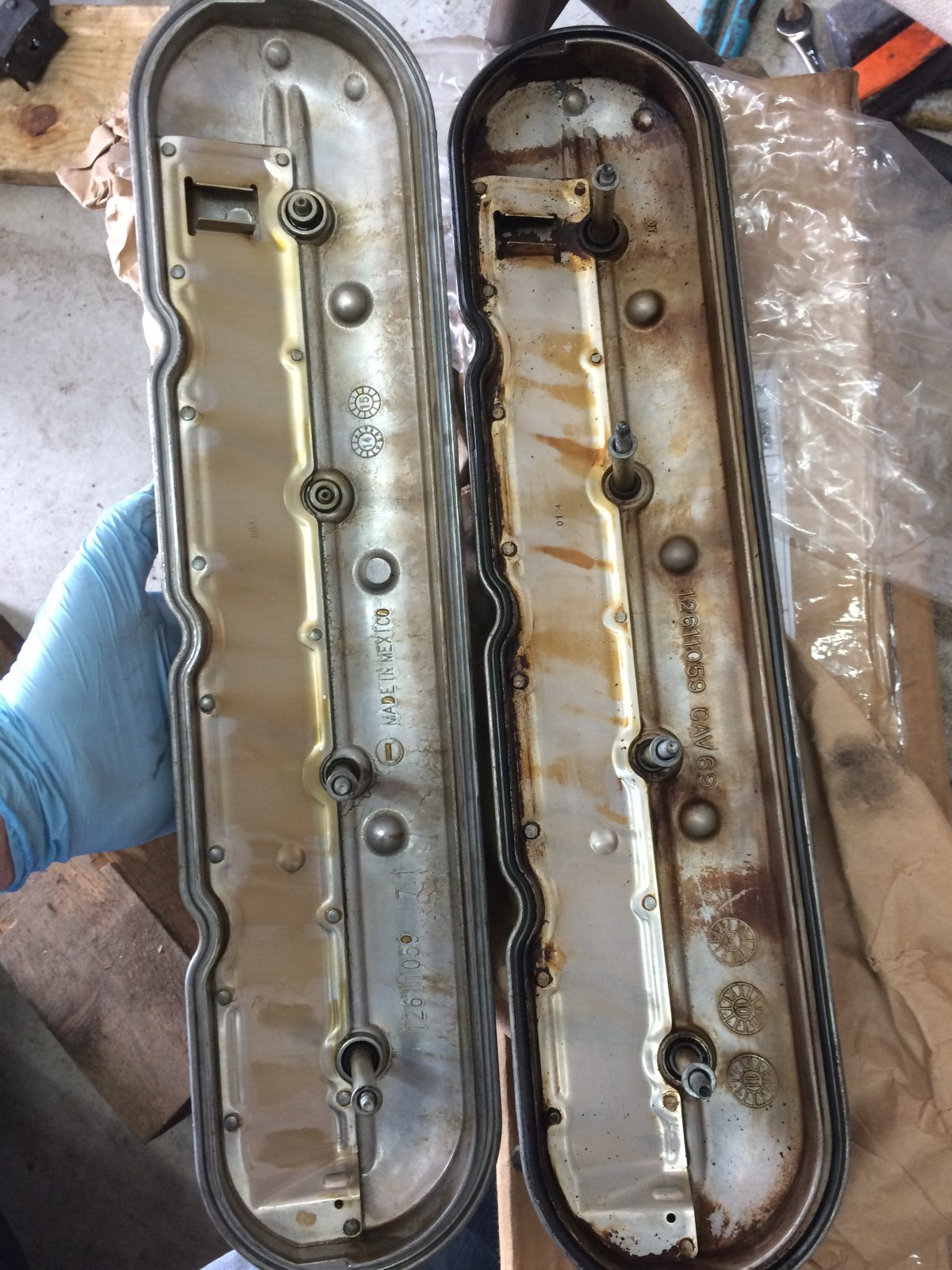

I know everyone is saying #3 or 5...but on both of mine, it was passenger side. (I know, the second time was dumb luck because I could have installed that head on DS instead.)
Not positive (and i didn't mark which cylinder on passenger it was) but think this is the crack on my OEM 163k mile set:

Also I was looking at your jelly pictures (LOL). It looks like driver's side had the most jelly even though passenger side had the crack in it. I think what happens is that the Jelly ends up blocking the PCV valve and hence the jelly is worse on the driver's side? Just a thought. Well if Blackstone gives me the thumbs up for coolant in the oil. Once removed, I will carefully examine the old heads and see where the crack(s) are. It will be interesting.
