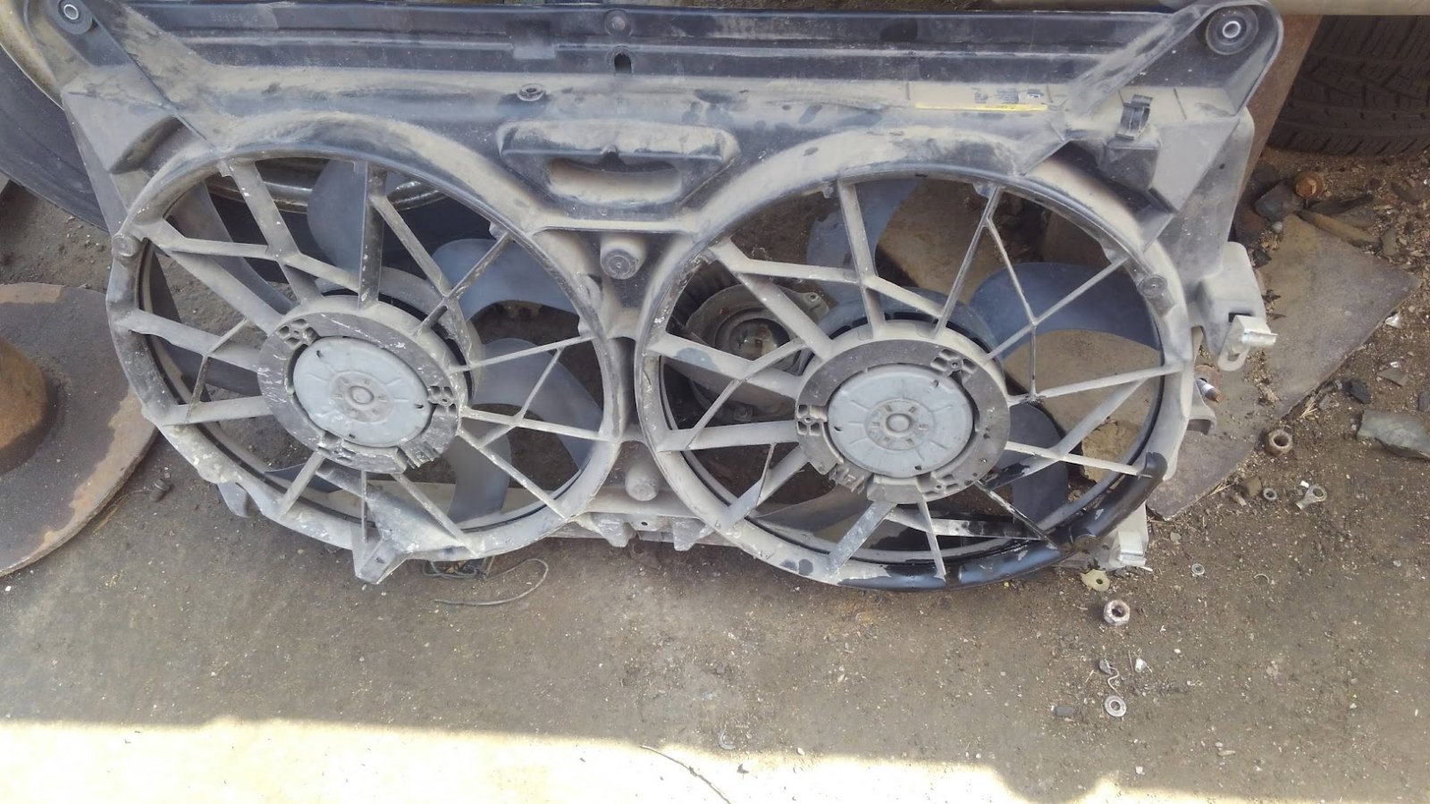

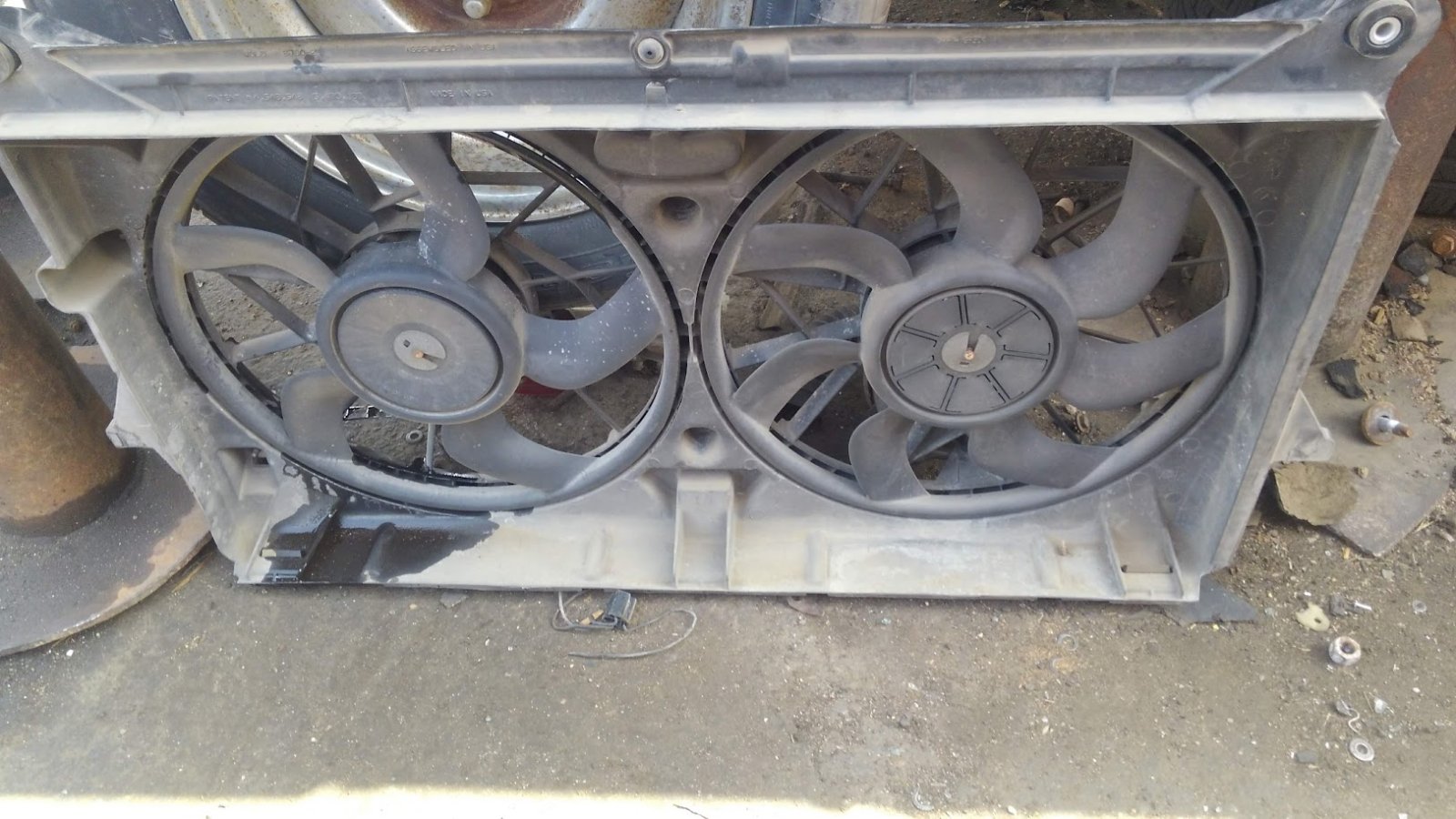

Thanks for the replies. I went down the you tube rabbit hole last night researching this conversion. The fans I found are from an 07 Avalanche. I looked back at the pictures I have of it and it is the common 7 & 5 blade fan setup. So I had first thought it was any 07 and newer vehicle but from what was found last night, it appears it's the 09 and later vehicles with the improved 9 & 7 blade fans. Can someone in the know confirm that break point?

Which fans are better to use on a conversion, the 5/7 blade fans & shroud or the later 7/9 blade fans and shroud?
Has anyone run across a thread that details why GM changed the fans from 5/7 blades to 7/9? I've been looking around and can't find the info I thought I'd seen long ago.
Which one moves more air? Which is quieter? Which is more resilient, long lasting? Let's hear your experiences with the E-fan swap. Thanks!

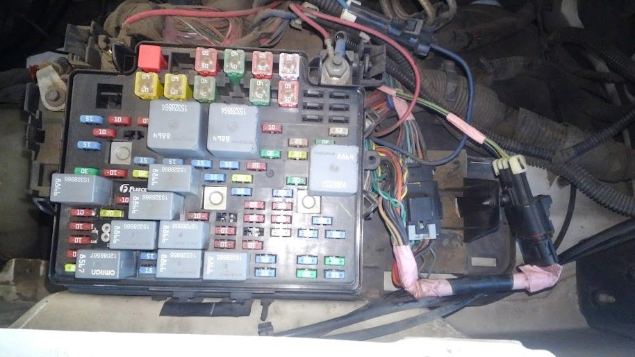

Quick question that's not addressed in any of the threads or videos I've seen for E-fan conversion. My 04 has two harness connectors with a bunch of wires attached in place where the 05-06 E-fan relay block is supposed to sit and clip in place. The relay block won't clip down or sit correctly with these wires and connectors there. What is the correct way to re-route or re-attach these 2 harness connectors that are factory on an 04 Tahoe? Yeah, I could just remove their attaching clips and let them dangle, but that would be less than ideal. If no one else has noticed this before, I'll take a trip to the PYP to see how the factory ran all these components in an 05-06.

I figured out what the unknown wiring is. At first I thought it was for Flex Fuel stuff because I was only seeing it on "Z" engined vehicles at the yard yesterday, but then I saw it on a "T" engined vehicle so that idea was out. The 2 plugs occupying that space are for the Autotrac transfer case. Once I figured it out, then it made sense....4wd has the 2 plugs there, 2wd is wide open in that space. There were two 05-06 Tahoe/Suburbans at the yard I went to yesterday but neither had those plugs so I first thought it was an earlier model thing, but nope those two were both 2wd rigs. What I haven't seen in the flesh yet is a 4wd 05-06 rig to see how the factory configured all this to work in the same space. I'll be going later today to a yard that has 2 rigs with this config(05-06 4wd) so I'll see what the factory did.
