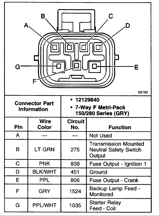

- Pictures below. Looking under the vehicle, the original grey 7 pin PNP connector on the harness has 6 of 7 inserts that have metal contacts inside them. The labeled "A" slot does not have a metal contact inside, and as I understand it from a wiring diagram, this is unused on some 4l60e's while others have a 7th wire that is hooked up here. I am including this info in the post because part of me is thinking the 2KCD may not "read" properly if it was originally hooked up with 7 wires and 7 pins in the 2002 Suburban.
- I've did my best to remove any glue from the contacts on the connector
