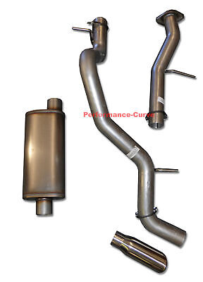

I also did an eBay catback at the same time. I had to change the flange to the one that came with the headers/y-pipe, your mileage may vary with that. It looks like the set that already has converters does not include the section to weld into the catback if they don't match up. Here is a Tahoe catback similar to what I used on my Silverado.
