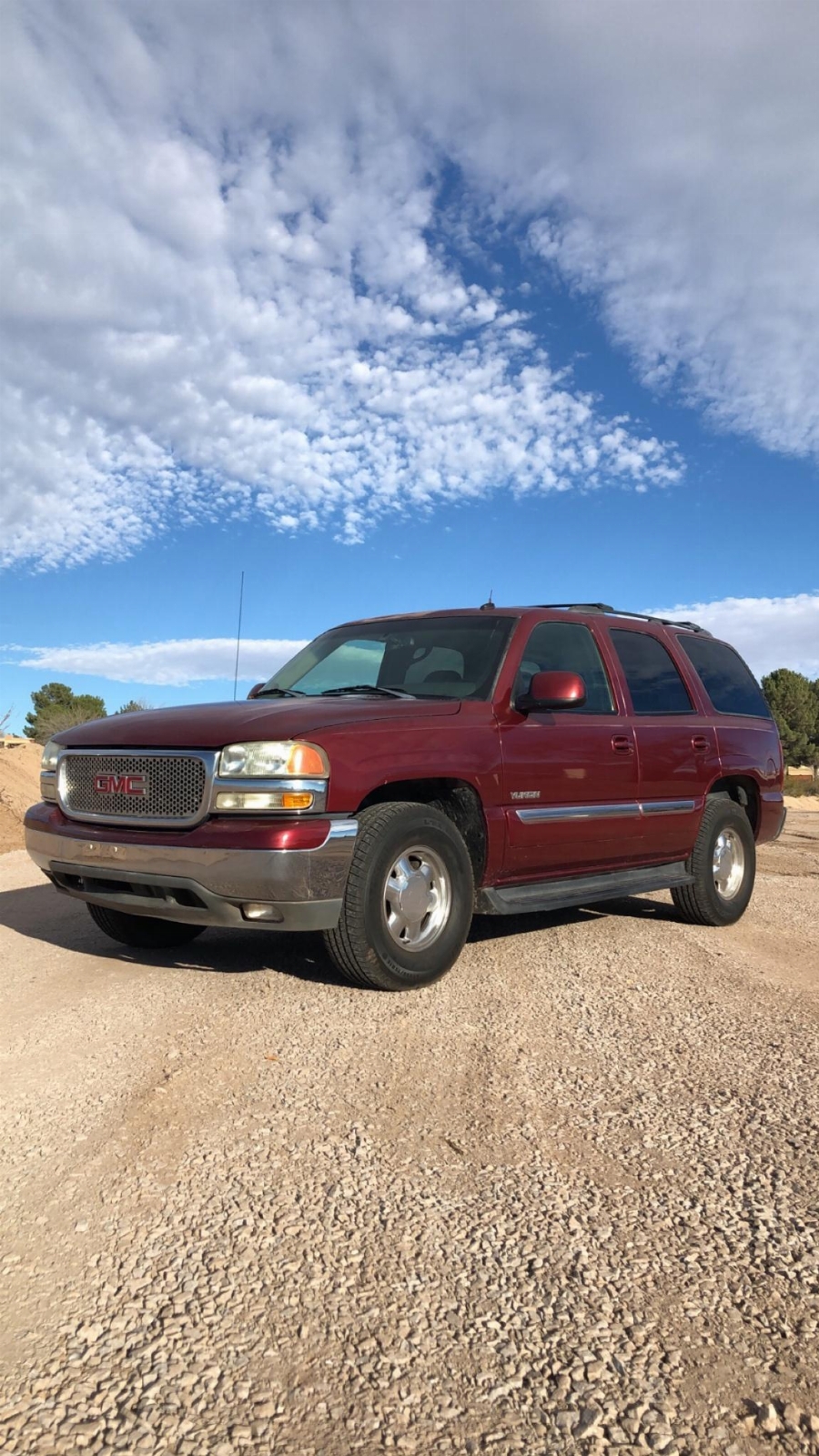

2003 GMC Yukon SLT is my new daily. 2WD with 208k when I picked it up. It needed a hand full of maintenance when I first got it, which I will update here for my records keeping.
Currently at 225k miles.

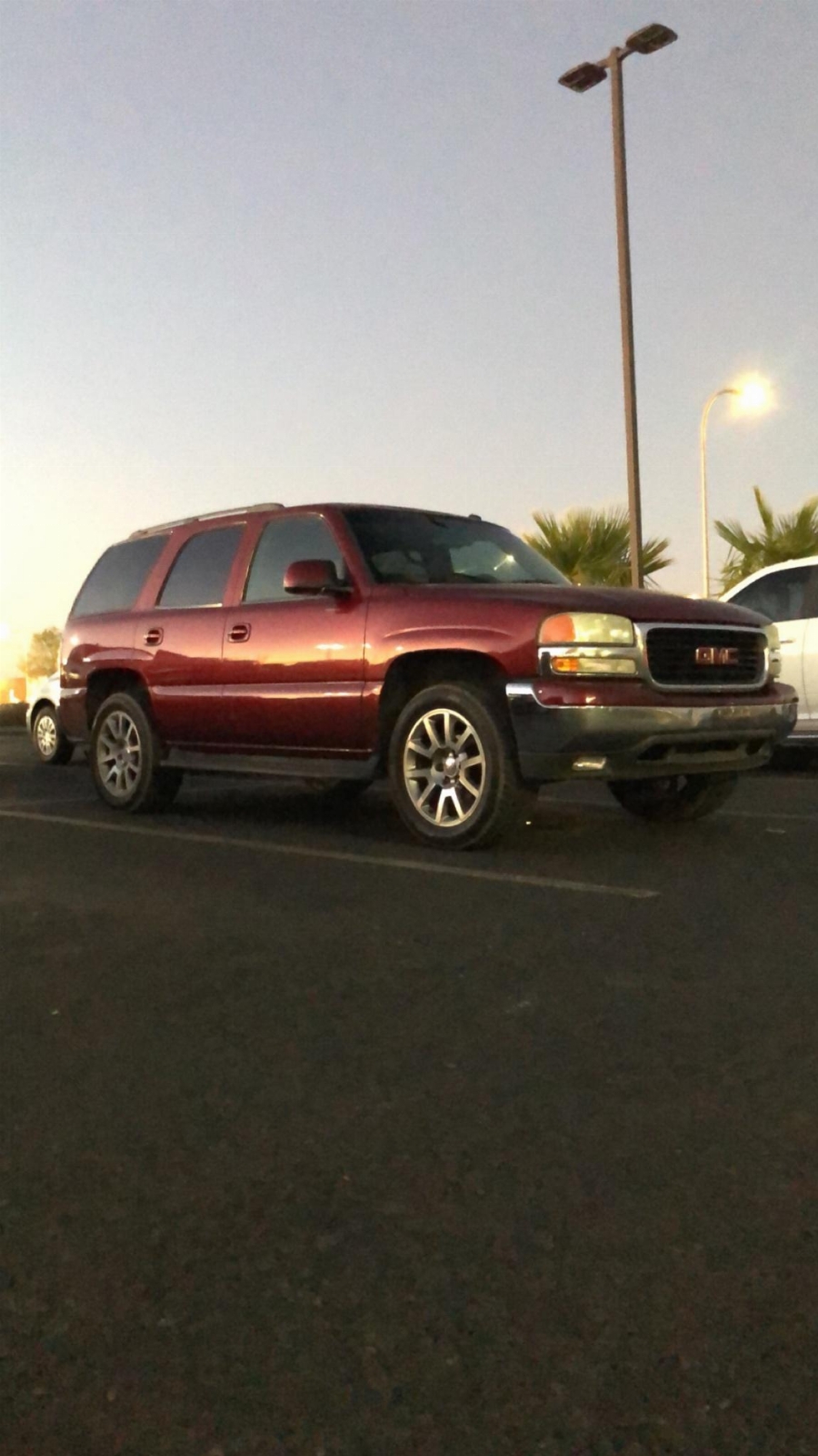

When I first picked up:

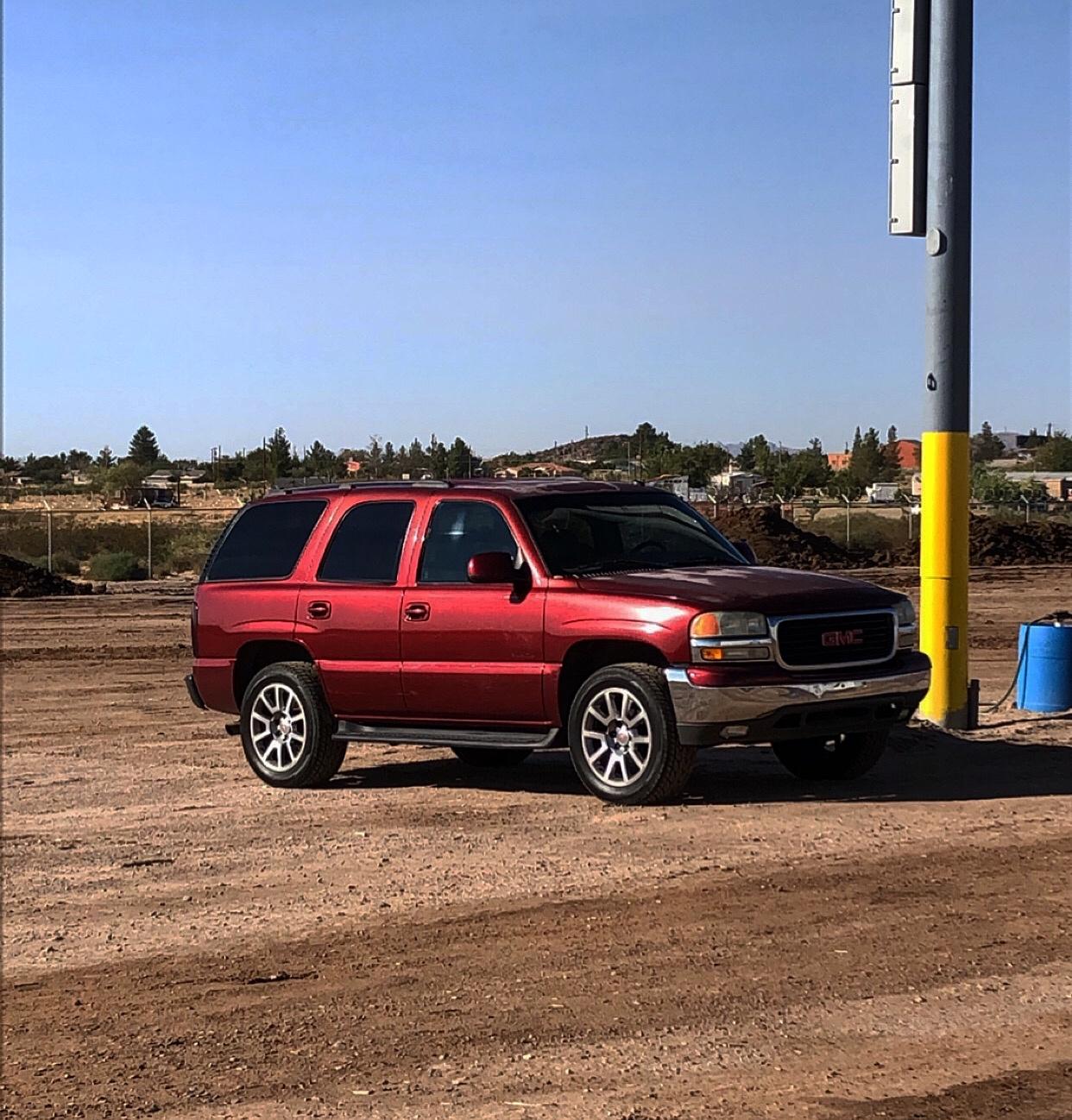

Another baseline:

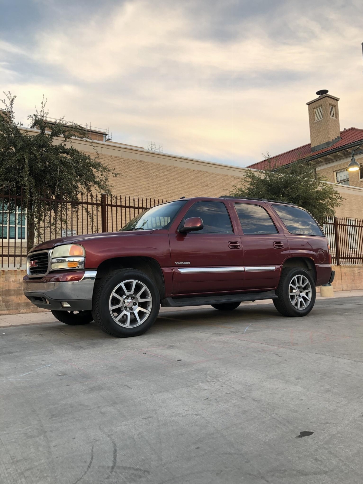

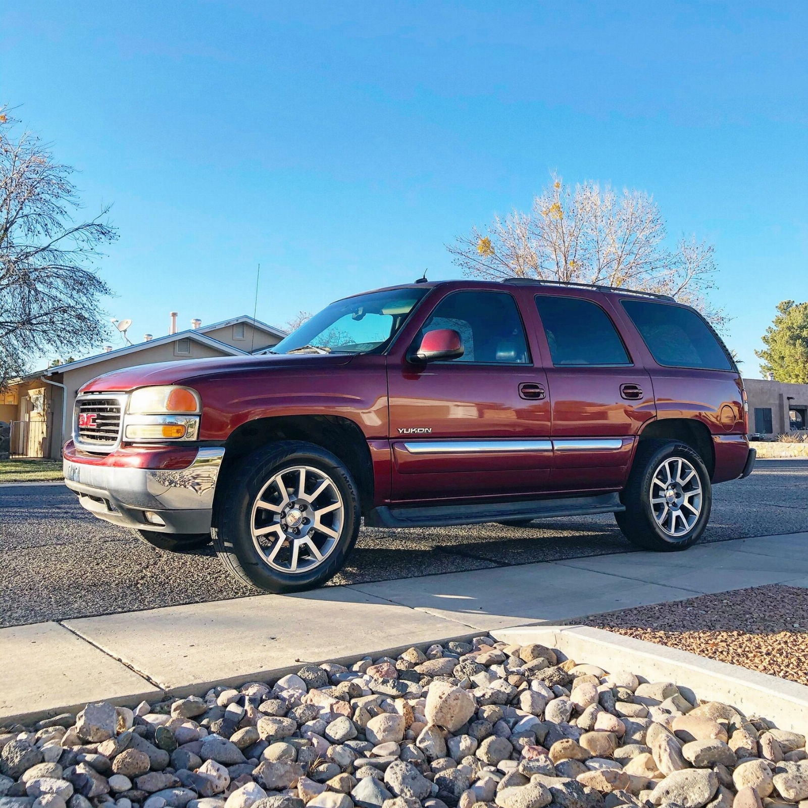

New wheels, trying to mimic baseline pic:

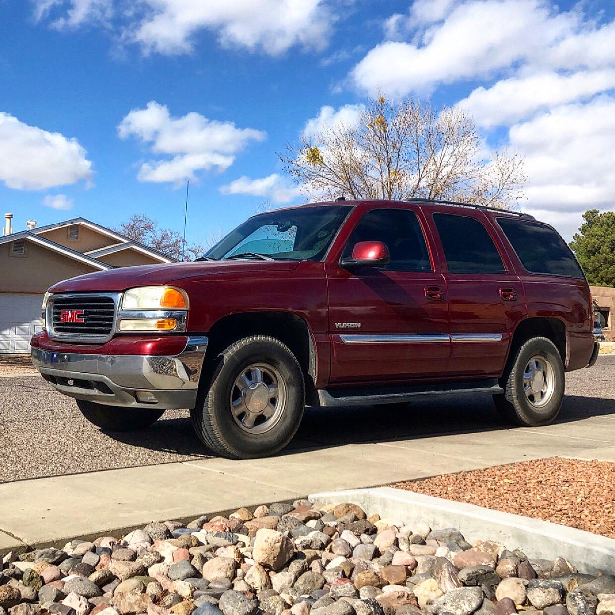

Random pictures with new wheels:
Took the moldings and badge off passenger side to see if I liked it:
I liked the no molding look as more time went on. I still need to do the driver side.

I have a 2003 yukon xl and I am pretty much in the same process. I detailed the crap out of it, changed the lenses on all around with stock, and also took the molding off. I used to want replacement molding but I think it looks great without it.
I need to get those wheels! They look great on it and I bet when its lowered it will look great. Can you tell me what vehicle they came off? I have been trying to look it up....
adventurenali92
Feb 16, 2015
7,721
9,172
Big Bear Lake, ca
Those are 2015-2020 Yukon and Sierra Denali factory wheels. I have them on my 2006 in the same finish. They also came in chrome and polished alloy finishes. It’s a good looking wheel and easy to keep clean because of the wider open spaces on the wheel.

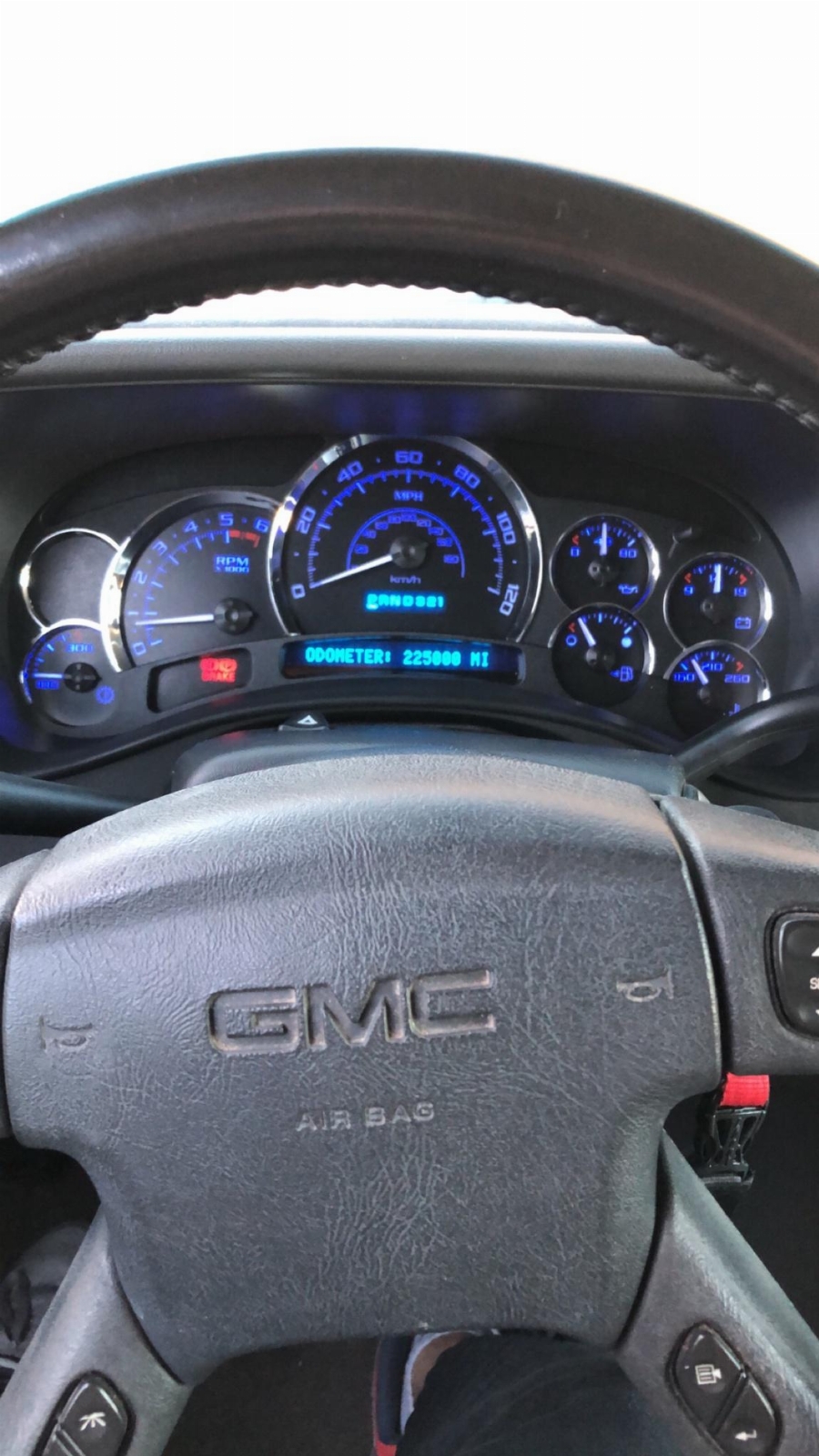

Late post. A few months back my cluster was intermittently going out. Then it completely died. Drove bling for almost 2 months before buying a cluster from digitaldashsolutions/fixmygauges.com. I LOVE the way this came out. At first I was a little overwhelmed by the blue at night, but the more I drove it the more i liked it.

Looks like an Escalade style cluster? Looks good mate! Love the blue LEDs! I have blue in Escalade cluster as well and I love it. Though I went with a white gauge face.

Yes, Escalade style upgrade with tranny temp. I was torn between black or white faces, but went with black face white needles obviously.
