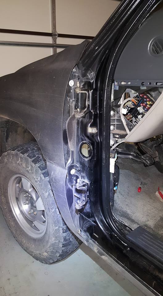

I've been rebuilding a Z71 for a little over a year now. Everybody has been very helpful on this forum. I thought maybe I'd make a post to show progress and answer questions people may have on the forum. Here's a link to my progress checklist:
https://docs.google.com/spreadsheets/d/1z6_Z_Qp6894l2SQfoOI5LbV4qTkhpVHWafIYMIH4ieE/edit?usp=sharing
I'd wanted a truck in better shape but sprang for this one as my girlfriend's kid really liked it. I purchased the truck with around 225,000 hard miles on it. It was the last owner's off road toy.
EVERYTHING rattled. However, I've got most of those issues fixed, amazingly. Had lots of issues with driver side door, dash was beat up, and couple chassis things (like new shocks & new rear end lol).
My checklist is missing a great deal of things that I've already done. However, you can see pictures of some of those things here:
https://drive.google.com/drive/folders/12se7iVcdgFgoaJdHDH04SAmVNoPeVxJk?usp=sharing
I'd kind of hoped to launch a Youtube channel showing all this stuff being rebuilt. However, work and life have had me more than busy enough.
Enjoy :)
PS. Partly I need to get organised because I always go to the junkyard and forget to buy half the parts I needed lol Hopefully I'll need fewer and fewer trips for parts.

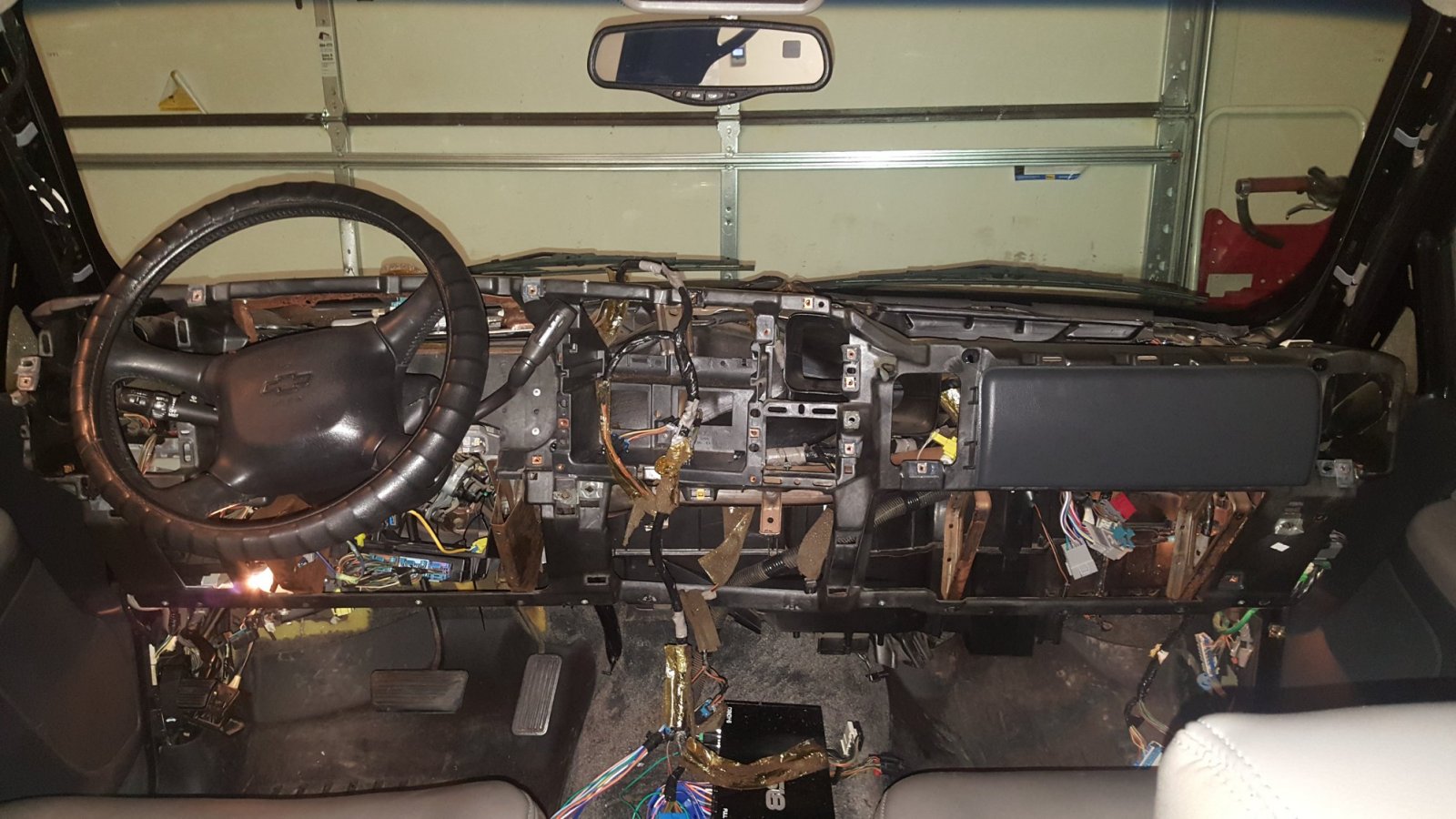

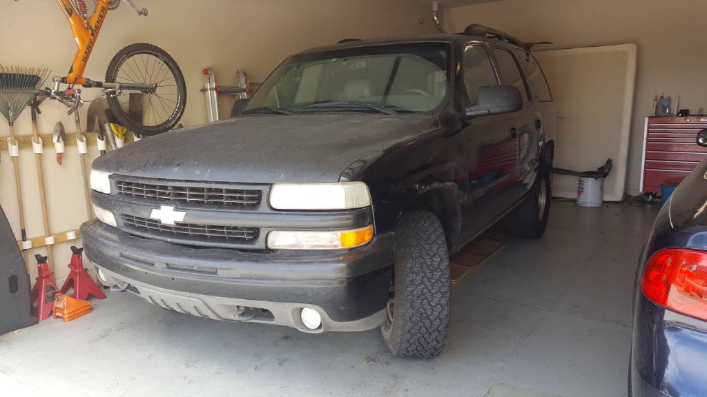

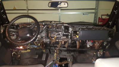

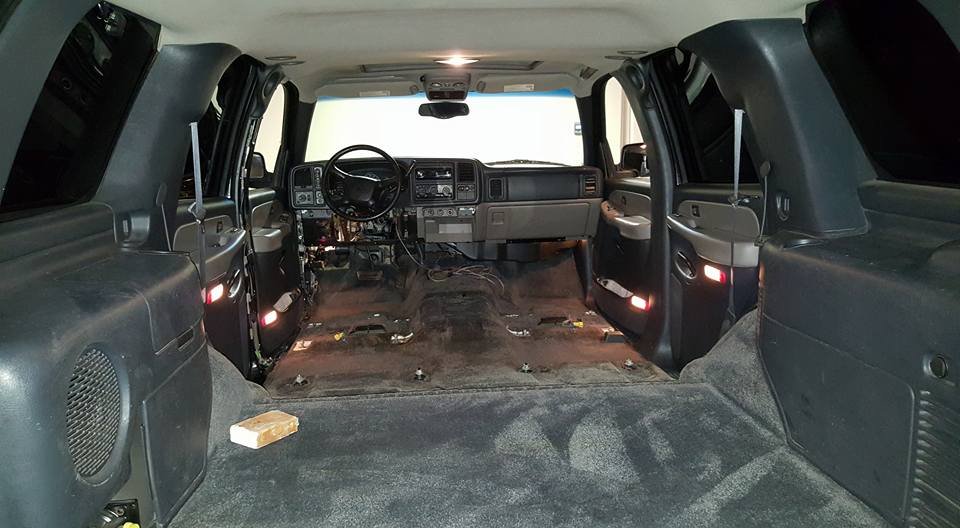

Below you can see, an image of the truck right after I bought it. I immediately stripped the interior including rugs and cleaned them with a garden hose and lots of detergent. The dash was dismantled as cover was absolutely destroyed, and driver door was removed. I rebuilt all the hinges, and many of the internal pieces. That door was a mess still has issues (window frame is bent in slightly yet).

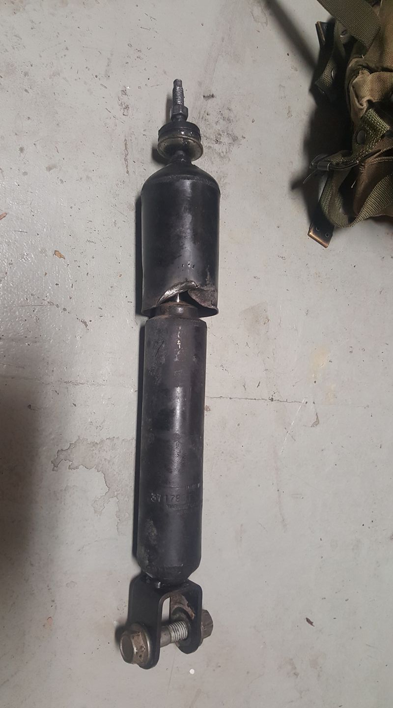

Lastly, a bit of levity. My first off road trek resulted in that shock falling off. The guy I bought it from put a leveling kit on. However, he never spec'ed shocks appropriately. They were too short. A few good bumps and the shock ripped out of the upper mount. Good excuse to install Bilstein 5100's

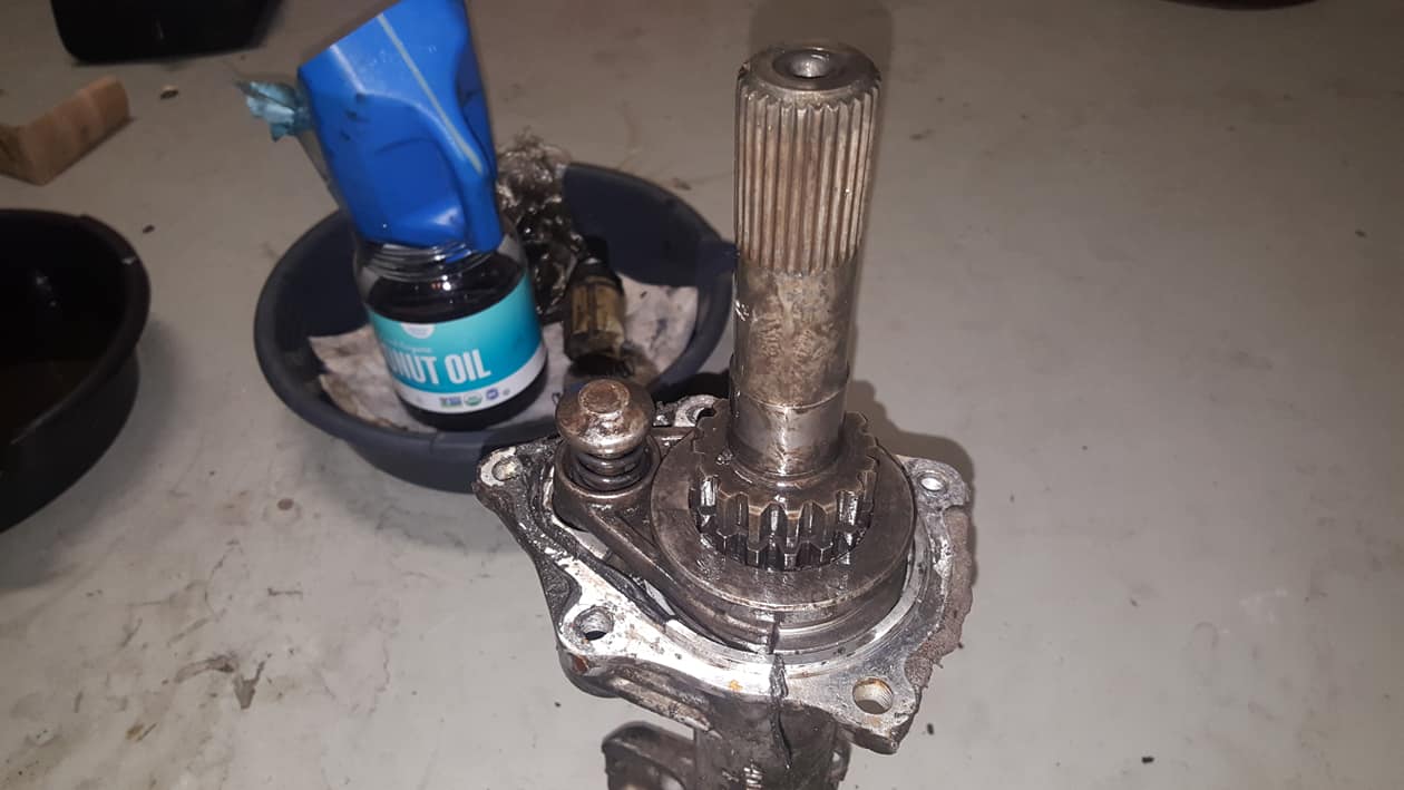

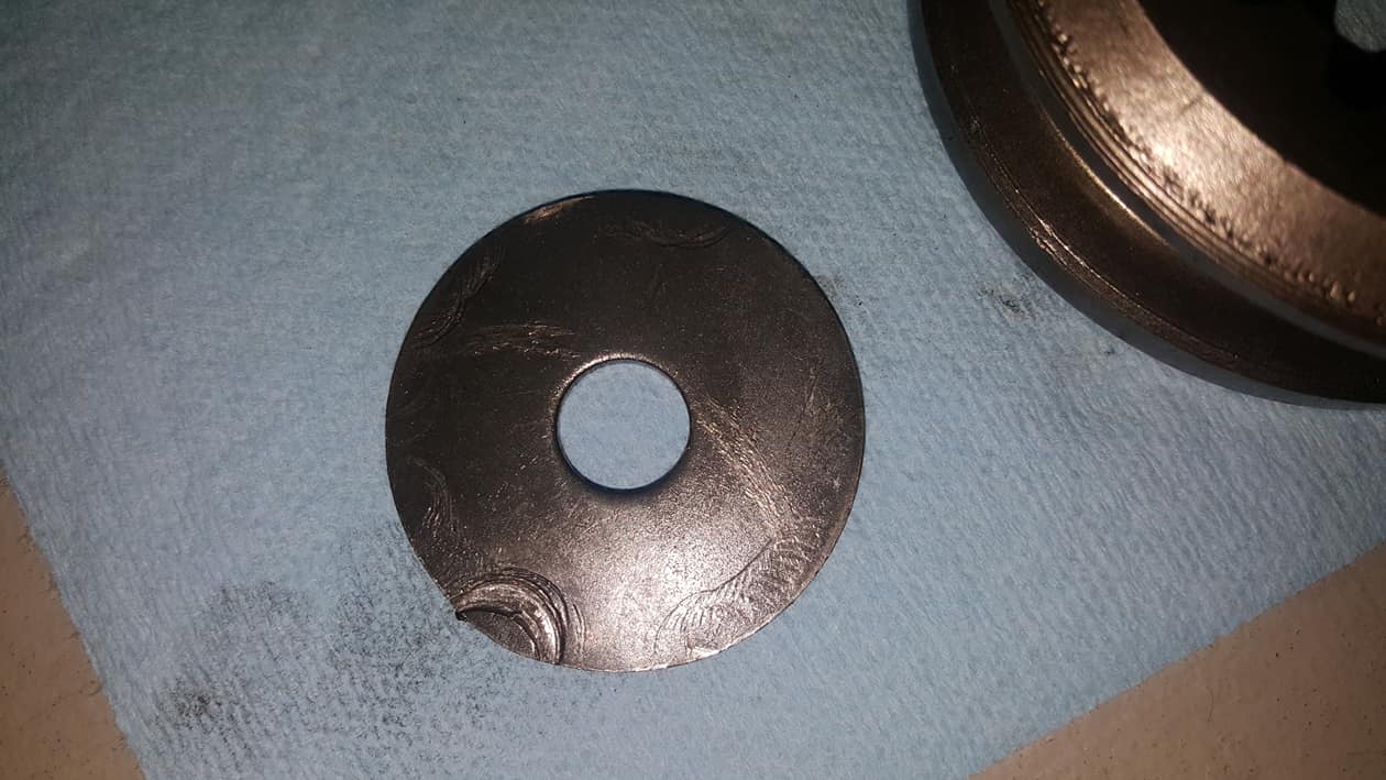

Another fun note, I rebuilt the front axle tube. It was all out of tolerance and really loose. I replaced the clutch bearing, output shaft bearing, sub shaft bearing, and shimmed it correctly.
The axle housing was the victim of somebody changing outer seal (possibly bearing too) without taking the axle tube off. You can see where they scarred the shim trying to put the axle shaft back into the assembly w/o removing the axle tube.
Quick tip: bread crumbs work like crap to remove the clutch bearing. I melted a wax candle into the bearing on the stub shaft. Then I put the axle shaft into the bearing like it's intended to go. Then I hit with a mallet (not a metal hammer). The clutch bearing came right out :)

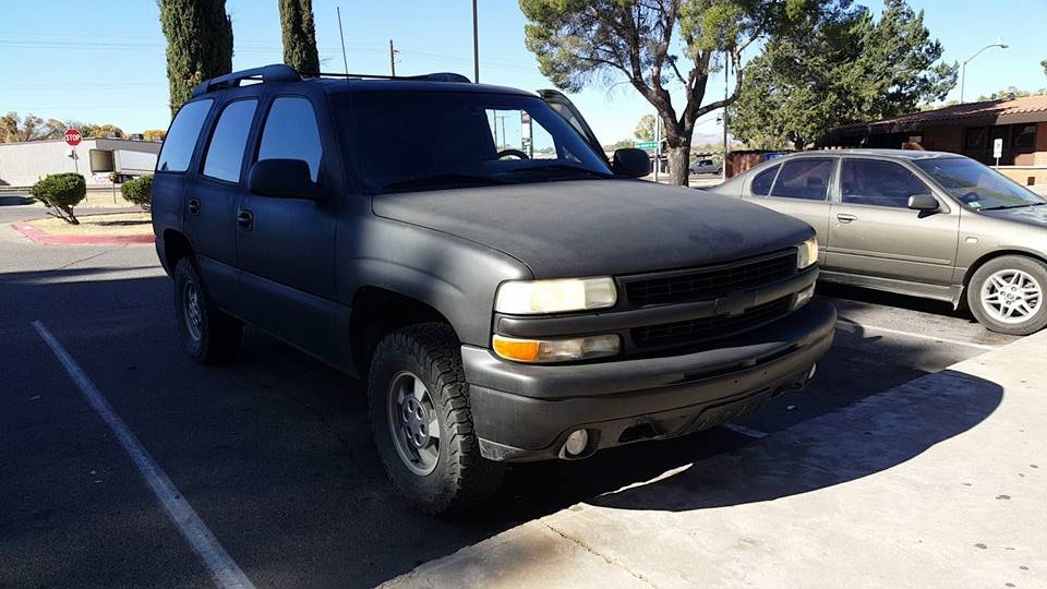

The guy I bought it from plasti dipped it. It's a MESS. I like the idea in concept but in practice stinks. It is impossible to wash and he got it all over the plastic trim pieces, mirrors, glass etc. The plasti dip is almost impossible to get off plastic pieces too. I tried removing it with goo gone but risks damaging the plastic part (is okay on metal and glass).
I think if I had choice I'd paint with a much thicker or scratch resistant paint. Possibly a very thick clear coat so can be buffed more often. I have plans when I get time to redo the bottom section of the body with a rubberized truck bead liner and give it a two tone look. I've done that on cars before and it WORKS and looks AWESOME.

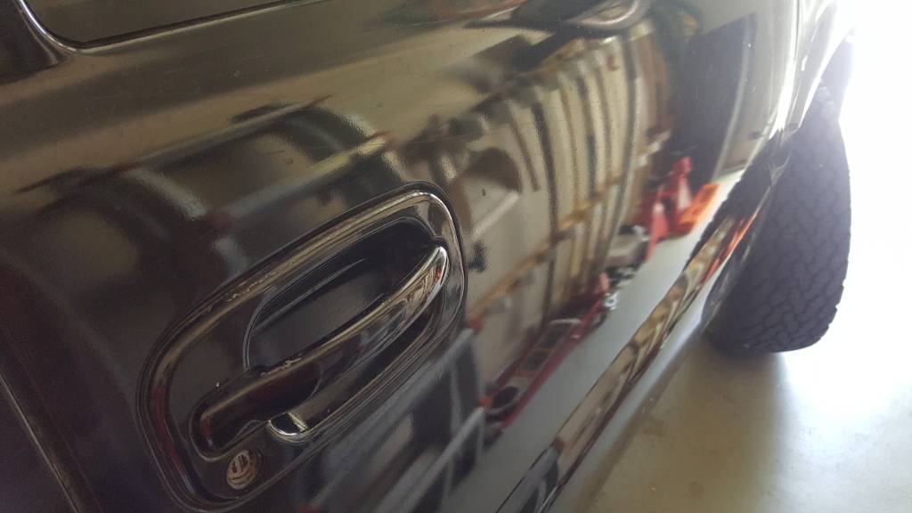

So I got most of the PlastiDip off. WD40 did the trick, best way hands down to get it off. I want to paint it but need a few tools.
First I want to purchase a variable speed random orbital polisher. Any suggestions on what is a good one?
I want to polish the truck I think a few of the panels maybe decent and not need a base / color coat.
Below are a few pics... hood is stubborn, still needs most of plastidip removed. Likely will have to remove hood to get it off then paint hood while removed.
One side of truck has extensive clear coat damage as well... I am assuming was parked outside for yrs with that side more exposed to Arizona sun.
