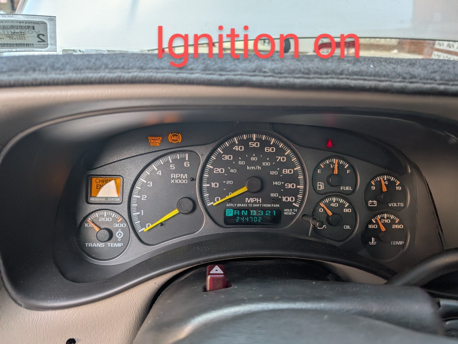

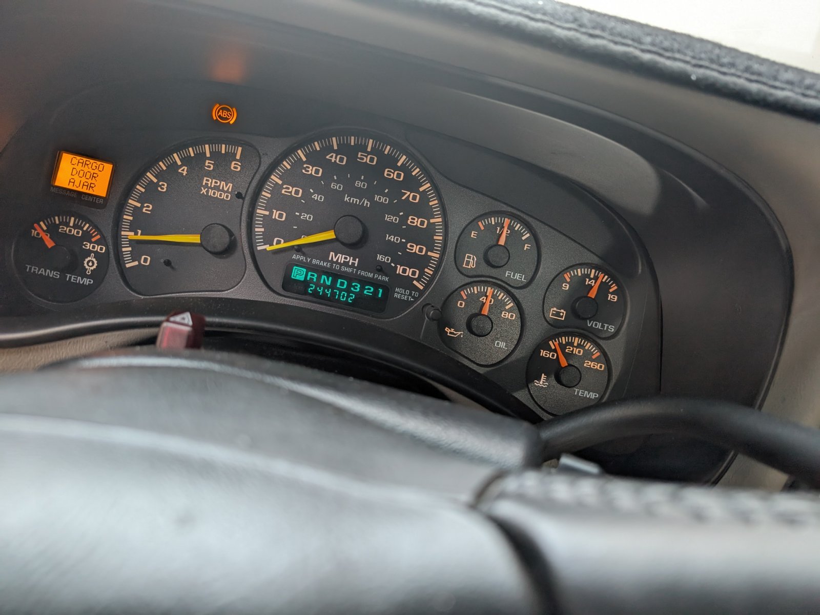

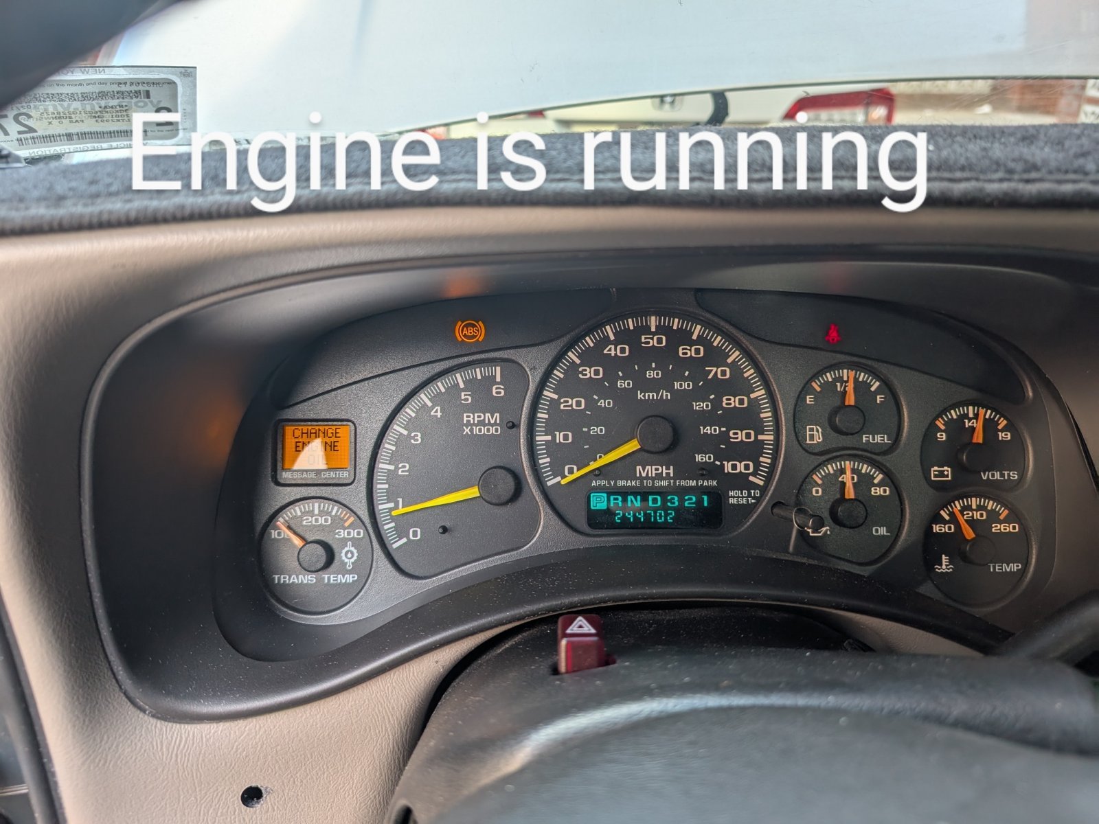

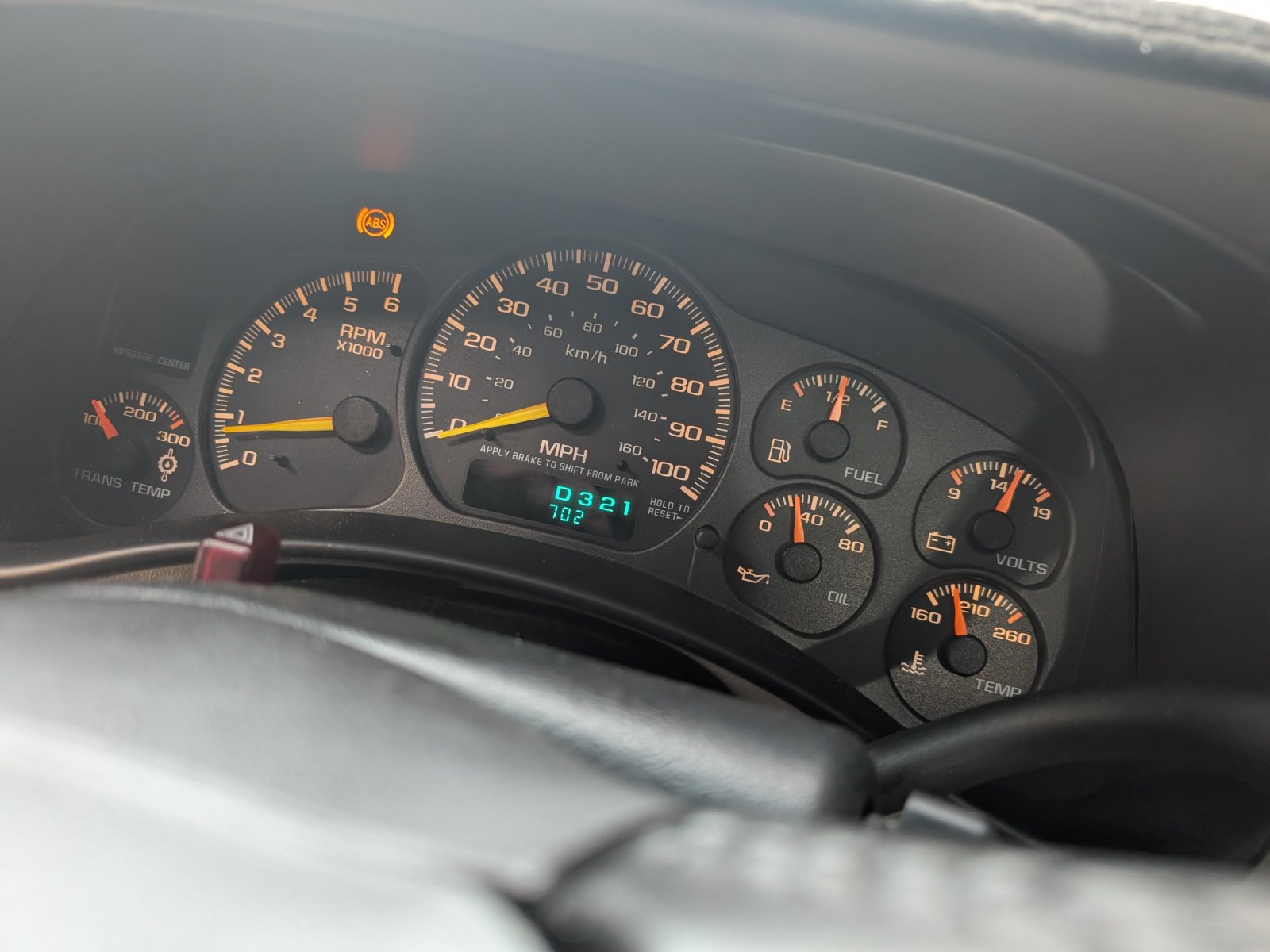

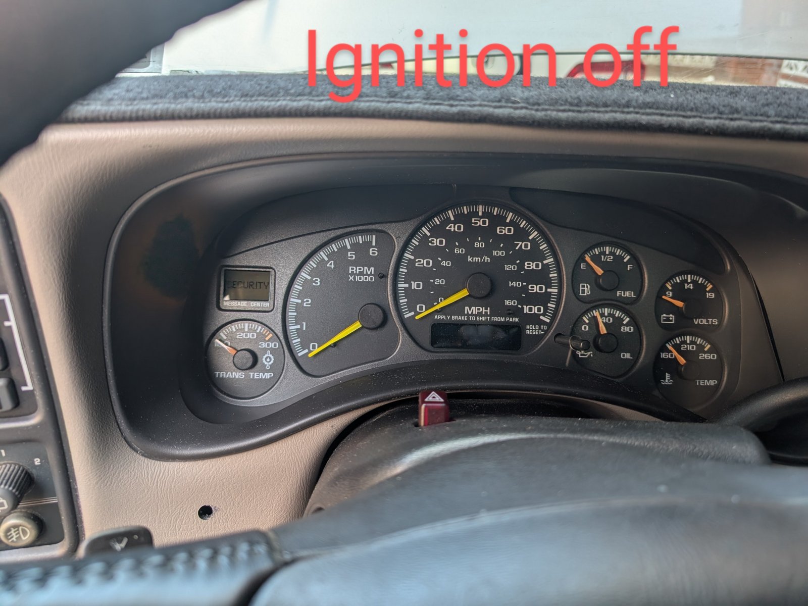

Finally gas leak was fixed. Expensive , but what could I do. I did oil change to a full synthetic, just because I didn't know when the last oil change was made. And what kind of oil was used. Now my oil gauge is throwing less then 40 on a dash. I added a quart of same oil high milage. Nothing changed. When idling it's less the 40, like half. When accelerator applied it's almost 40. What might be a cause. Oil level is top. Can't add more.

What brand and exact filter did you use? I’d try switching to an AC Delco or Fram Ultra. And what brand of oil/viscosity?
5w30 full synthetic. Brand I don't know. I did it at Aamco. I noticed this after I tore dash apart. Can it be that I caused that problem? I replaced cover for gauge cluster. But I couldn't remove connector , so I had to wiggle it a bit.
P.S. I added some pictures.

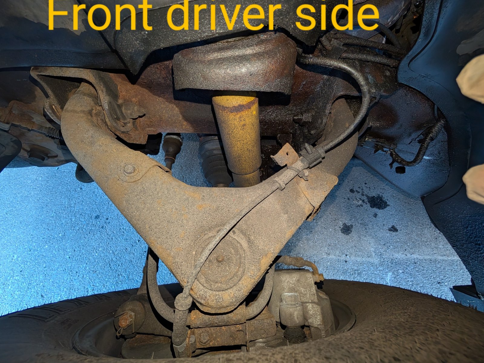

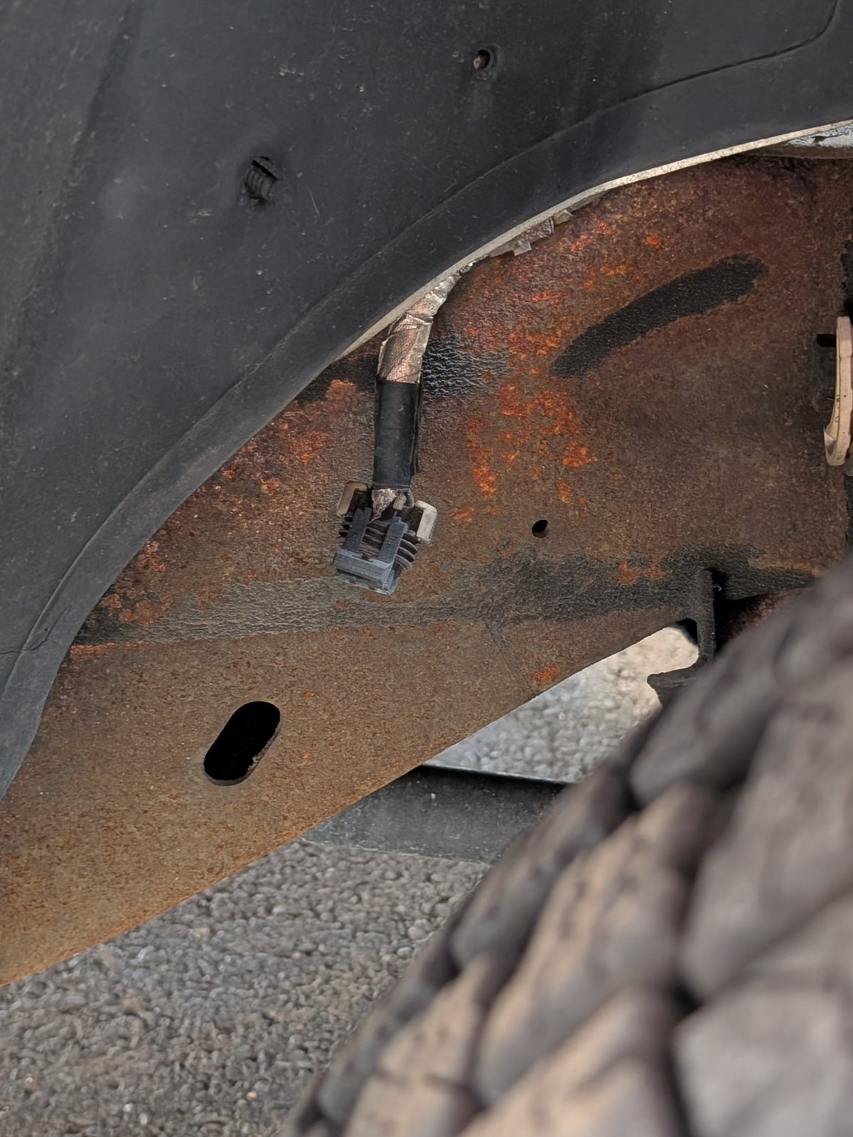

As per ABS. Is it supposed to be like that?
Looks like I don't have wheel speed sensor on passenger side at all.

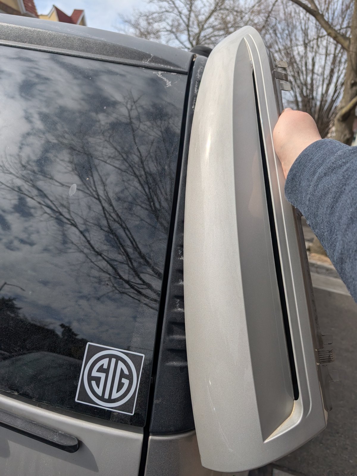

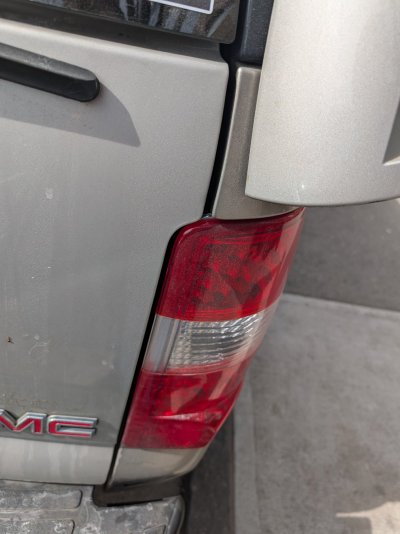

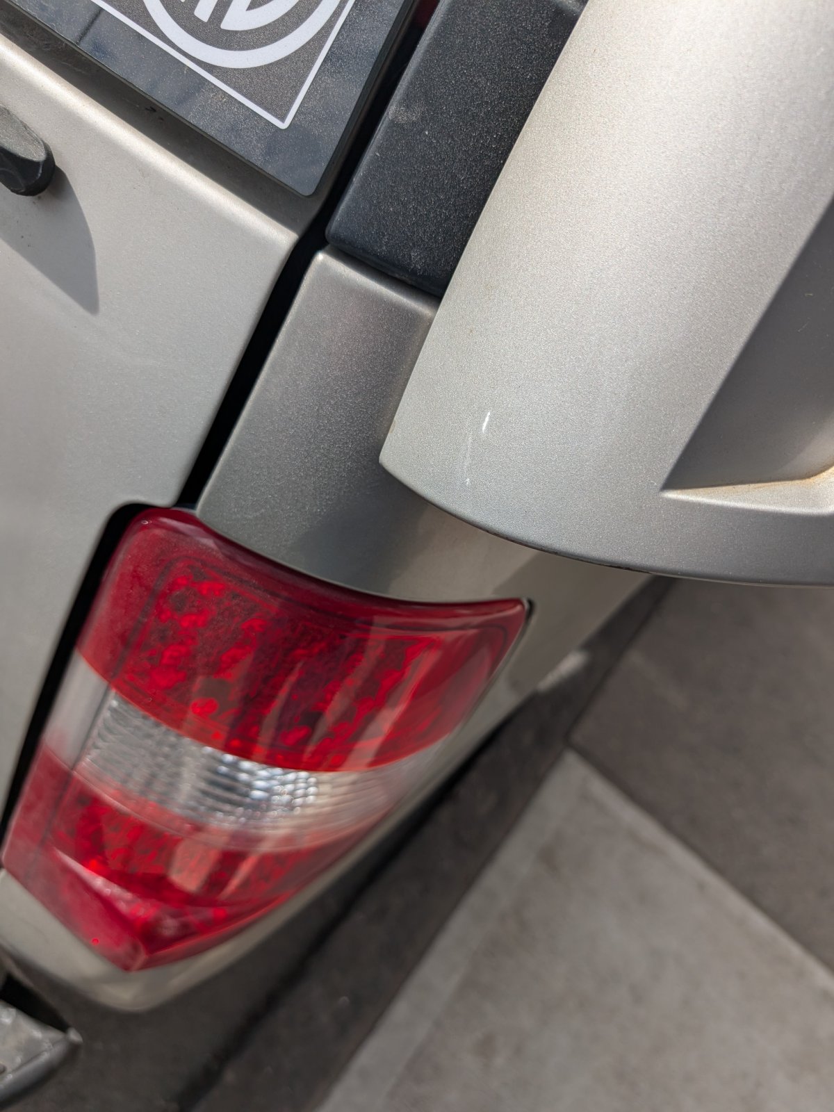

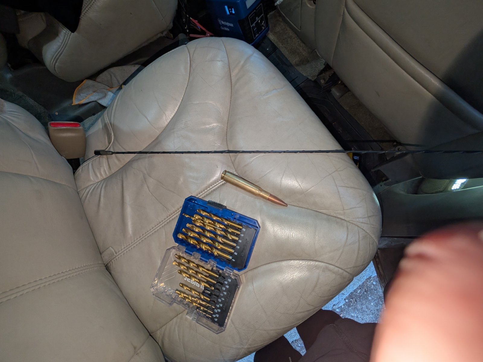

I decided to marry factory antenna with 50 bmg. That what come out. Later on I will find some plastic to cover a thin leg.

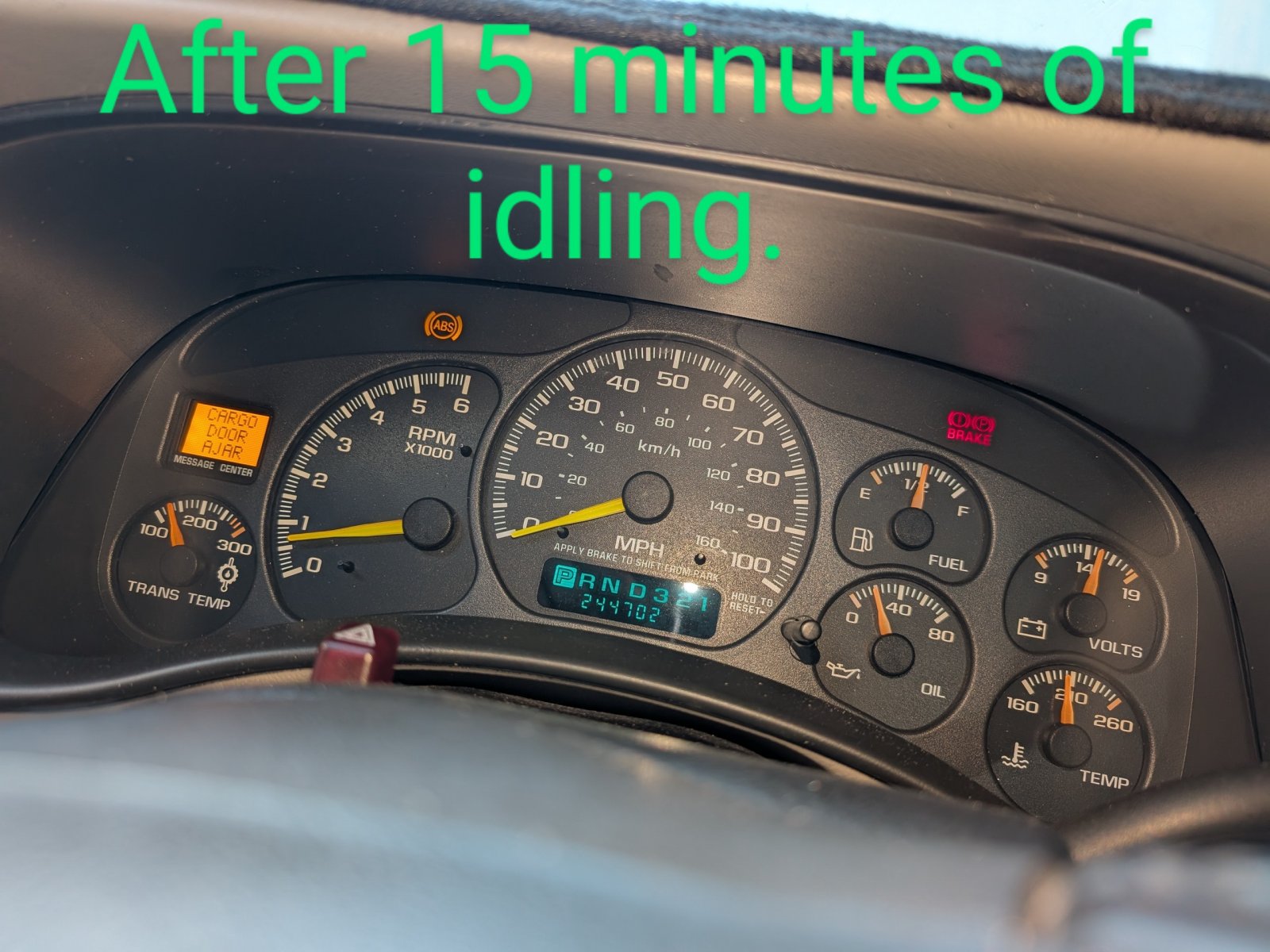

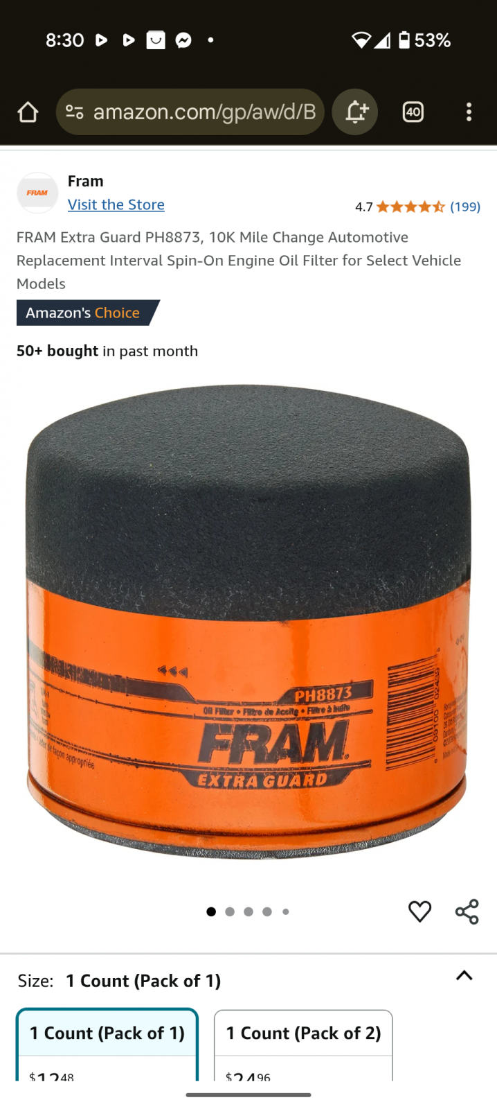

Ok. Still same thing here. Cold start gave me oil pressure 40. After idling for 15 minutes it dropped to 20. But the funny thing is that I saw pressure of 20 when engine was cold and not running, ignition off and truck was locked. Bought a filter Fram and will do oil change again for regular oil non synthetic. By the way, oil was changed a week ago and it's already dark. I think it dissolved some sludge.

Has the cluster ever been rebuilt? Sounds to me like the oil pressure stepper motor needs to be replaced (but do them all while you're at it). The OE stepper motors do go bad, common issue in these.
Lots of YouTube videos on cluster repair.

Make sure it’s the Fram Ultra. The regular Fram isn’t all that great. The Wix filters are great too.

@makintoshnex, did you have the oil pressure checked with an external gauge?

I'll correct my wording -- I didn't realize this is a 2001. So the motors for the gauges are air core stepper motors.

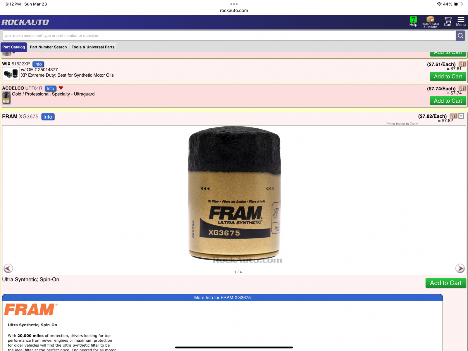

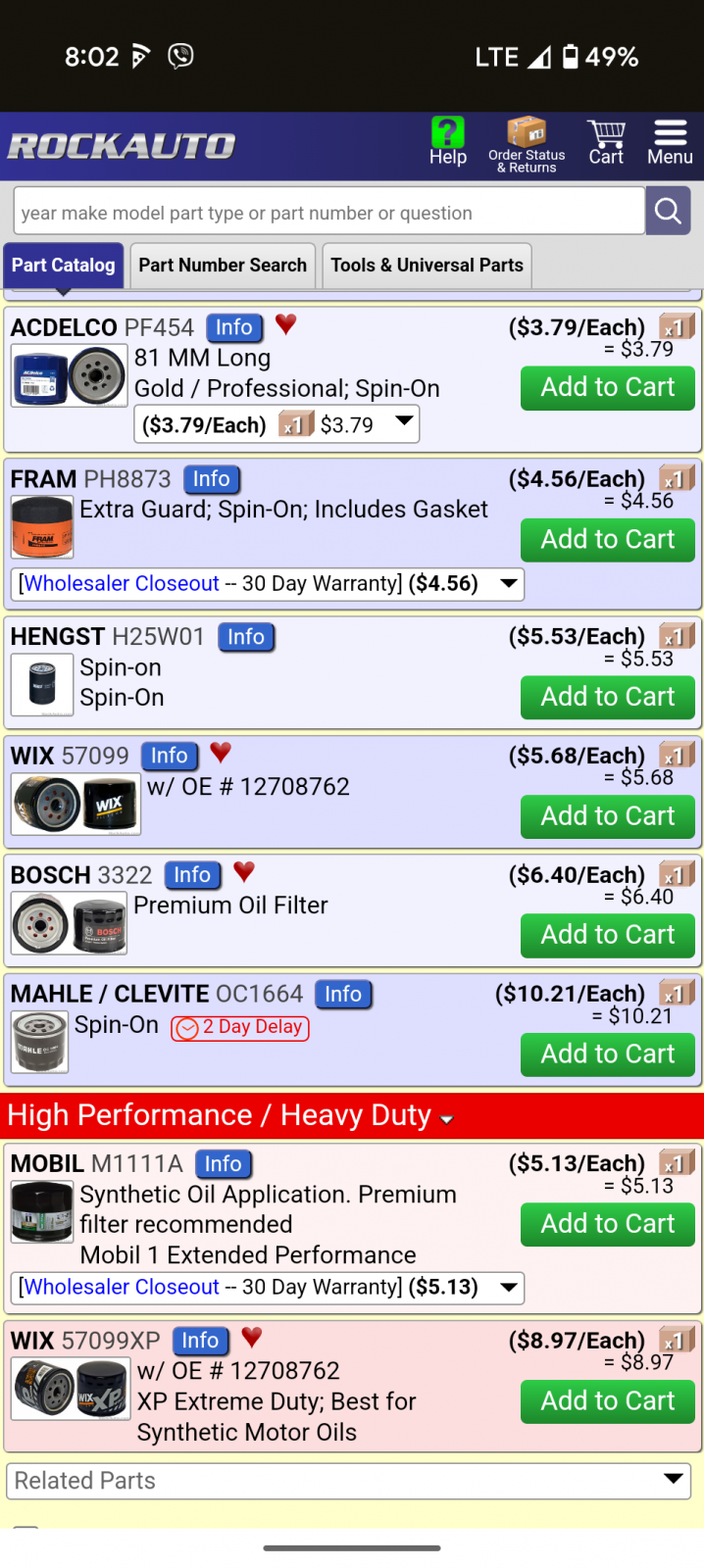

Are you sure it fits. Rock Auto doesn't give me it for 8.1
I don't think @Rocket Man was saying that specific filter would fit your engine, but just the correct "ultra" one for your application. Maybe FRAM doesn't make an Ultra for your engine.
I didn’t know you had the 8.1, my bad. I don’t see the Fram ultra for that engine. I’d go with a Wix in that case. Either their standard for regular oil or if you’re running synthetic oil, their XP. I see your engine type in your signature now.
I didn't thought about signature. Sorry my bad. I see as engine warms up oil pressure is dropping. I'm watching it live. For 1 minute it dropped to 30 . As I reved engine it jumped to 40 and then back to 20. And it's ticks sometimes. Just by itself. I will do the following. When I had old LADA i washed engine. I used cheapest oil and a good filter. It washed sludge, and then I was pouring premium oil and premium filter. As far as I saw, full synthetic oil washed some sludge and now it is in oil filter and is blocking flow. So I will drain, get K&N filter from AutoZone and cheap half synthetic. Run it for 500 miles and then full synthetic Mobil 1 and a good filter.
