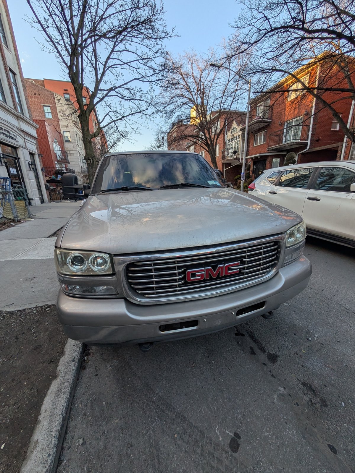

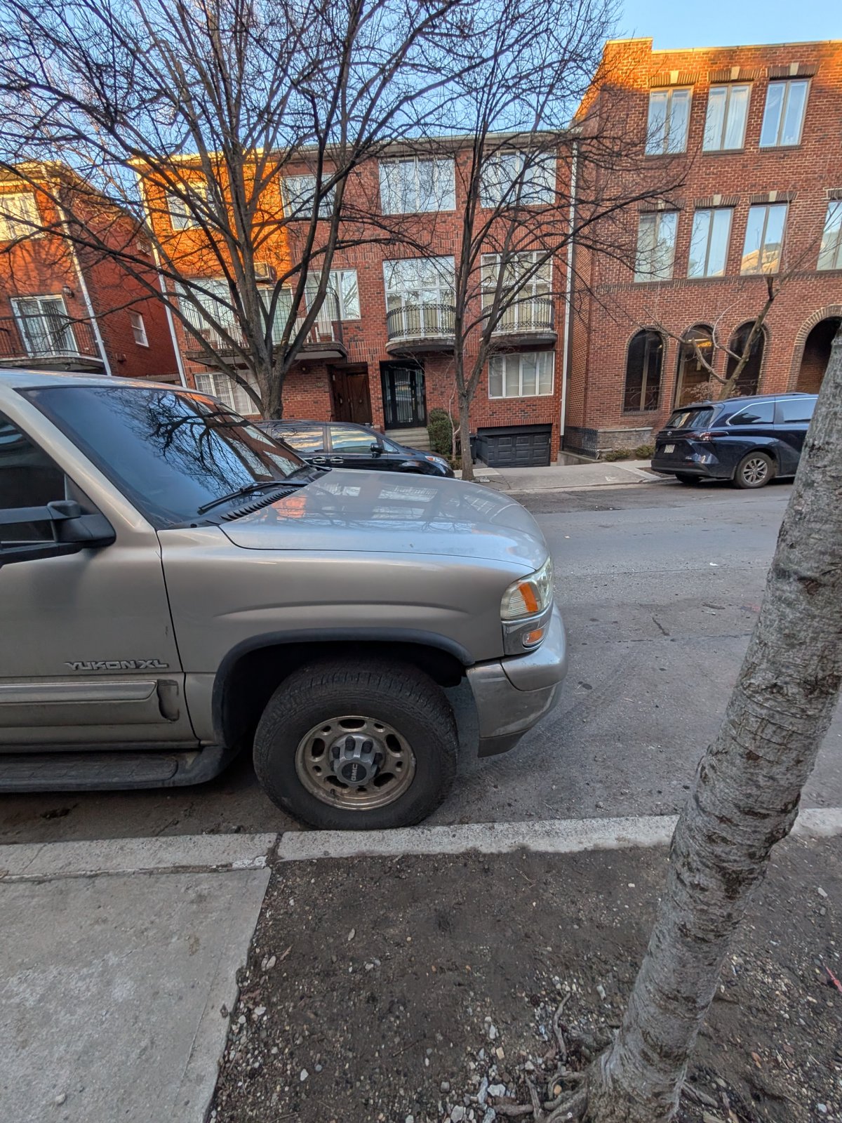

Here is my "Beast " it's not the best, but it is what it is. 2001 GMC Yukon XL 2500 all original for now. Seats and frame in great condition. Body has some damage from rust, but previous owner did lots of job to a body And truck itself. I purchased it 2/1/25 for $2800. I think it worth the money. Beast has 244345 on odometer, the only code is for abs, because of speed sensor. Engine eats some oil from time to time. But nothing serious.

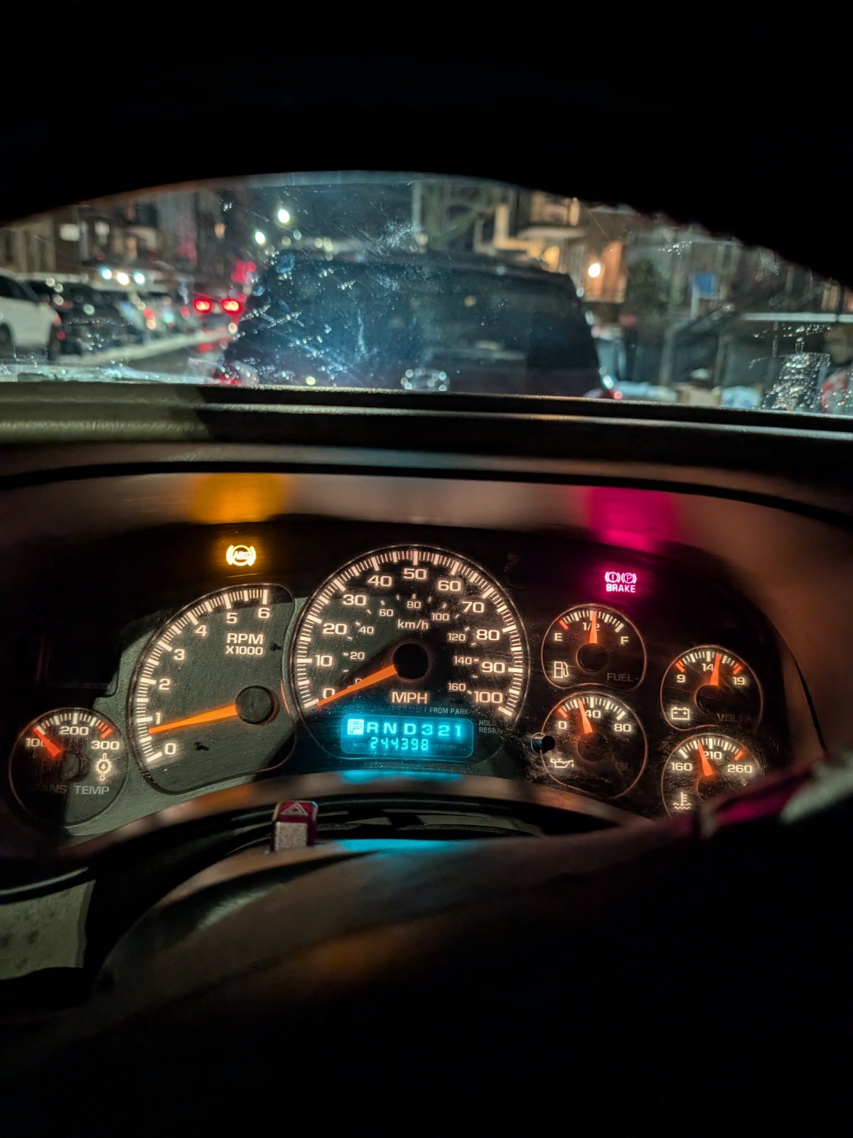

So far I'm looking for 8x165.1 wheels but nothing comes under 1 k. So I will wait. Also park brake light kicked in. It glows steadily not flashing. Maybe bad ground? What you guys think. Also question. This truck is higher then regular Yukon from factory, looks like it is 2 inches lifted. Can I fit 33 wheels without lifting it more?

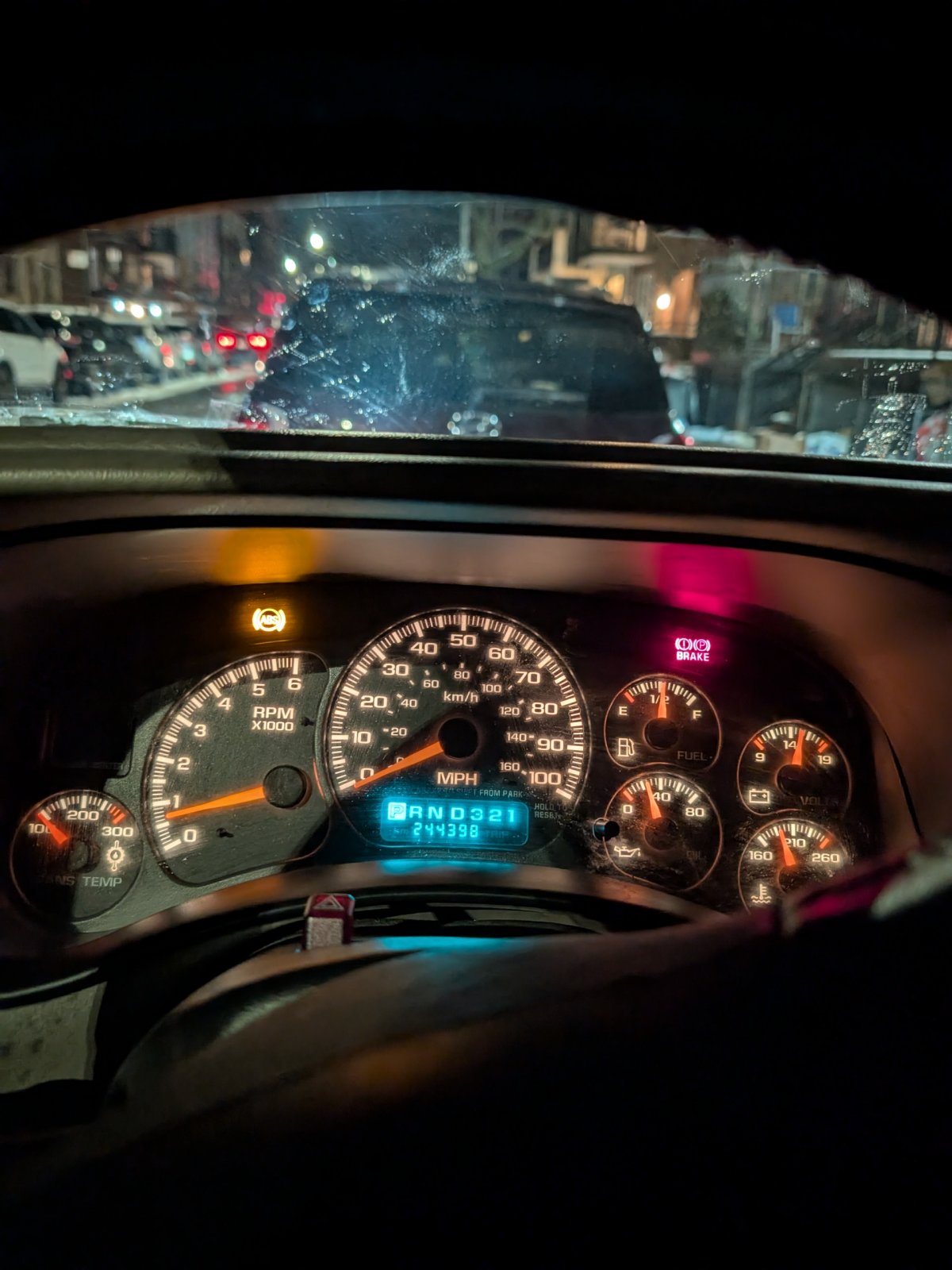

Still can't get rid of those lights. ABS is because of speed sensor on wheels , but park didn't go away even after I did grounds unde driver side. I'm quite scared to take it to highway in this condition. Brakes seems to working. But I'm a little bit you know

Could be as simple as the brake light switch. How is the fluid level? Keep an eye on it in case it’s rusted and leaking lines.BTW nice name; check out my build thread, link in m signature at the bottom of my post. ( The Beast one)
Brake Fluid level seems to be ok. Brake lines were replaced by previous owner for stainless steel and fuel lines are nylon.

I had the same lights/issues except mine was not due to speed sensor. There is an ABS module on the driver frame rail (I think it’s driver, if not it will be on passenger side lol) and these modules are known to go bad. They are a bit tricky to get out if never replaced but are not hard. Find a good used one, usually about $50-70 if I remember correctly. When the module goes bad both these lights will come on.

Scan the truck for codes, but the brake/abs light are likely the EBCM.
I replaced the EBCM on my 99 Silverado last year, after it went out and I had been driving it like that for like 2 years, but only got driven occasionally.

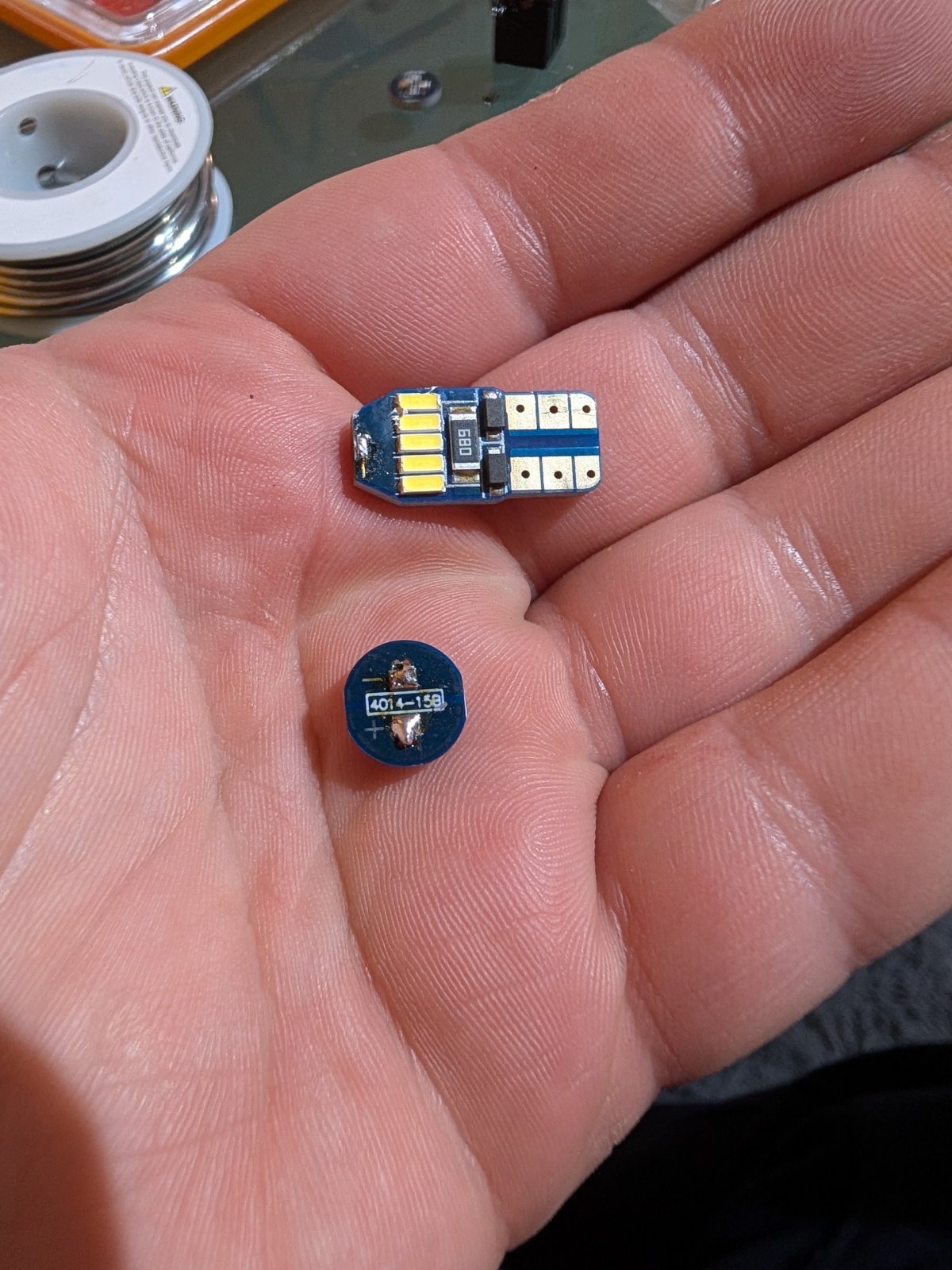

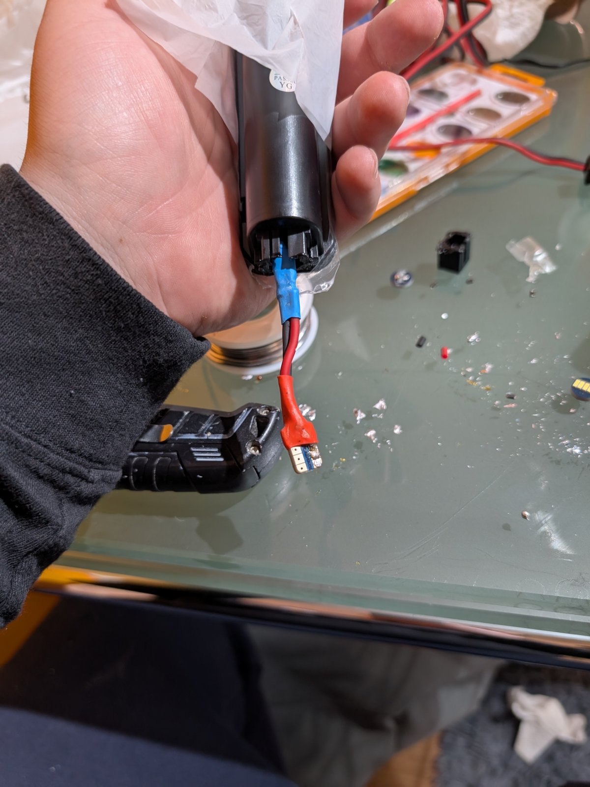

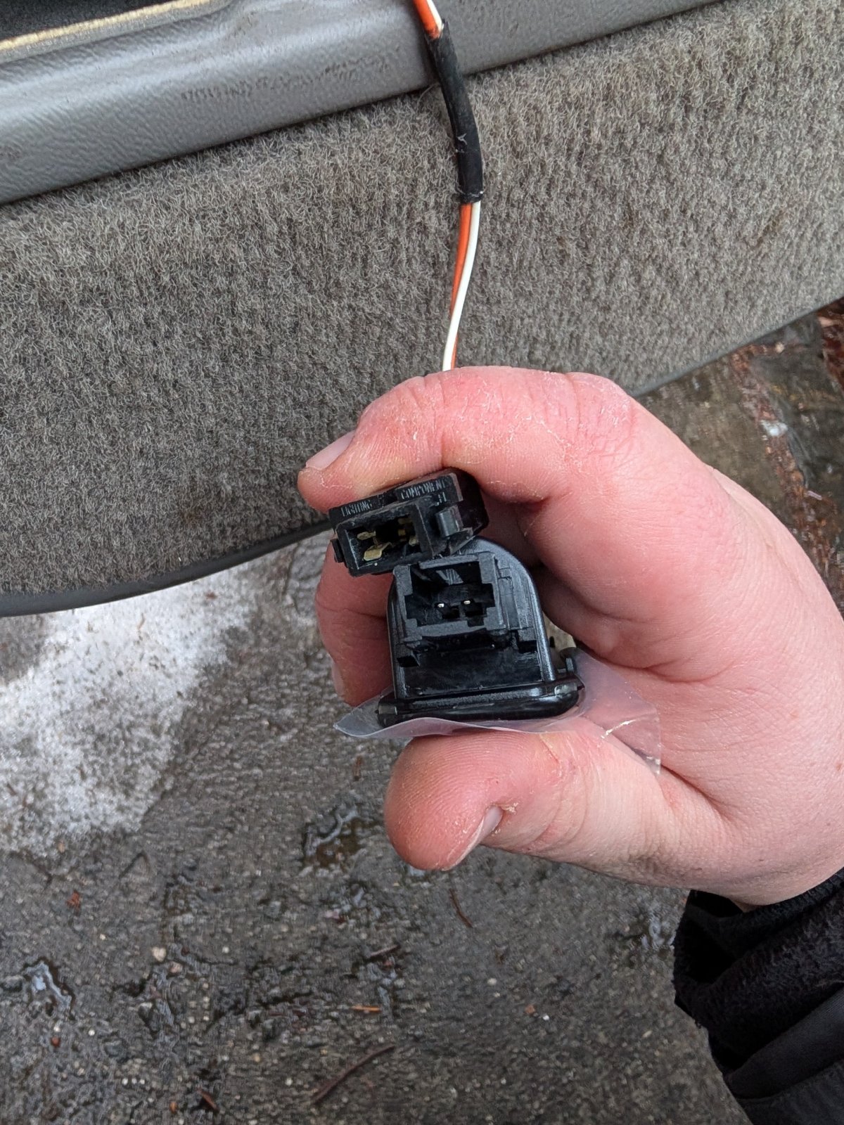

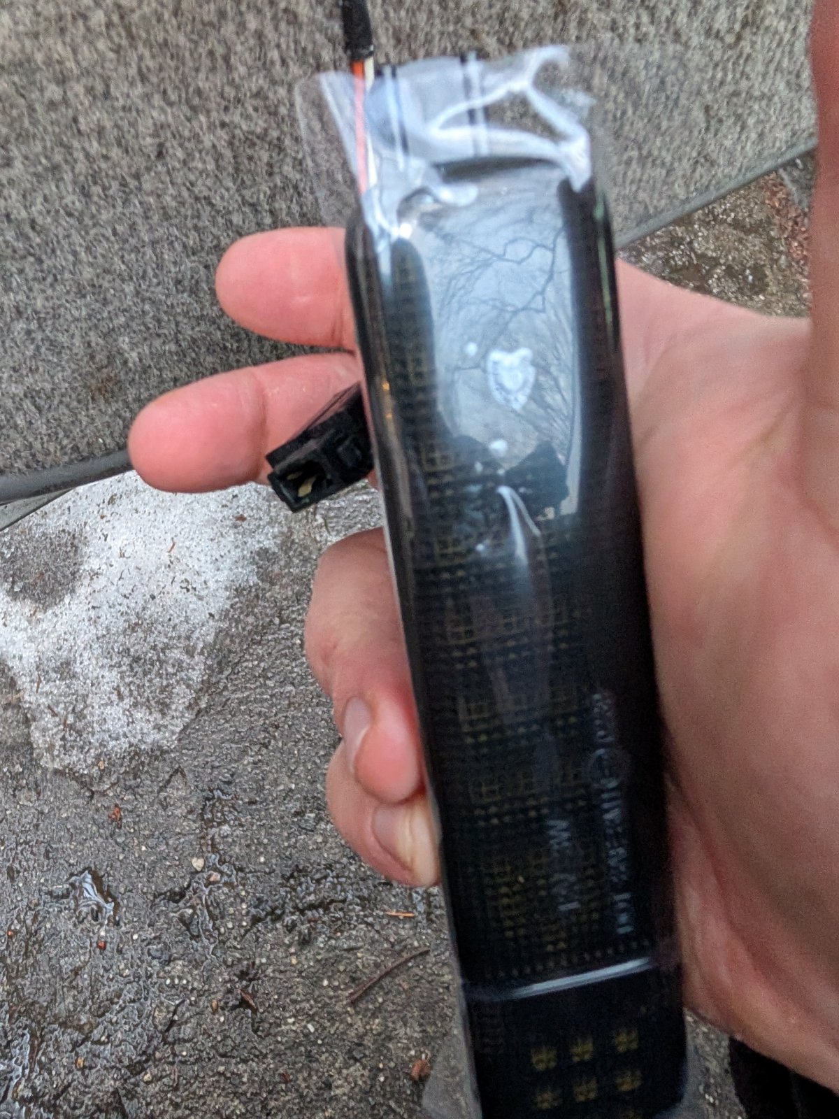

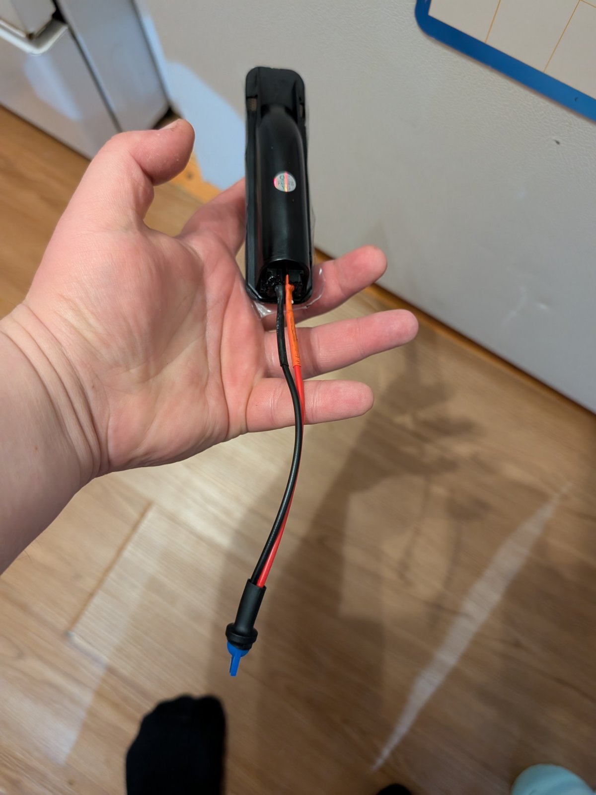

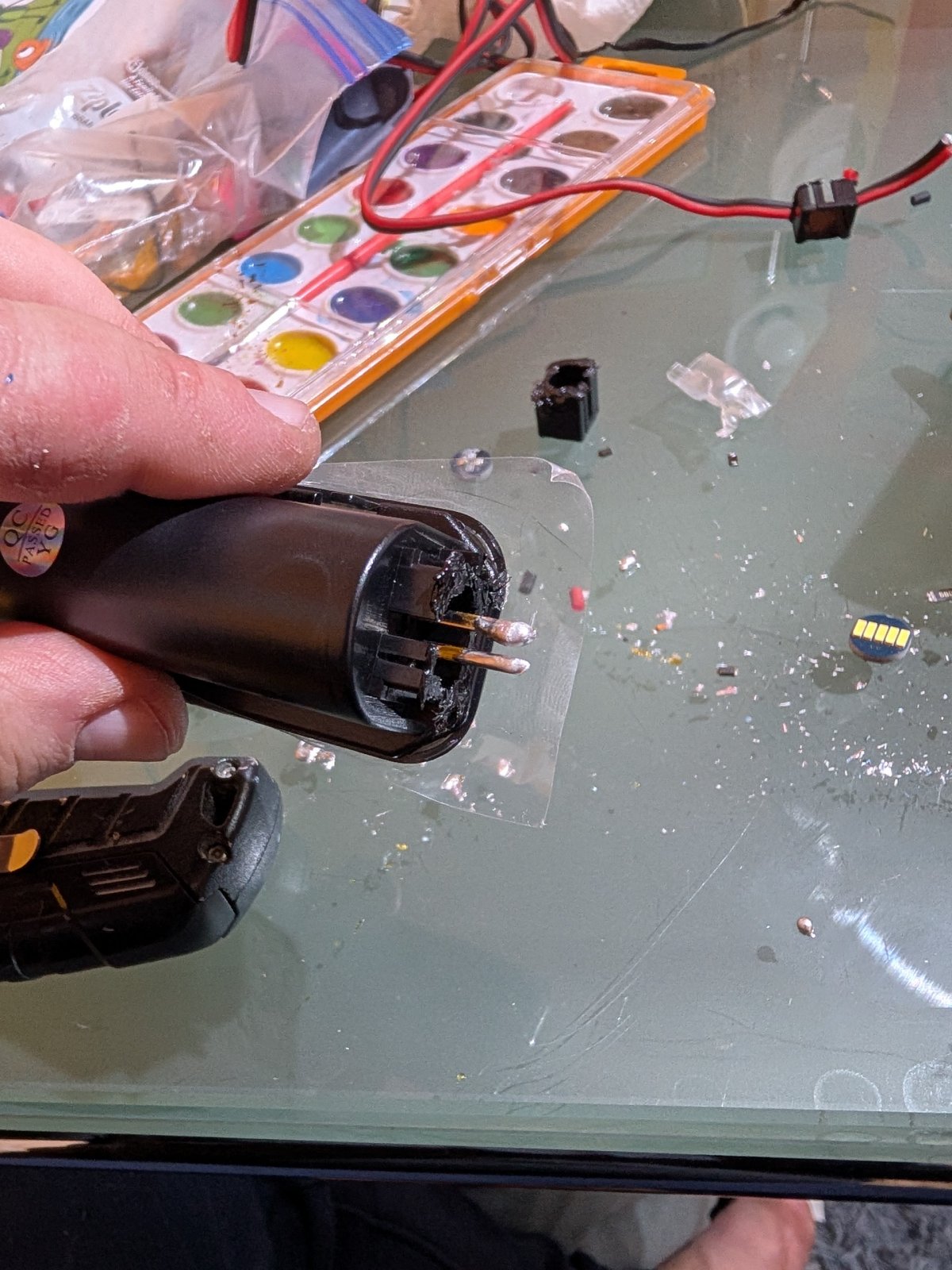

I decided to swap factory door courtesy light. Into eBay A.K.a AliExpress ones. I don't know who designed those ports, but he definitely doesn't know how it should look like. So I came out with solution. I had expired LED. So I decided to use their board as a terminal base. Here how it came out. Unfortunately I am missing 2 LED, because I managed to damage them beyond repair. Results are great.

Just found these male t10 connectors on Amazon. Hope they will work better than my makeshift

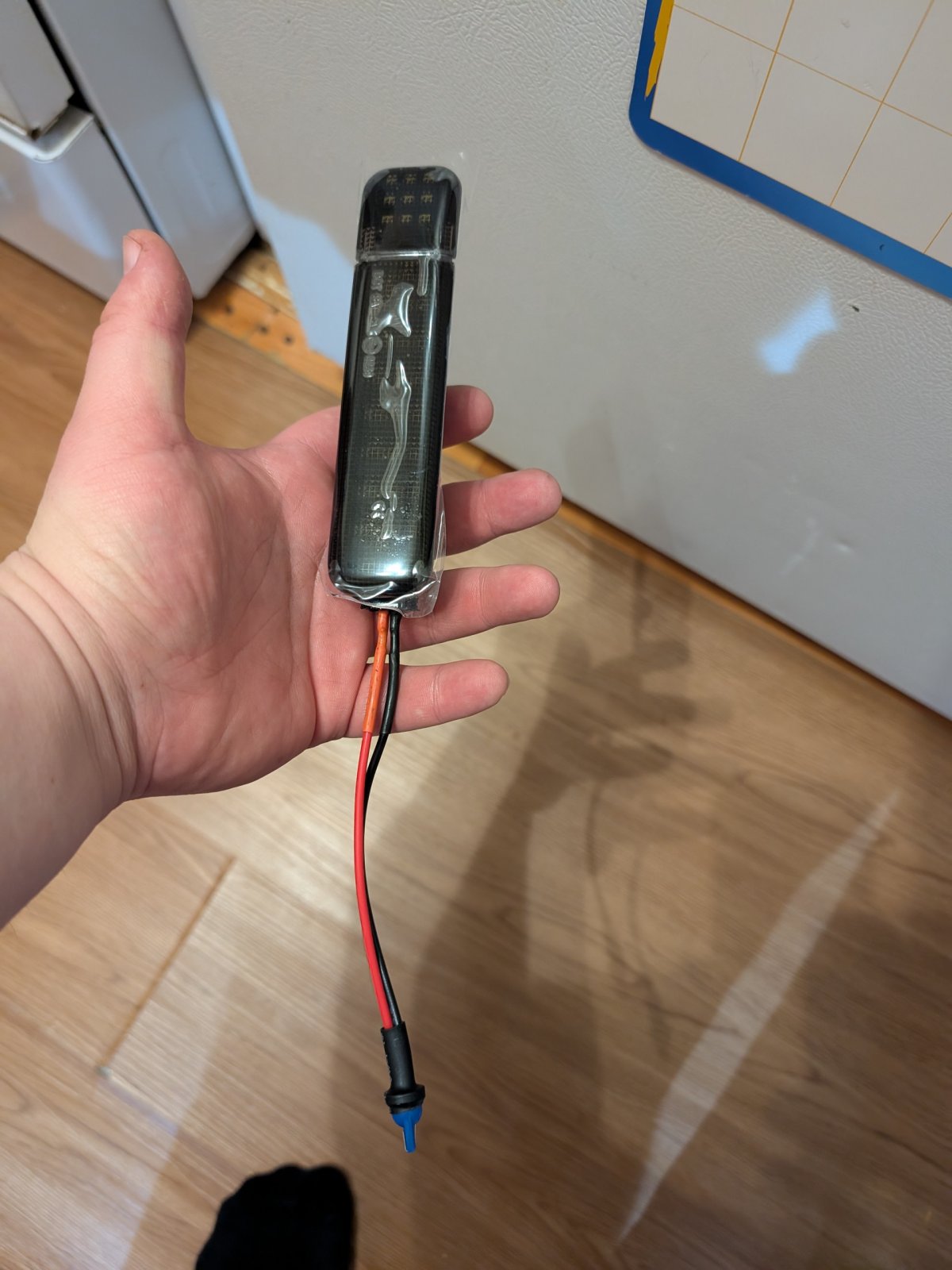

Yes, it has same connection as mine. And I assume I would have to do same with yours. I finished mine and they came out pretty good, almost factory style. I think I left too long wires, but who will see it inside of door.

No, there is no messing around with the ones I bought. Plug them into the factory wiring, pop em in the door. 3-4x the amount of light as factory style with LED bulbs swapped in.
