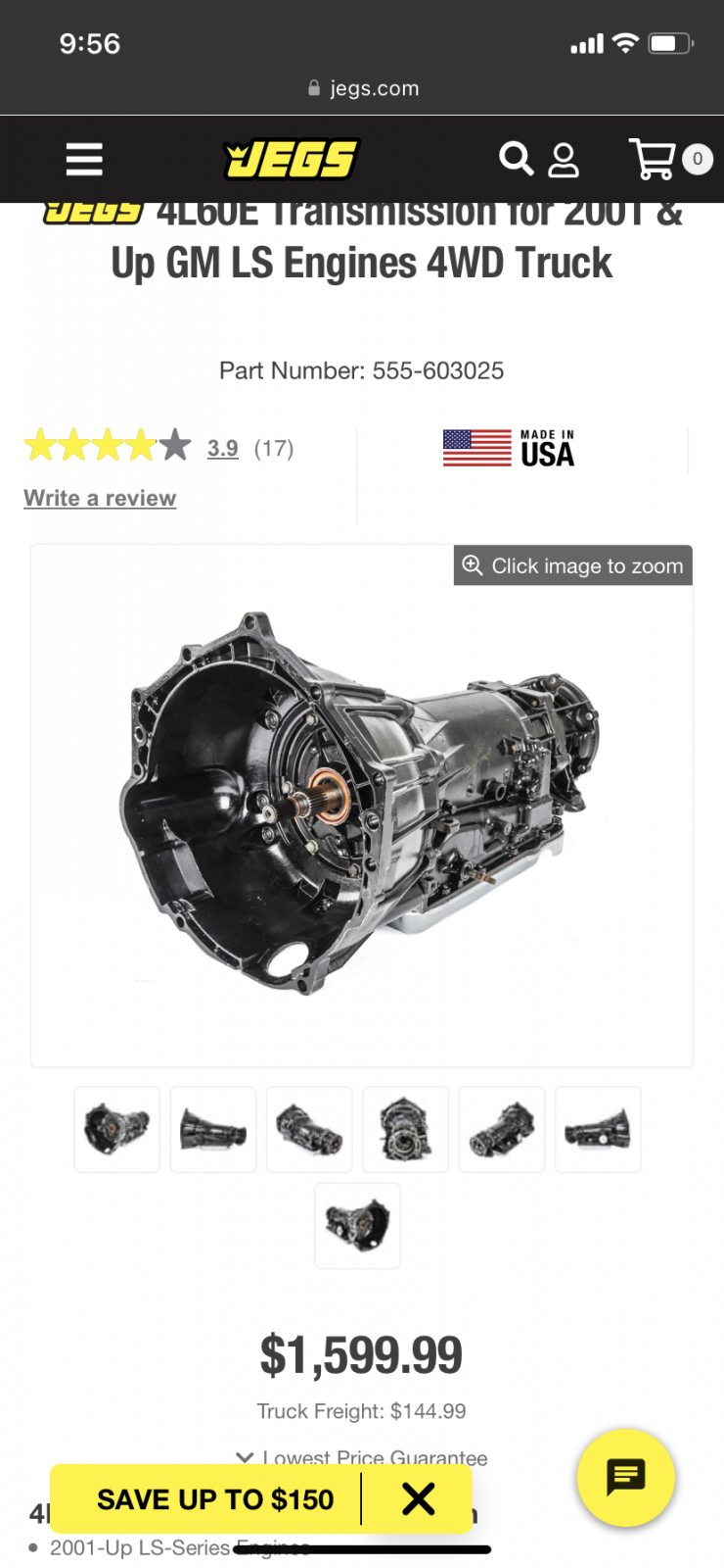

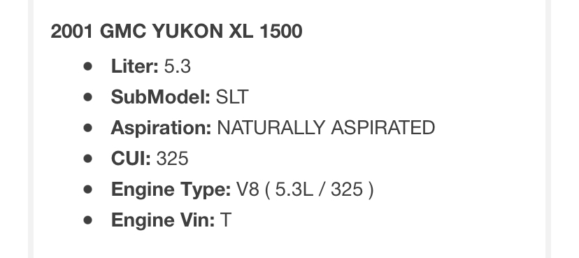

This is what’s gonna go into mine when it blows itselfView attachment 395301View attachment 395302
I’d be willing to bet you can do a lot better for that amount of money locally or match the Jegs 4L60e specs for like $400-500 less when you factor in Jegs freight shipping. If you want specifics, I’ll spec it out…meanwhile check below for some ideas…
Thank you for the info I appreciate it!!
Is your truck’s engine stock or mostly stock? Is is used for any serious duty towing/hauling/working/off-road? How much power (approximately) will you be adding to the engine? If going north of 650 hp, id do an 80 swap with a billet rollerized fwd hub and rollerized output shaft.
But if keeping it around 500-550hp or so, building a 60 using 4L65 parts (planets and forward drum from a ‘65E) with a good shift kit, Sonnax Smart shell and boost valve kit, 4l70e reaction shaft, wide Alto red or kevlar band, delete 4th accumulator, pinless accs in 1-2 and forward, and either Vette or billet servo for second gear is sufficient.
