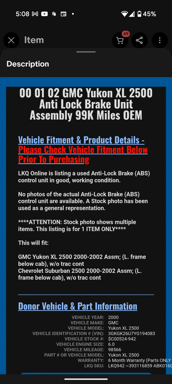

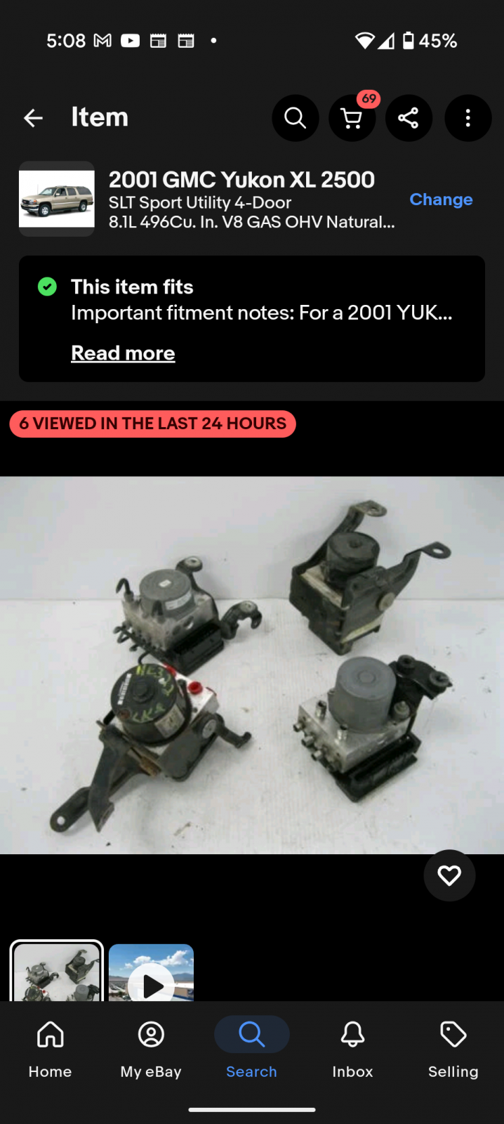

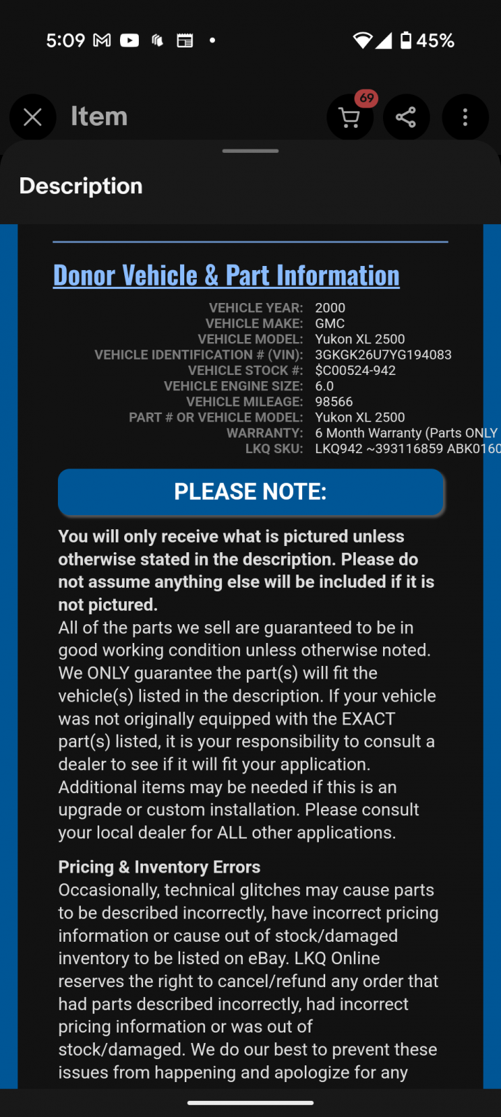

I found this ABS assembly what you guys think about it? I think it comes as a whole. I will take it apart, solder and add thermopaste rtv glue it and give mechanic to install. I got a gift card from company on $200 this should be enough to cover part.
I think this is a good dice roll. You get a lot of good extra parts too.

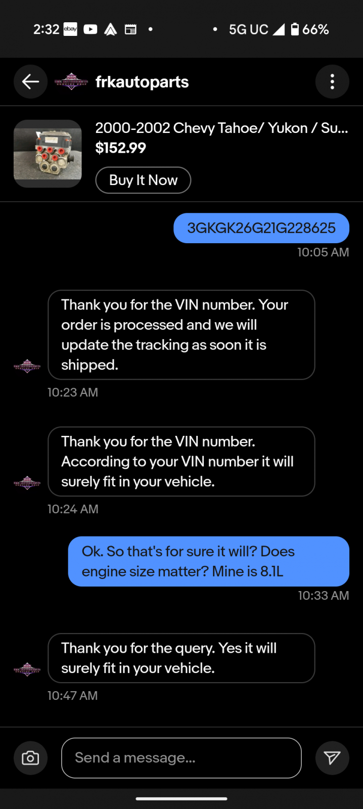

Unfortunately that seller doesn't respond at all. I found another one but that unit is from 2000 suburban 1500. I have my vin to a seller, he confirmed that part fits to my 2500. Does it really matter?
Eh… not sure. I would cross check the part number on advanced auto or another parts site to see if it is truly interchangeable. I am not sure.

You are right. I don't know what database seller is using. But he is right, also I found some other sellers that told me same thing

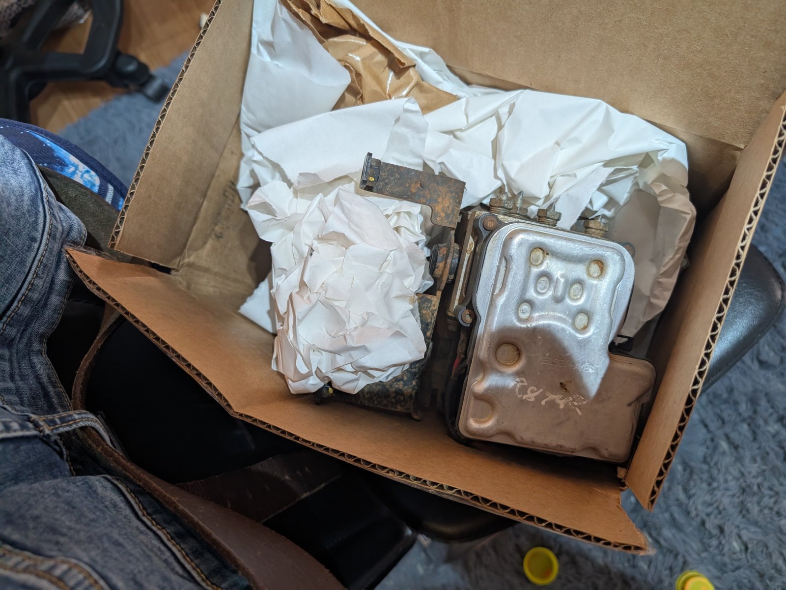

Can someone explain me how it works. If I buy a ABS unit from same vehicle, do I have to reprogram it? So far nobody can tell me. Some shops say yes you have to, some say no you don't just swap it. Some say oh let's repair yours it will take a week, price is relatively same , everyone is asking for around $500. But I'm on a crossroads what should I do?
Personal experience: No programming needed. If the unit is for a GMT800 Sub 2500, it will work.

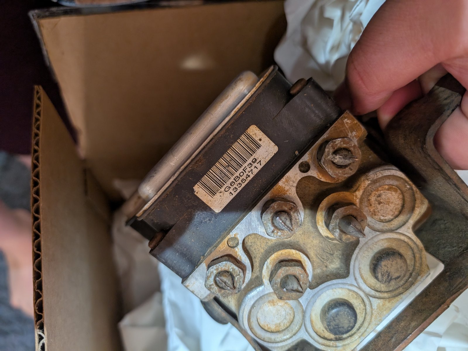

Just received a unit. Looks not bad. Currently on a process of opening a cover.

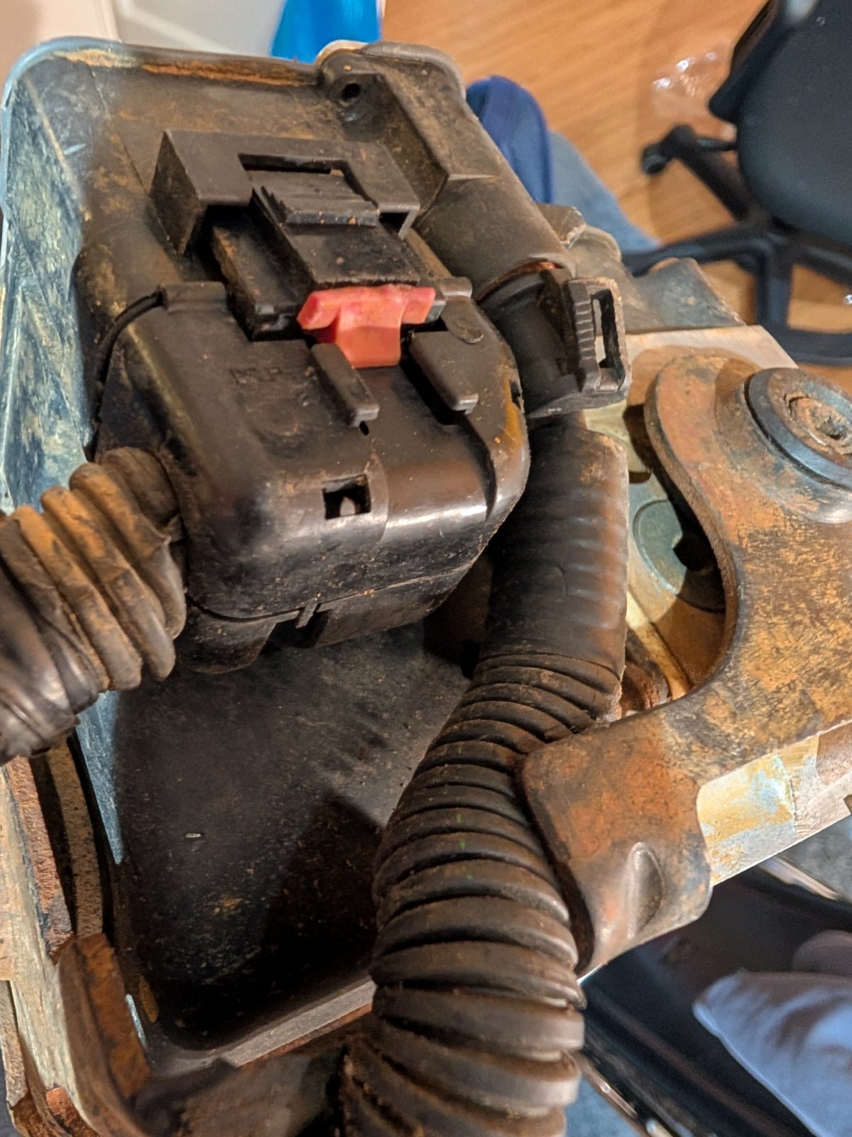

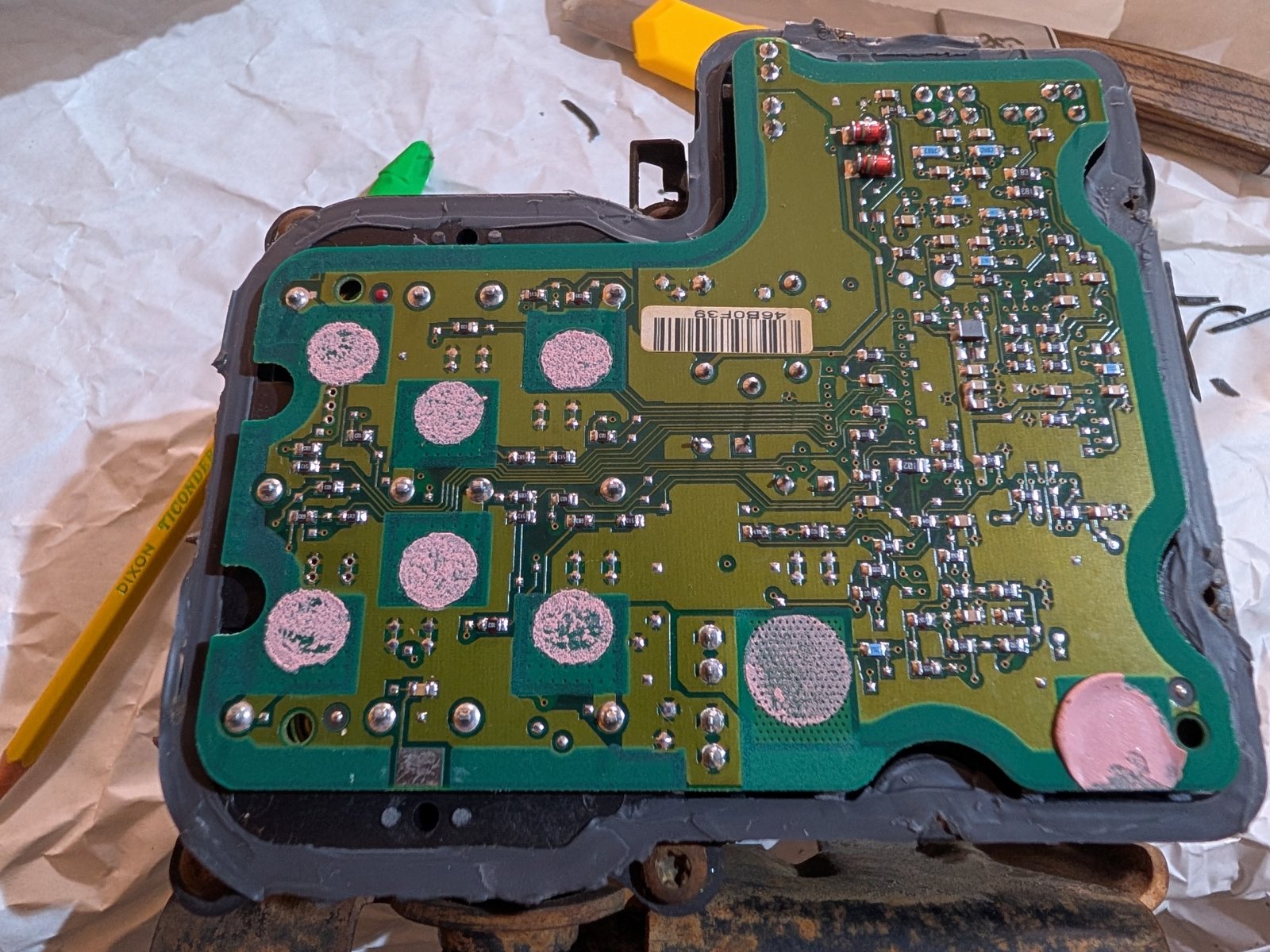

I opened it but I don't see any bad soldering or some stuff like that . I will add new thermopaste and rtv. This unit looks solid..came out from 2500 2000 suburban 8.1L

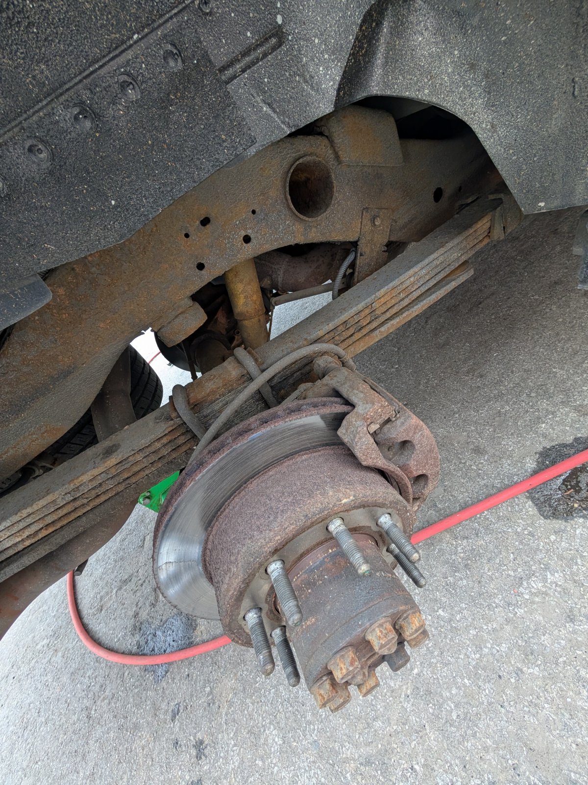

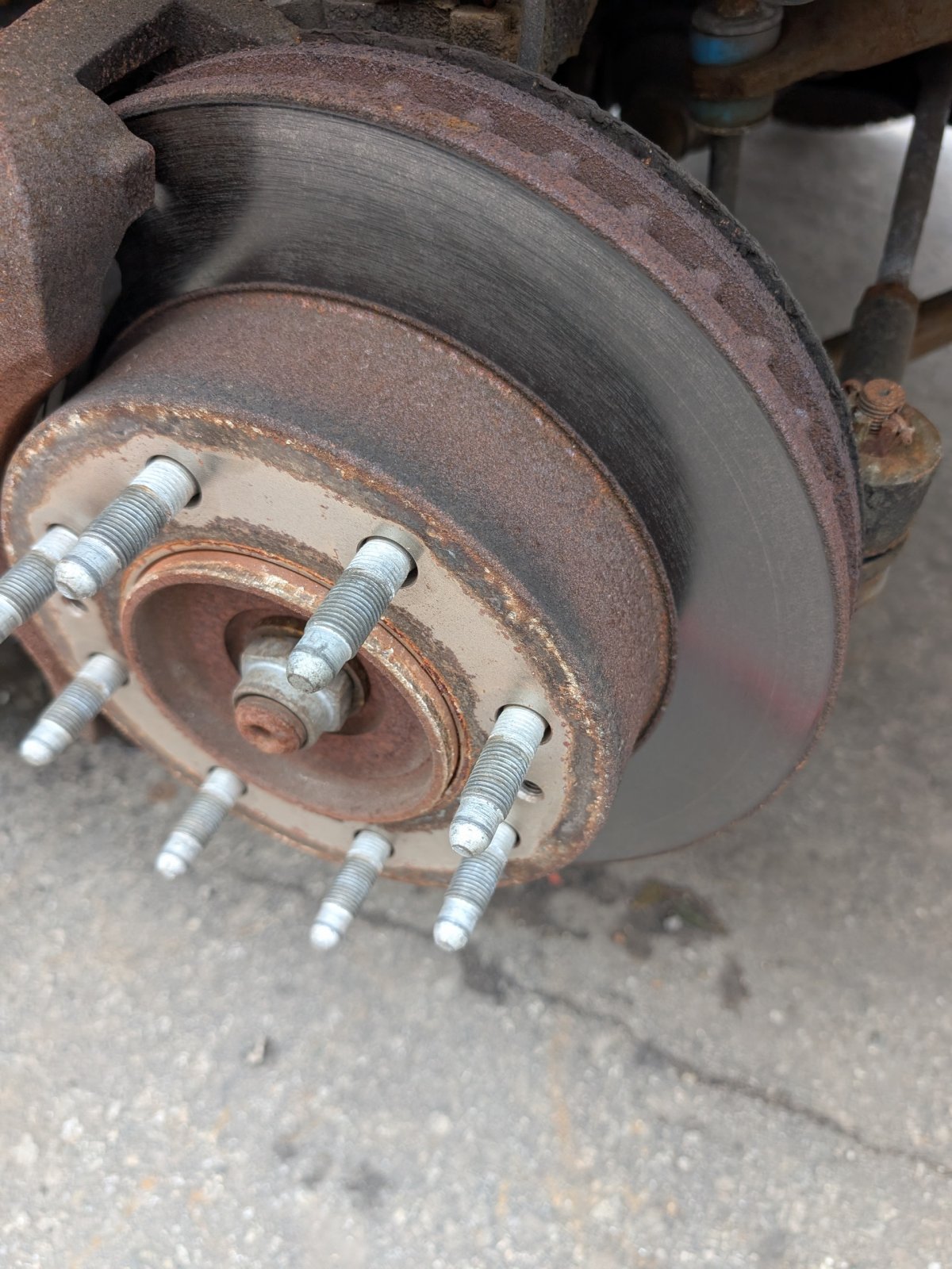

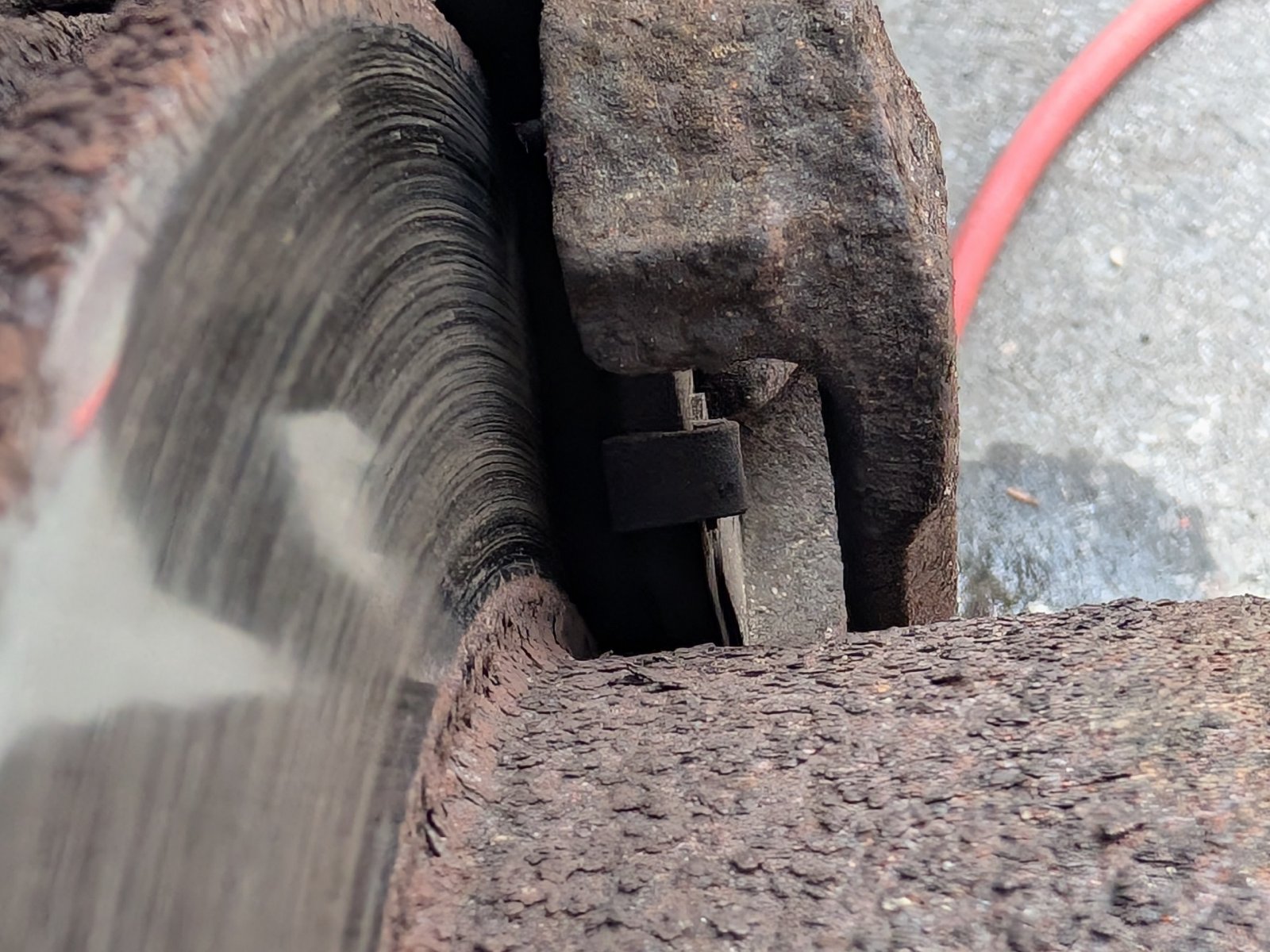

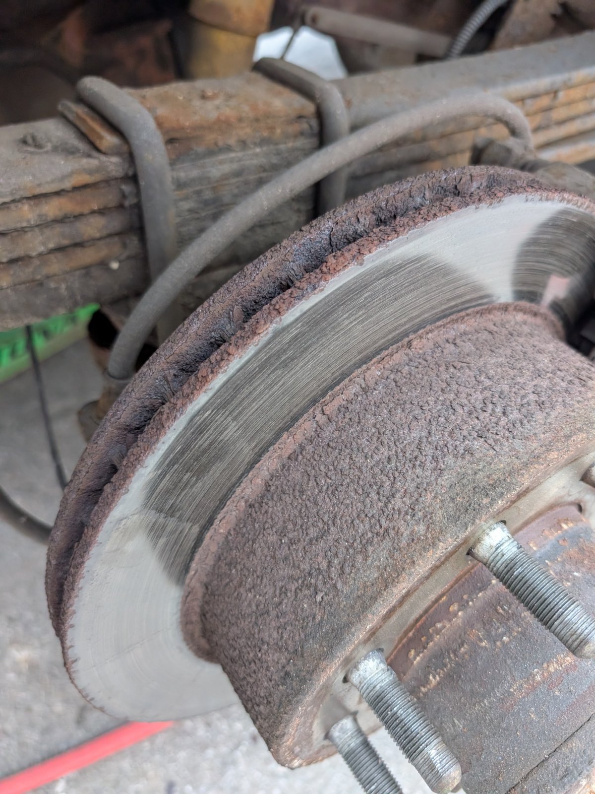

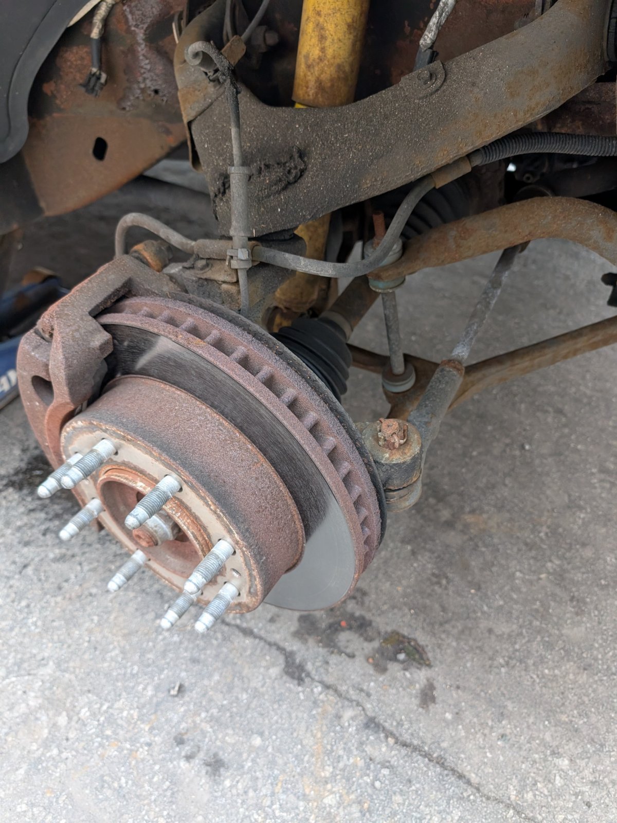

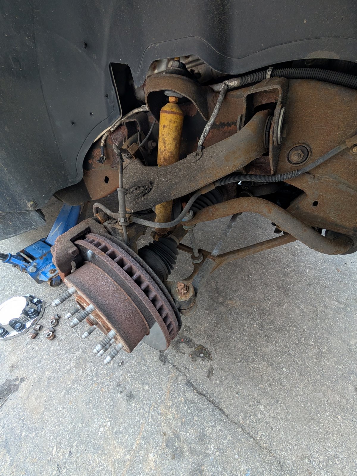

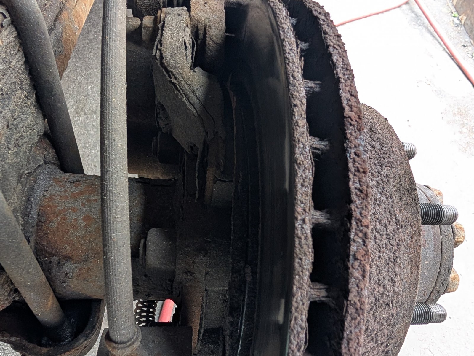

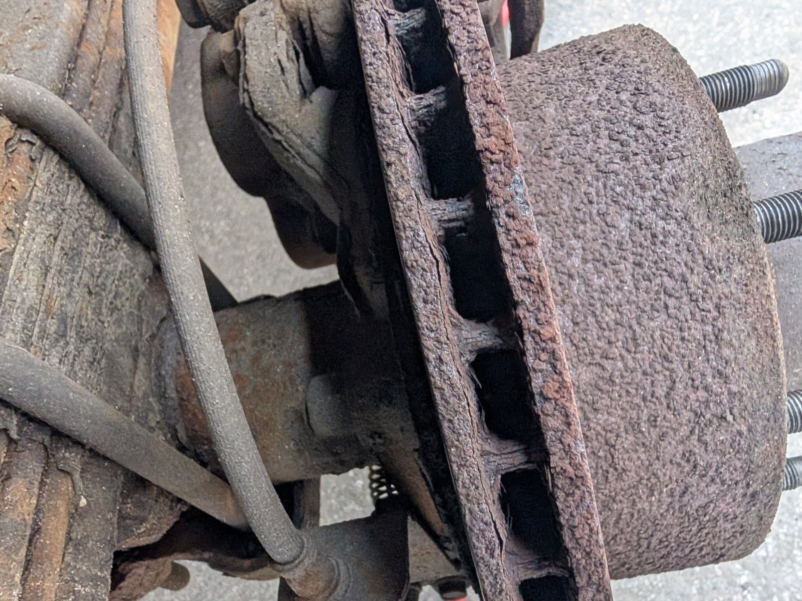

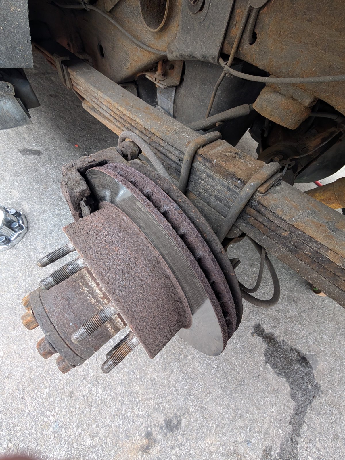

I installed TpM sensors today and did Ballance, while tires were out in a shop I took a peak on rotors. What you guys think. Should I replace them or they are ok.
After balancing truck drivers even better. Not shaking anymore. Abs light is still on, but it comes and go. Sometimes I got no codes and dash is without ABs and brake light, sometimes it's on randomly.
Rotors look crusty but fine. Do they have grooves on them or have a lip on the edge?
The pads might be aging a bit and need replaced but also not a great angle.
Did you install the new ABS module? All in all, there doesn’t seem to be much frame rust which is GREAT!!!
No, no lip, light Saturn rings but nothing deep. Probably I will go with brake pads replacement. And I haven't installed ABS module yet. I want to do everything in one shot. ABS module, wheel speed sensors front, new pads. Oil change.

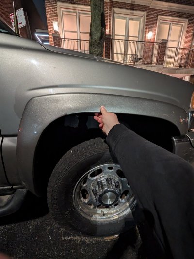

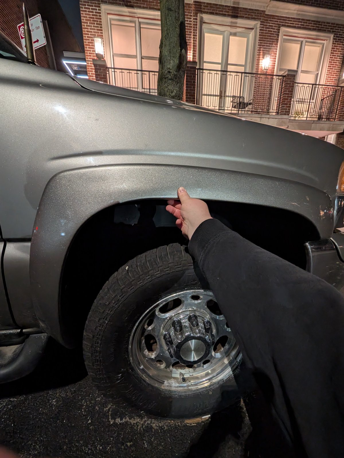

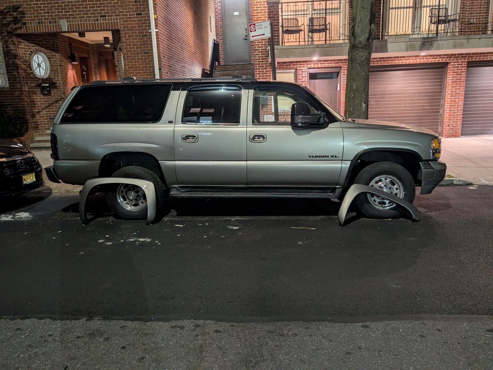

Just picked these from body shop. I think they should be good . Freshly painted.
And currently I'm on a market for Tahoe, or Yukon with up to 150k miles, Southern no rust trucks preferred.
26,678
52,941
Aftermarket?
