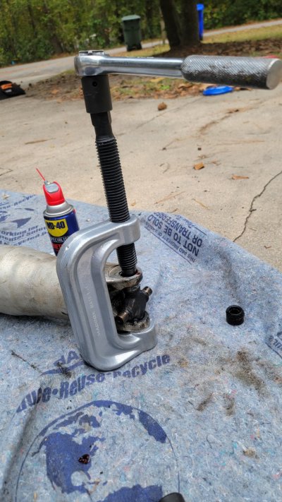

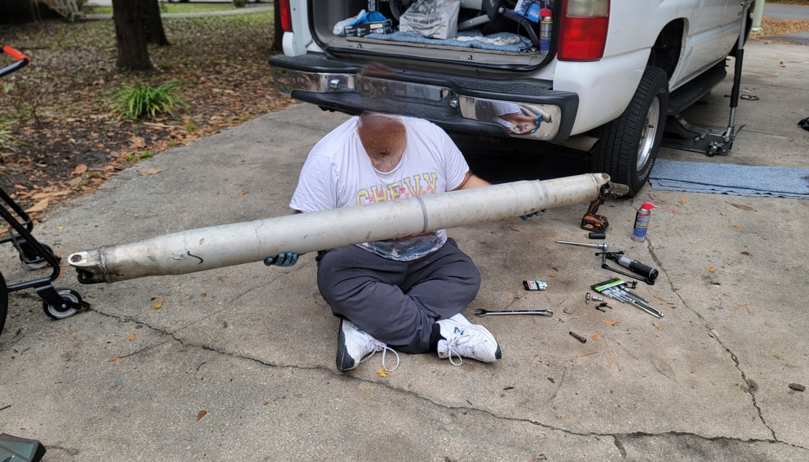

I have a 2001 yukon XL 1500 2wd slt. Had ujoints go on me. Took the shaft out to replace. Easy to get out. Nightmare to replace joints.
My 2003 slt xl 1500 4wd is all steel shafts. I was confused to see an aluminum shaft on a 5600lb truck. Insane. They used to be expensive to manufacture lightweight aluminum for racing that you'd throw away when they go bc aluminum can't hold uo as well as steel. Now it's in this type of application... nutz!

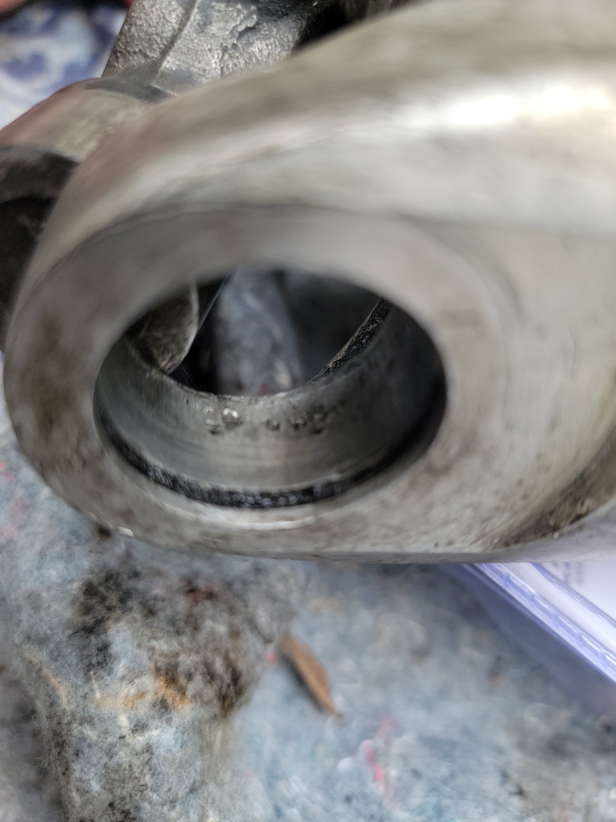

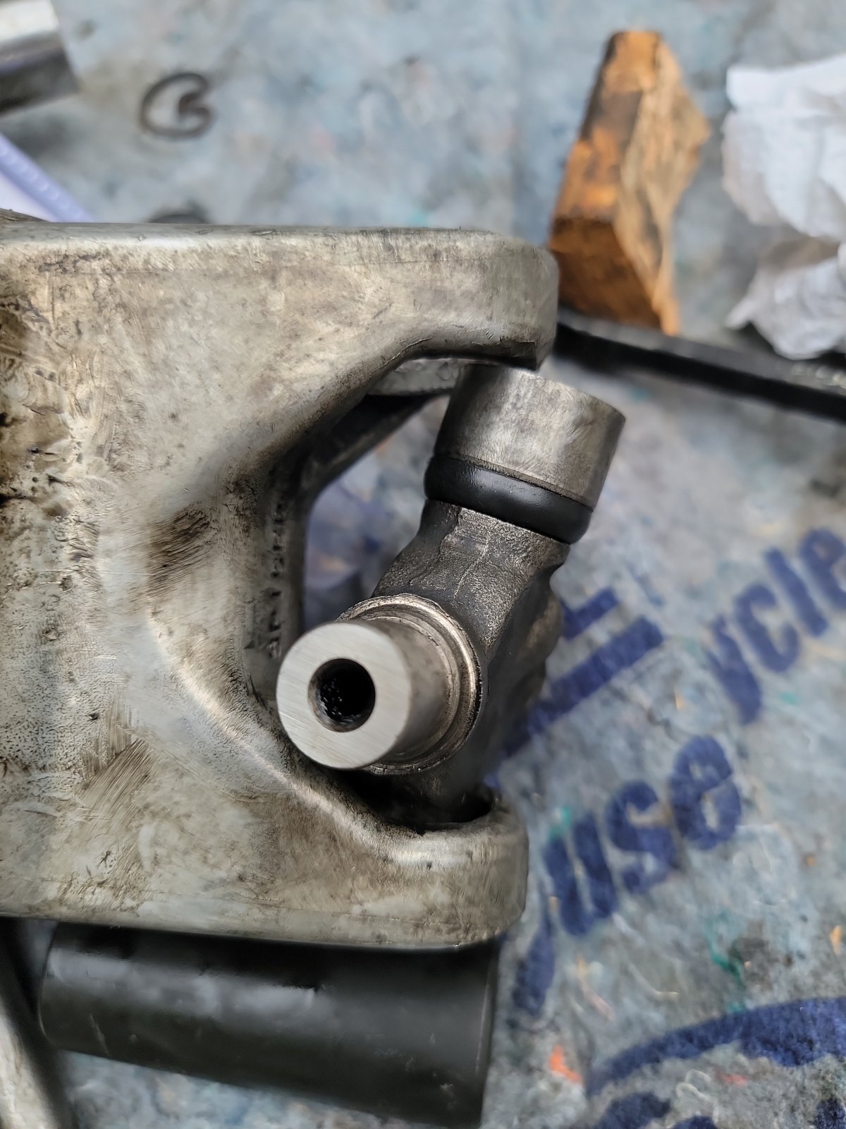

My biggest issue is that I can't get the joint out. It teeters on the edge with one cap released. Its like .01 cm from being free, but can't. It gouged the smooth machine finish where is sits as well. I'm worried about all of this. The aluminum is trying to mate to the steel cap and I'm assuming the aluminum has to be torched first for this to work.

You knock the ujoint caps outwards, NOT inward and thats why you cant get the ujoint out the rest of the way. Use a wrench and quit sweating torque values on a ujoint. Ive never put a torque wrench on a ujoint shackle bolt and have yet to have a driveshaft spit itself out from under a vehicle.

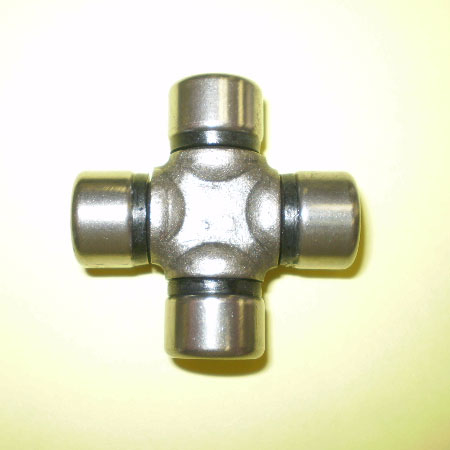

For your Ujoint to be sliding side to side it would have to be not as wide as your original. The caps should seat down roughly tight to the ujoint center casting. There should be almost no gap between the bottom of the cup and where it goes up against the center of ujoint just like the below picture.

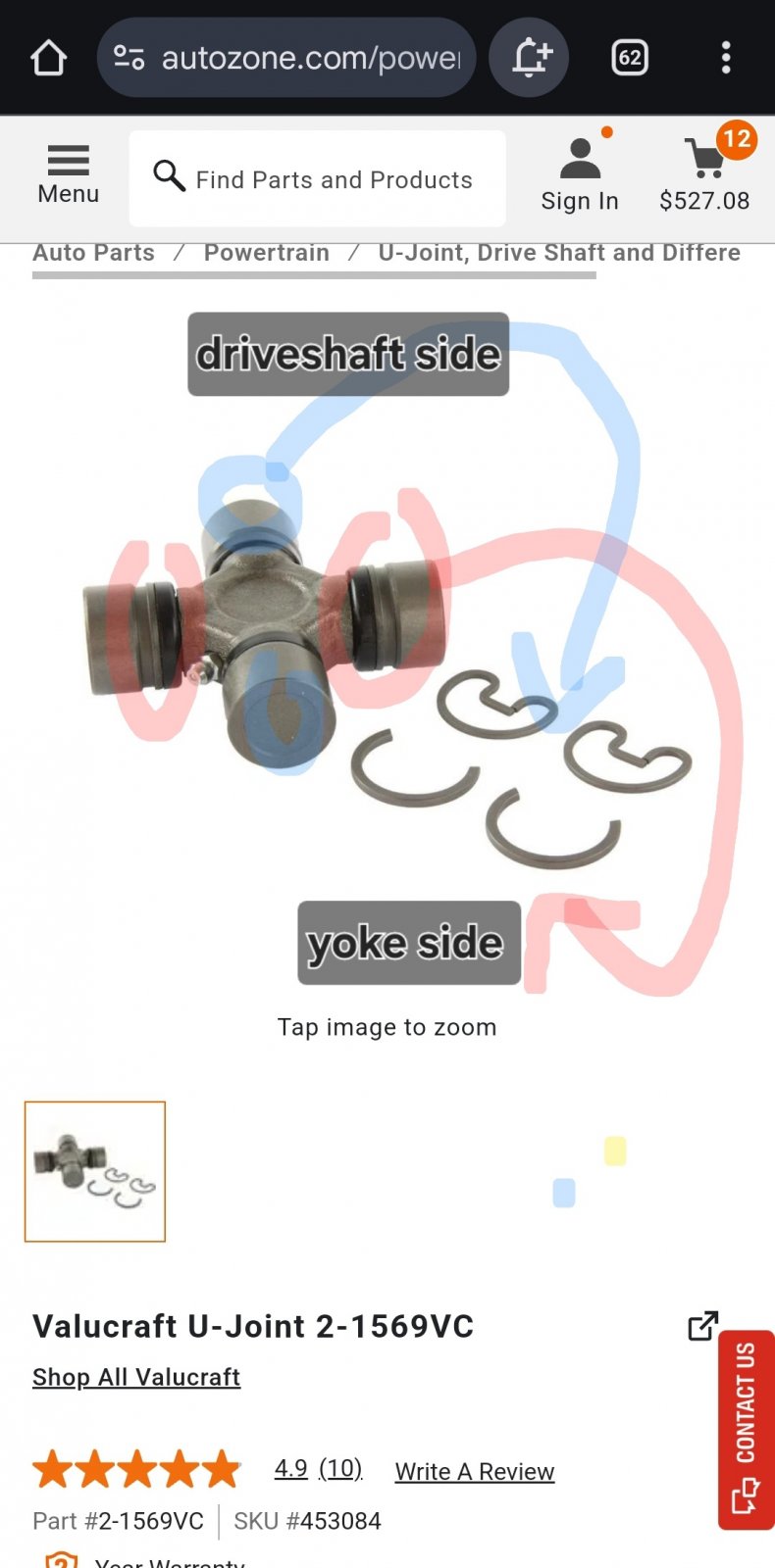

Where did u cross reference 2-1569VC? I got a different number from a Google search? If you look at the part number you located- " 2-1569VC" it shows at the bottom of the page, if an aluminum drive shaft, use 2-0621DL. I have aluminum, and when I search that part number; nothing comes up.
Plus it has the two interference clips, which I'm sure get installed on the drive shaft hole. And the other side of the u joint has two grooves,.I'm assuming those go into the rear end l, and the clips just shim it and stop it from sliding. The joint that I took out did not have those c style snap clips on fhe cups, it was just using 4 of those interface clips on the outside of the cups, against
