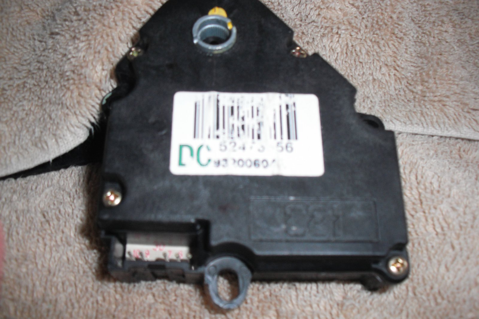

Go to any auto store website and look-up actuator in Hvac section will look something like this. DSCF3892.JPG

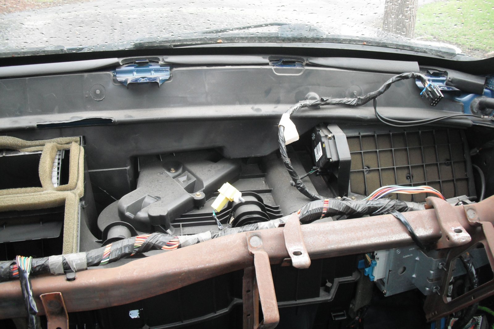

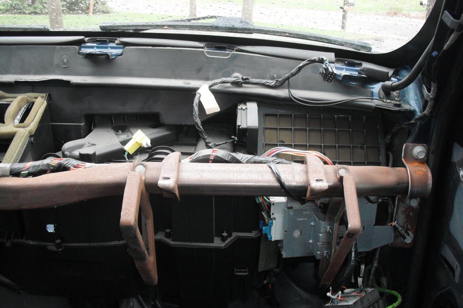

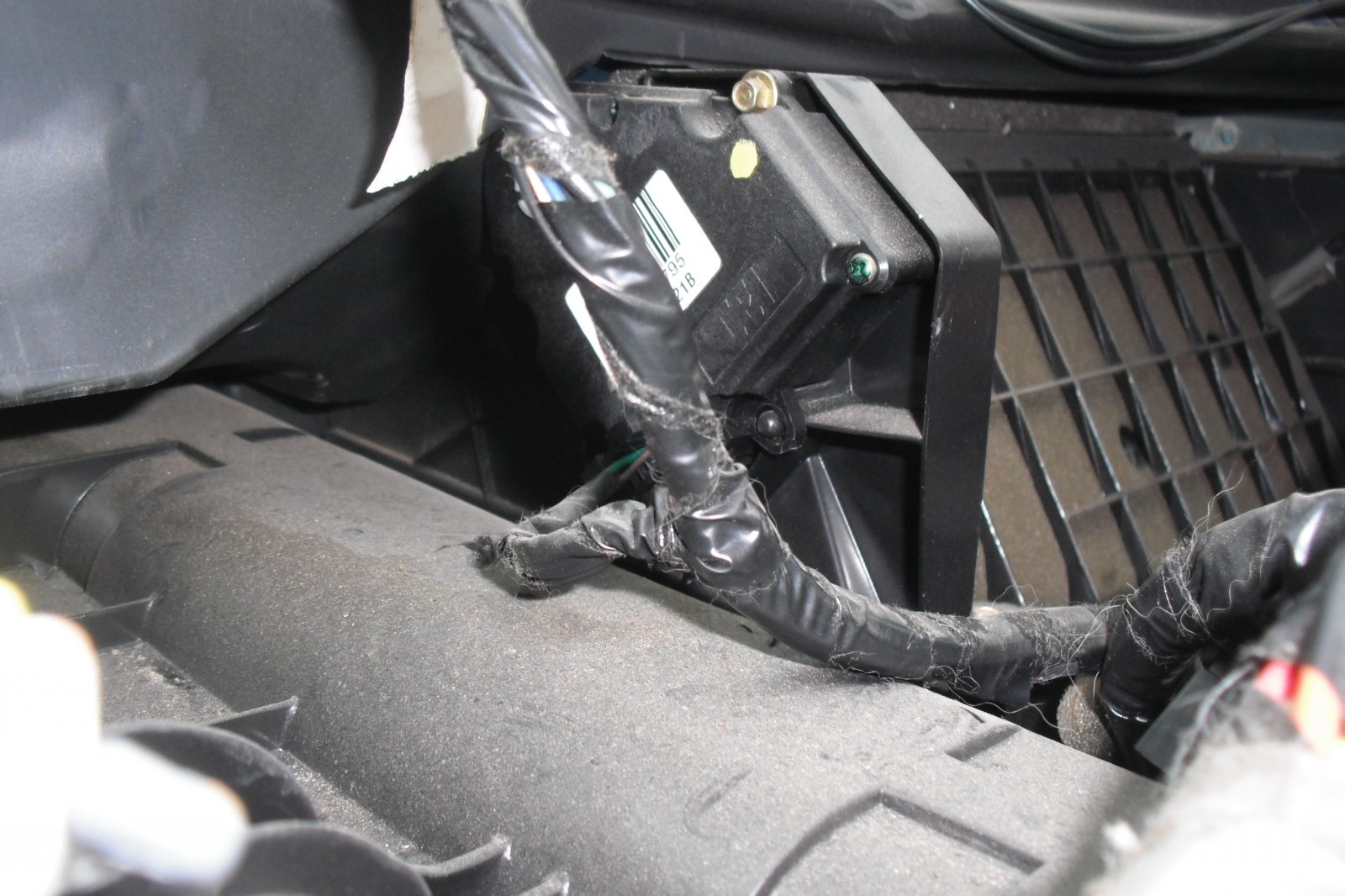

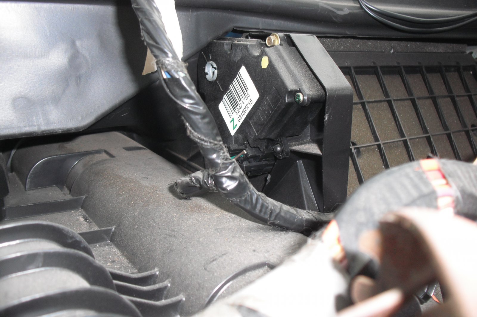

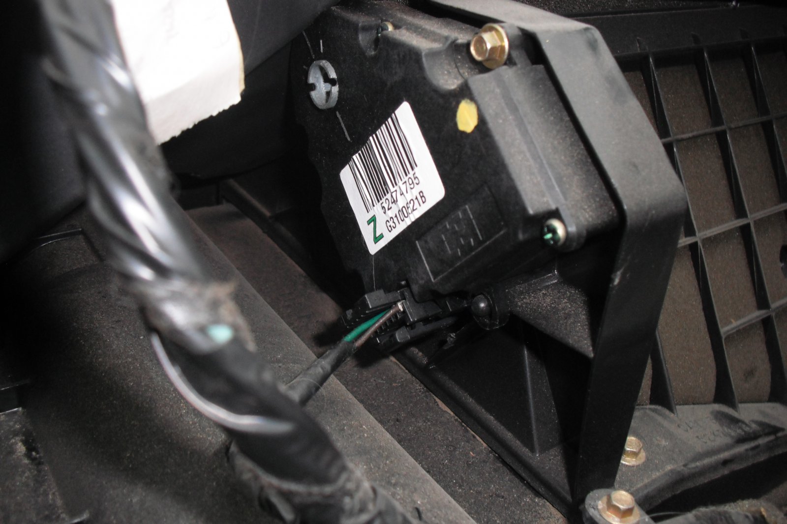

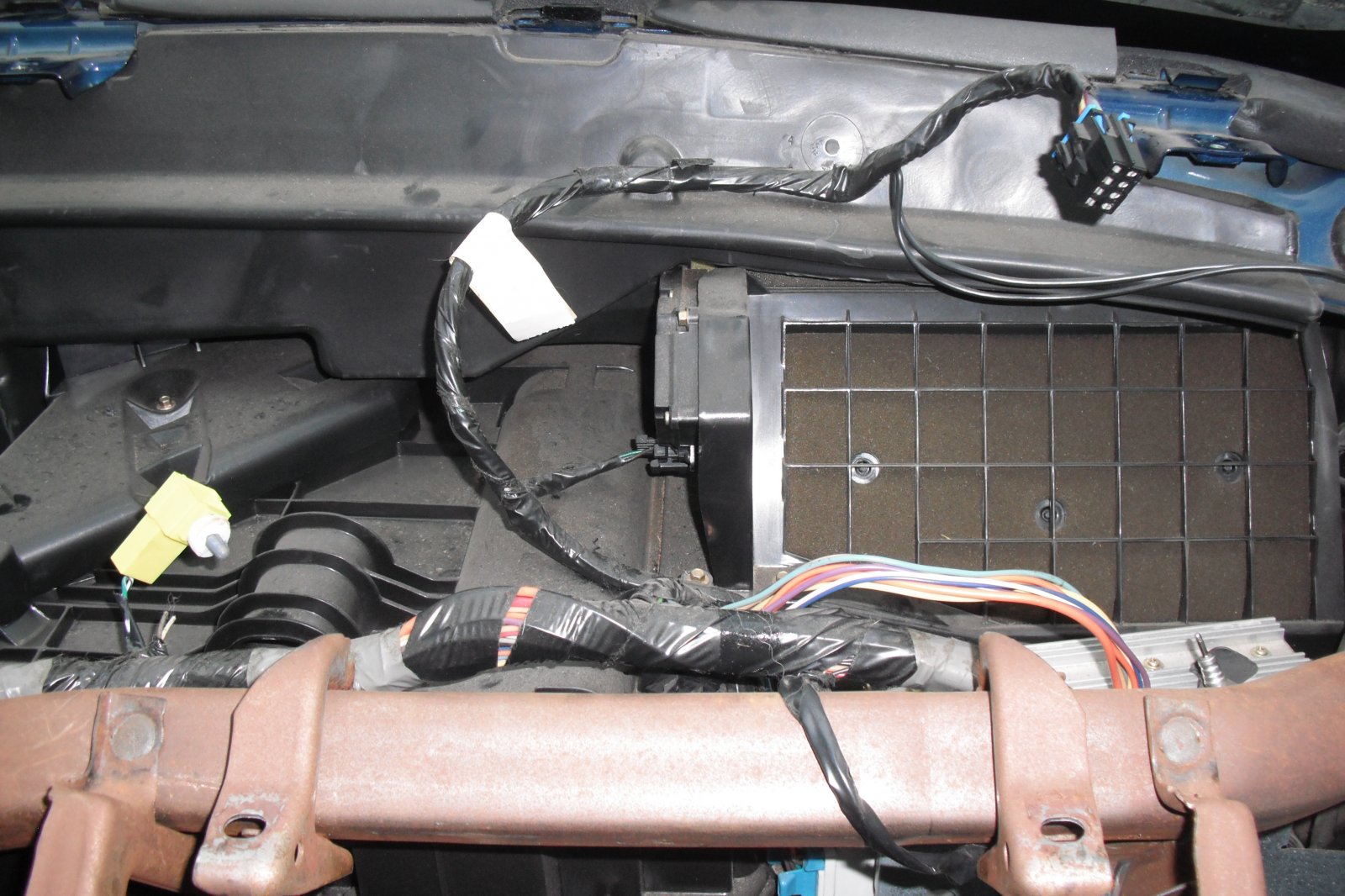

Here is the Fresh Air Actuator. I spent over an hour removing stuff so you and everybody else can see where it is. I also removed all the Plastic vent tubes that run over the top of the actuator making it very hard to see let alone remove. DSCF3922.JPG DSCF3923.JPG DSCF3925.JPG DSCF3929.JPG I removed the Airbag and a bunch of plastic so you can get a real good look at it. You need to remove a lot more than just the dash cover there is a lot of structure that I removed as well.

Wow, that helps a lot, thank you for providing this! This is going to require some serious study but the pictures will be invaluable! Thanks again for taking the time to take and post these!!

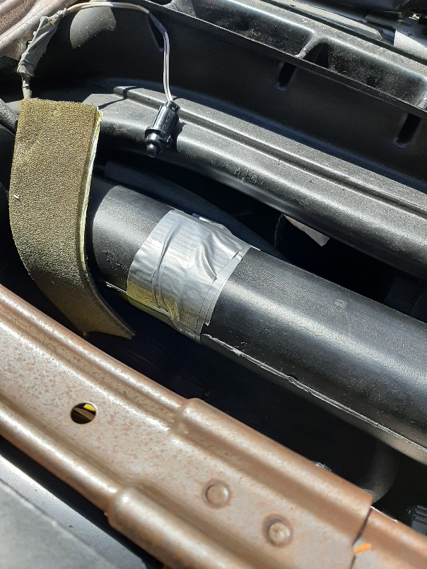

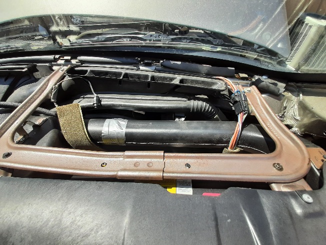

UPDATE - I FIXED IT!!!! It wasn't pretty or simple but thanks to JonnyTahoe's pictures, its done and working! I've been a technician all my life and have had to put things in a lot of places others said was impossible so I've never been afraid to rip stuff up, and thats kinda what I did what I did.
After some significant and very serious language, I could not figure out how to get to it from below. I finally decided the Hell with it, and got out the vibra-saw. Once I removed the u-shaped metal bracket, I sawed the black tube in half. That gave me enough room to get into the 2 screws. FWIW, my Tahoe only had 2 screws so that was a lucky break. Getting the old one out wasn't simple but it came out. Putting the new one back in required a lot of the aforementioned language, but back it went. A little duct tape and reassembly, and another actuator replaced!
Thanks again to Jonnytahoe and everyone else who offered ideas and encouragement! This place is the best!
