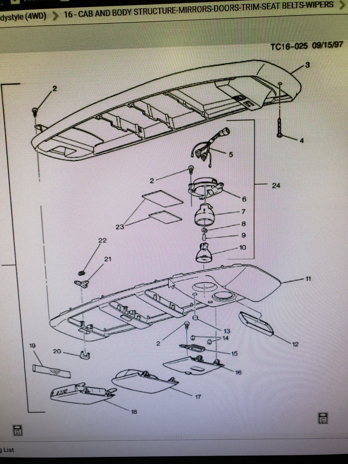

In case he does not get back to you soon, I believe he was asking about the numbers 7-8-9-10 in the first pic. He may need #5 too if has to take completely apart.
It sounded like he was talking about the round lights that come on that you can push and tilt in a few directions.

Your #10 is the entire 1 piece style; it is the lens and the reflector and it is removed by pushing in or up on the lens and rotating it and the entire assembly will drop out. different from what I need. I need the type where you prize off the lens only and after that, remove the reflector, and after that pull out the actual bulb itself. 3 steps to remove 3 separate pieces. look at the attached YouTube link and they show exactly what I am trying to describe. Tahoe LED conversion - YouTube

This is with your vin#, if your trying to remove the bulb you may have to drop the whole overhead and get it from the inside.
