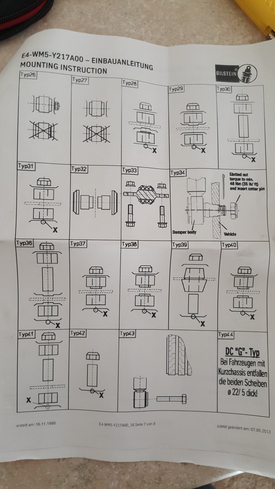

The Bilstein shocks came in. Out of box appear to be exceptional quality, although not sure I like the boots they come with. The lifetime warranty is also reassuring.
However, the instruction show lots of diagrams for installing shock, bushings, and retainers into the top mount. Seems they show about every way conceivable to install the bushings in reference to a type code printed on the shock. I cannot find this type code anywhere on the old shock or the new one. Anyone have experience with this?
I installed them then discovered those silly diagrams. I installed the retainers cupping the bushings with the cup facing the shock braket on the frame. Made since to me, but these diagrams are throwing me for a curve. Here's a video showing my install:
https://drive.google.com/file/d/1xfwWLQya1N0gd40tVaDpyygwjOGcuFd4/view?usp=sharing
FYI ~ The old shocks top retainer was installed as a V going down into the bushing. I think this is why it failed... I believe the nut eventually cut through the retainer in that orientation. but bilstein instructions show this as a feasible orientation?

Here is orientation i used to mount the shock... upper mount is in the middle.
I have also included the instructions which make no since. They reference a type number which they say is on the shock but none of the shocks have a type printed on them.
