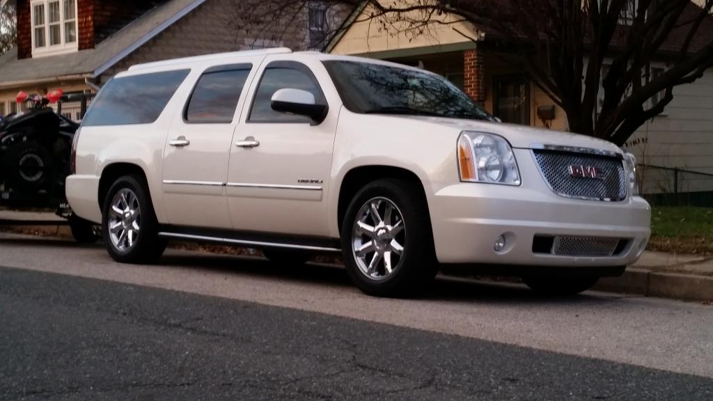

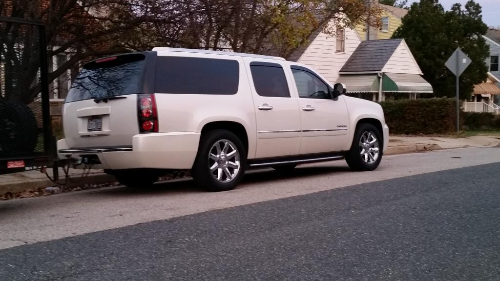

Hey guys. I picked up a 11 XL Denali in October and like everything else I get my hands on I can't leave well enough alone. I installed a 2/4 drop (norcall ss), debadged the rear and a few other odds and ends within the first couple days of ownership and haven't stopped since.
I have a few major upgrades planned for this upcoming spring and summer with wheels - Chrome KMC slides - being the first once winter breaks which leads me to my current decision. Is it relatively simple, parts and cost wise, to go from a 2/4 drop to a 3/5? Can anyone tell me what parts are needed? Can I just purchase a few items or do I need to scratch my 2/4 and start over?
I ask because I'm deciding between my current 2/4 drop with 24" wheels vs. changing to a 3/5 drop with 22" wheels. After putting a few thousand miles on a 2/4 drop with o.e. 20's and the factory 275 rubber I've come to really like the ride in terms of comfort, just not 100% satisfied with the drop/wheel combo. I'm leaning towards 22's vs the 24's because I feel like the 22's will give me a better all around ride, but then to satisfy my drop craze I'm going to need to go to a 3/5; however, if I purchase 24's I'm pretty sure I'll be content with the current 2/4 drop.
Here's a few pics of my new ride. So far I'm pretty stoked :licklips:

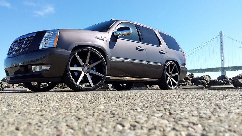

IMO I think you should go 3/5 with 24s. I think with it being a xl the 24s will really look good especially with a 3/5 on it. As far as going to a 3/5 you'll probbaly need new coils for the rear and for the front you could probably do Tony's strut mod to get that extra inch you want

my truck is a 3/5 on 26s
on my truck on 305 35 24

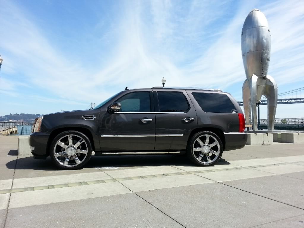

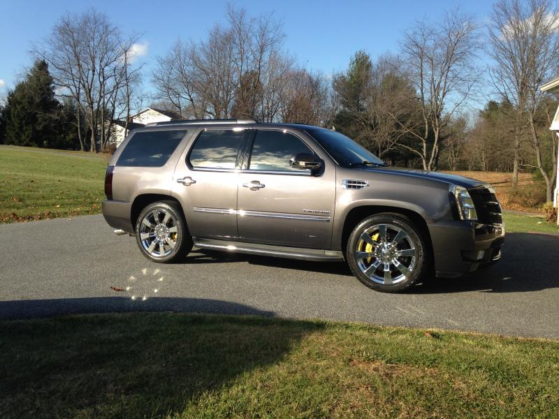

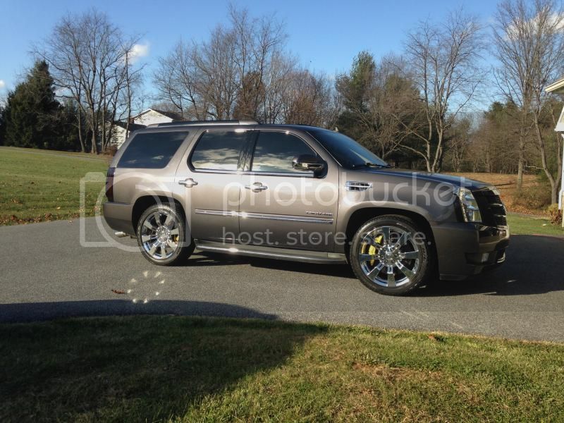

I would not go with slides. 22" slides look to small. If you did 22's get OEM's. I have CK375 OEM's that I use for winter. 24" rims will look the best and ride isn't that bad as well. I have had 22-26's and use 26's during the summer and to me ride isn't that bad at all. To me I would stick with 2/4 drop especially since I see you are from MD as I am as well. Just to give you some examples of mine and what CK's look like on a 2/4 drop.
Ck's
26's

Once again I've changed my mind! I'm going to take the advice of everyone that's been kind enough to post here and go with 24's.
the order for the 22" slides has been canceled!
Ck's
26's
Thanks for th info :) By chance are you in the Baltimore area? Willing to let me take a look?

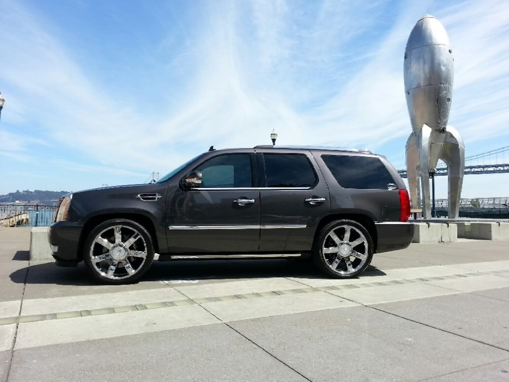

24x10 esky reps
2/3.5
and 3/5
and 3/5 with 26s
Them Esky reps sure do look sweet!
