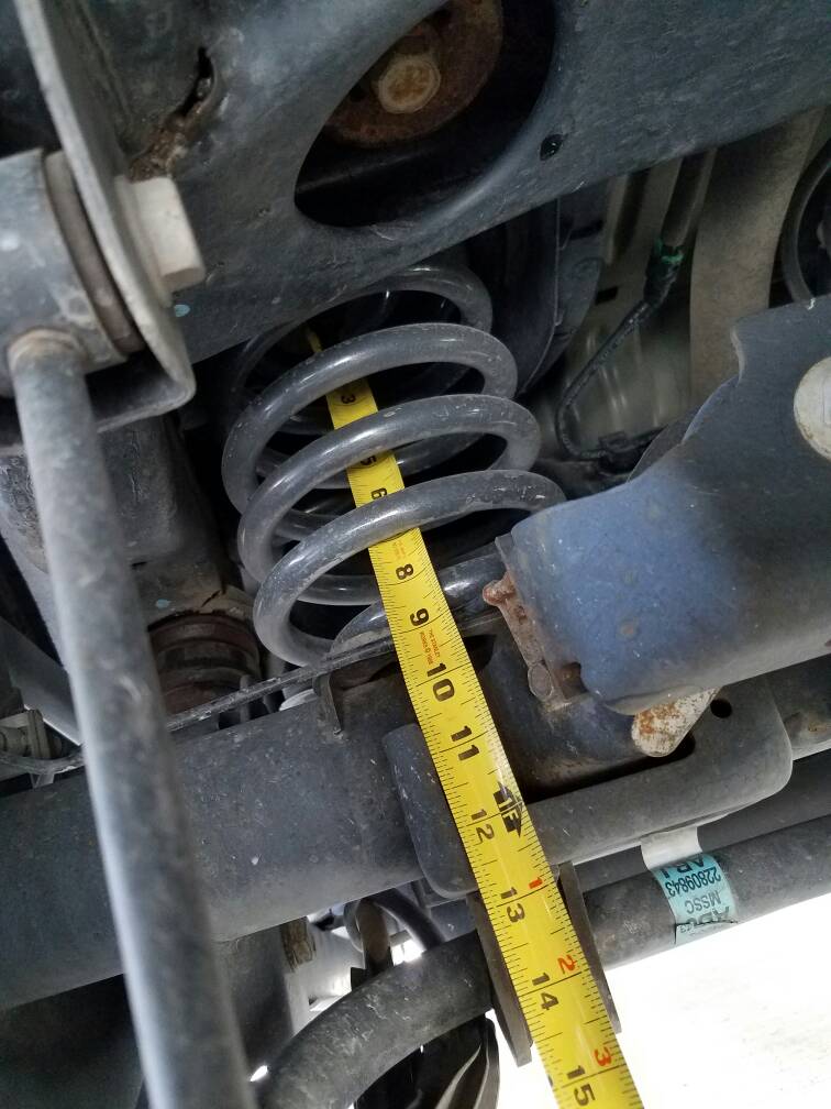

Yeah those have a lot to be desired. How much space between bumpstop and axle in rear

I'm going to to try to dial what he has in it now. In rear I just need to know how much space between axle and bunpstops

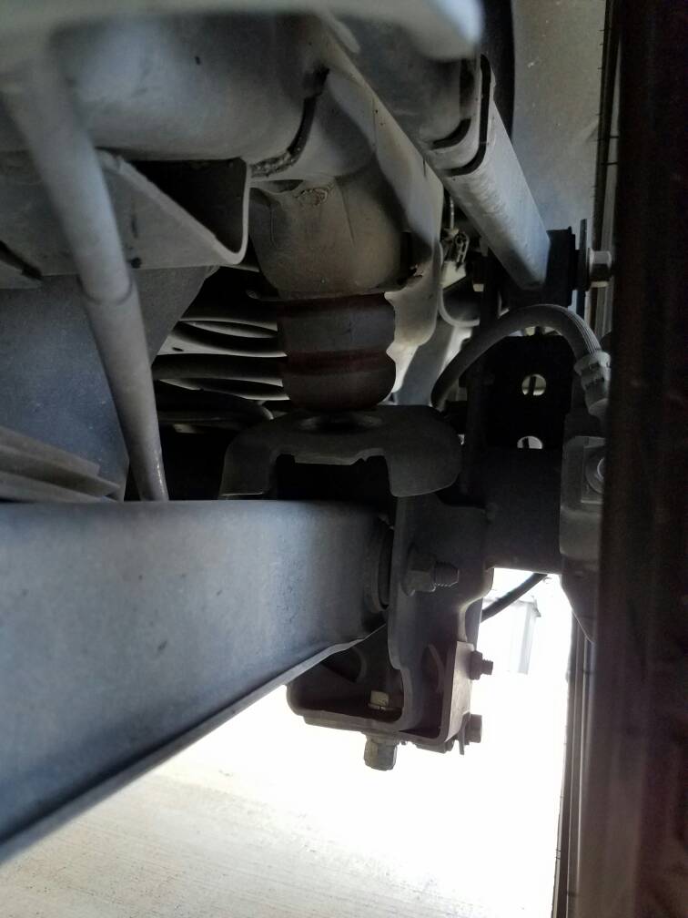

I have about 3/8" to the rear bumper stop (didn't trim). Perhaps that is the core of my issue? I didn't trim the fronts either, but that may not be the issue here.

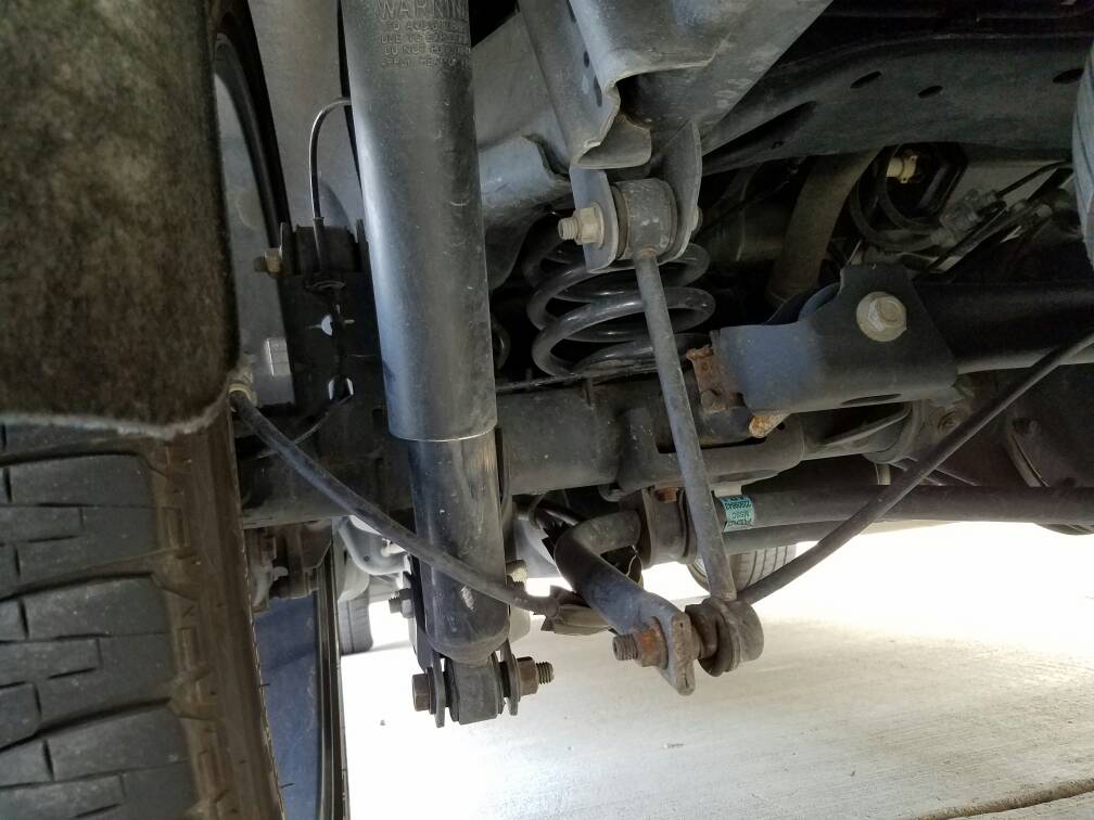

You must be hitting the bumpstops in the rear with them being that close. Looks like you'll need to do the free travel mod. Also I see your swaybar isn't parallel to the ground so you'll need rear endlinks. Tony @ Norcal can help you out with those.

You cut off the bracket that holds the bump stop and then add a small pancake bumpstop directly to the frame. At least that's the way it's done on the NBS/ NNBS. I used a Sawzall on mine.

Just take a long sharp knife and lay underneath and cut the bottom half of those bump stops off for the time being until you cut the entire brackets off the frame
