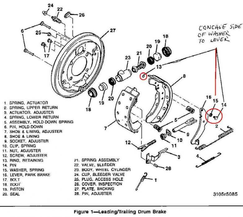

So here I am fixing another issue after thinking I had finally gotten them all. My driver-side brake is busted. The left shoe inside the drum has dug up under the "anchor piece" (not sure the proper name. little bottom metal piece with 2 rivets in it.) This is causing the shoes to not properly push on the caliper to the point that the caliper comes all the way out and shoots out all my brake fluid in a minute or less which obviously causes other problems.
That said; my question now is do I go ahead and drop the $450-600 on a drum to disc conversion kit or is there an easier fix such as possibly punching/drilling out the old piece and bolting in a new one?

Its the piece on part 27 just left of part 18

From my understanding to remove the backing plate requires taking the axle out which I'd like to avoid if I can

Yes, axle removal required for backing plate. Change Axle seal Also.

Hey man, did you figure a fix? I have the same problem. An old fix I found on it after I bought it was the rivets were drilled and bolts installed and the outside arched piece hammered flat and reinstalled. I did the same thing but looking for a more permanent solution without removing the axle to replace the backing plate.

We've got some real terminology problems causing a lack of communication. If you thingy at the bottom of the backing plate is broken you need a new backing plate. Yes you need to remove the axle to replace it. If the other backing plate is looking bad I'd replace it too, seeing how it's 23 years old it's probably well worn. If you pull the axles replace the seals with quality seals. There's a good chance the brake shoes are warped now and possibly were installed wrong at one time, I find that common with this style brakes. I would also replace the wheel cylinders and any hardware that doesn't look good.

Which may be cheaper to convert than spend money on old school brakes.

I understand there is a terminology issue for most here but not myself as I have been looking for a fix and know exactly what the OP is referring to. The BEST way is to pull the axle out replace the backing plate and axle seal and call it good for the next 20years.
Yes the bottom of the shoes are warped/ bent pretty bad.
Thanks for the input!
This I what it should look like, driver/left side rear.
