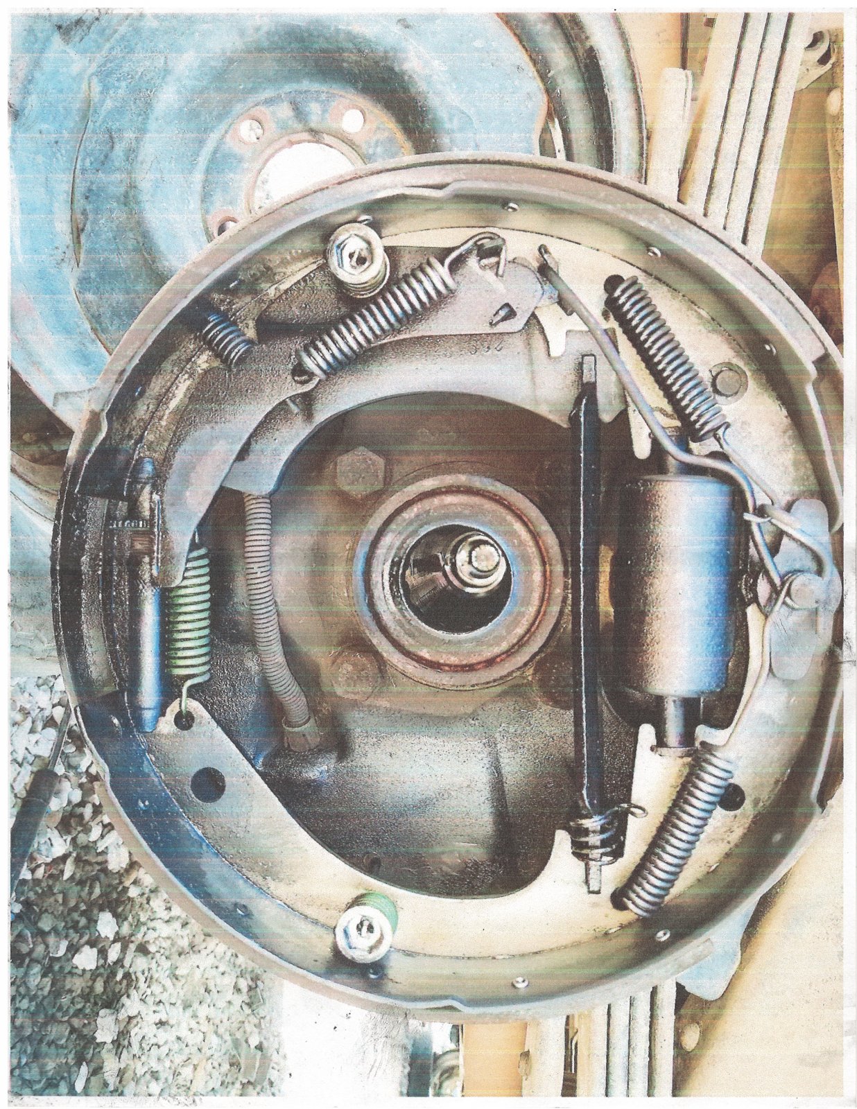

This is a photo of my 1999 Tahoe 4x4 rear brake shoes but at the wrong angle. Hope it helps. I also had a problem with the ebrake cross member. You may notice mine is brand new. There may be different parts for each side but I don't remember since it has been a couple months since I did the repair. I had this Tahoe since new and have always done my own repairs so this is the original setup.

bsamole, thank you for the photo looks like it's the passenger side, yeah every thing look's the same, you don't recall what the problem was with the cross member? I'm gonna have to open it up again, maybe buy a whole kit? thanks again

If my recollection is correct I believe one of the tabs was worn down as if it was placed on a grinder. I suspect that I had assembled it incorrectly during the last brake shoe replacement.
