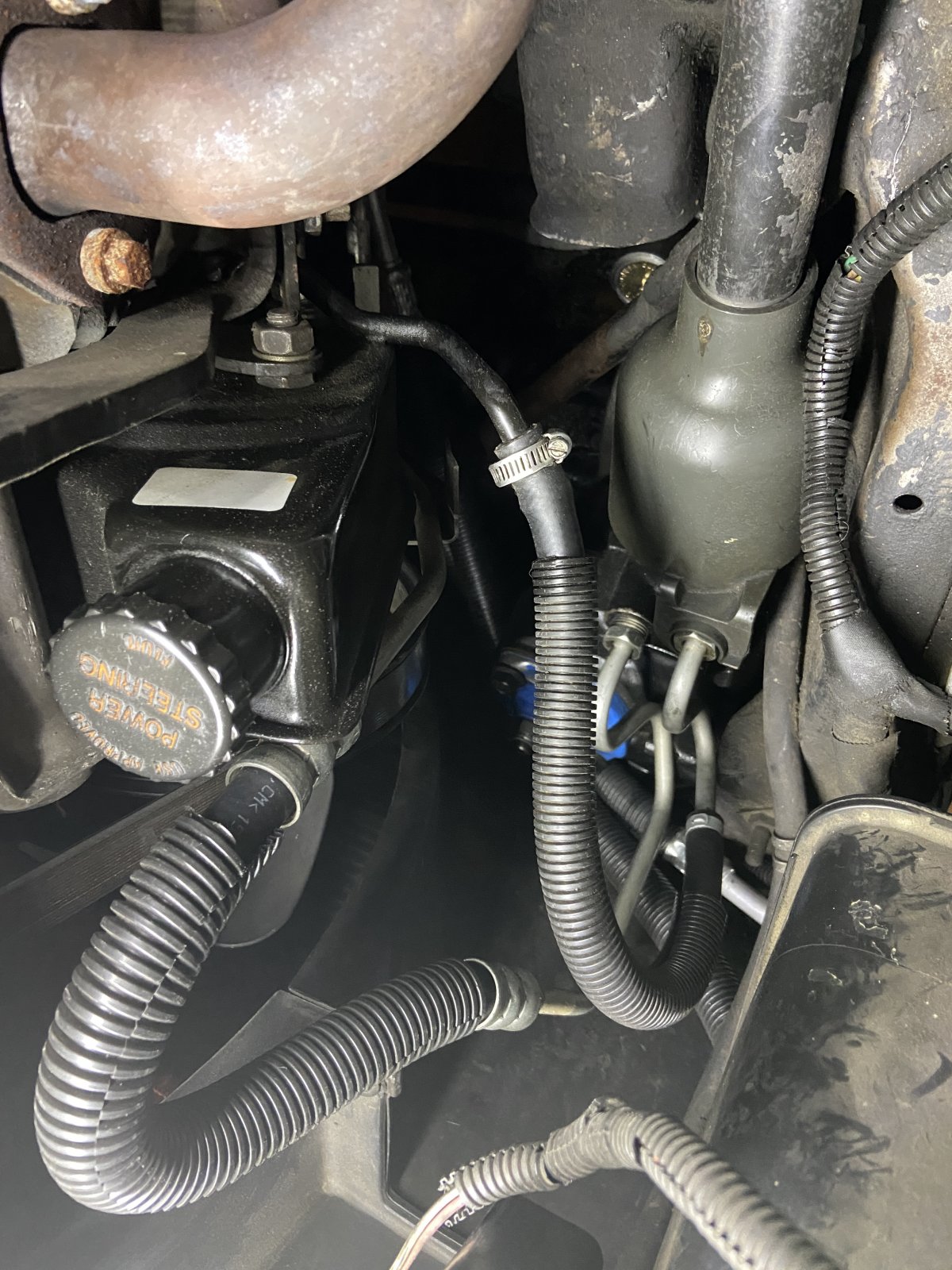

Ok i want to start by saying i got everything back together. On initial start up after replacement, the steering seemed fine while i cycled it to purge all the air out of the pump and gear. No after a couple of days, there is no power steering at idle/low speed, almost like the pump quit. When you rev the engine a bit it comes back a bit, at highway speeds it acts fine.
I looked over my work , and noticed one thing. Looking at the old gear, it appears that the ports are swapped compared to what the new gear has.
New one the with the line locations swapped.
Thoughts suggestions?
Thanks ahead of time.

Update, Sorry i have been busy. A another "NEW" pump fixed it. i am still frustrated by the quality of replacement parts these days.
Thank all
