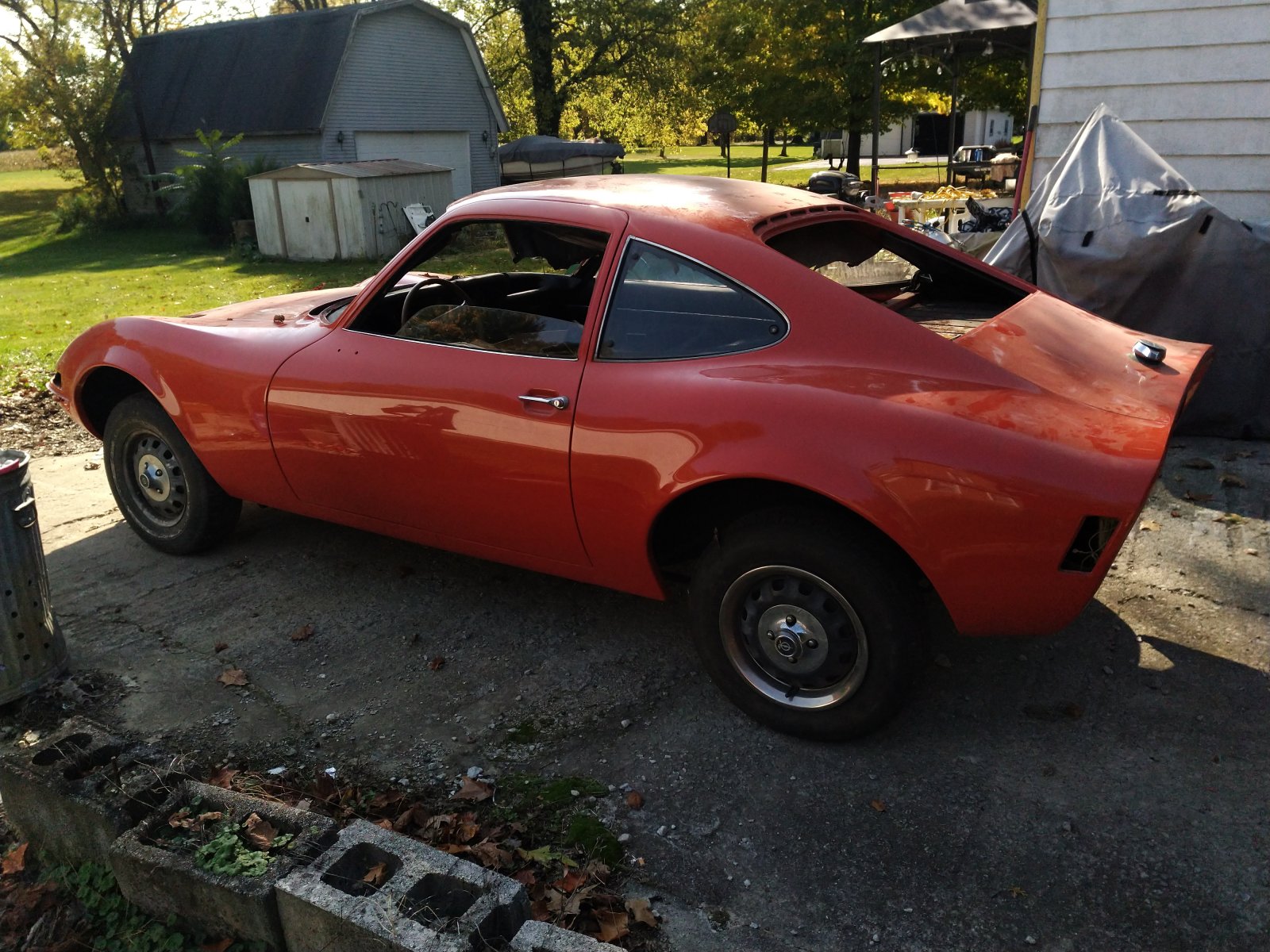

So kind of a GM car.
I bought a rolling Chassis. Fresh paint no interior or drive train. $1000
Shipping cost me another $650
I'm in the process of buying and building a 3.4 Chevy V6 to drop in it.
Now a stock 1.9 4 cylinder is about 80+ HP
A stock 3.4 V is about 180 hp.
Swap some heads and intake stuff? You get about 200+ HP.
Should be fun!

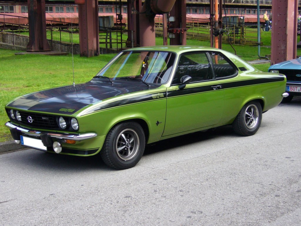

This is identical to the Manta i had, except mine had a front air dam I had on mine. I also had beefier springs for the 2” drop. The GT is a cooler looking car.
