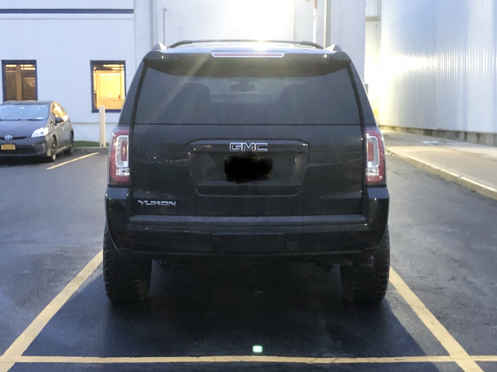

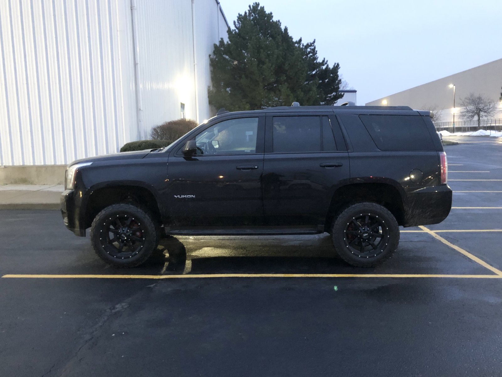

Picked up the Yukon last night after the 4” front , 3” rear ReadyLIFT SST lift install. Was going to wait to post until I could get better pics, but the sun isn’t supposed to come out for the next week plus around here, so good as it’s going to get for now, haha.
Overall I think it turned out good. Geometry of upper control arms look good, front diff is dropped. I think it looks noticeably taller than the 2.5/1 level I had on. Rides same, or I’d even say a bit better, than it did with the level.
Front fender openings measure out to 40” from ground, rear 40-3/4”. This is with 285 55 20 BFG KO2’s (wheels are 20x10 -24 offset by the way).
Upon after hours pick up I had a “steering assist is reduced” message on the gauge cluster display. Used my programmer to clear DTC’s and it cleared. Spent an hour crawling all over it when I got it home. One UCA ball joint won’t take grease, I’ll try replacing the zerk. New front diff skid plate actually tucked up under the plastic gravel guard, so no major cutting there, looks clean. On the rear I noticed the upper rubber coil spring isolators weren’t reused, the bump stop extensions weren’t installed, the diff to brake line spacer wasn’t installed, and the shock extension brackets were mounted on the bottom of the shocks instead of top. Shop had various reasons why they did what they did, don’t think they’re used to a customer who read the instructions front to back more than once, but in my career attention to technical details is important so I can’t help it. Will get that all worked out.

the look is spot on...
i would consider a taller vs wider tire when needed. personally, our 285 on a 22" wheel pulls more ruts that any vehicle i have ever owned, even the ones on 40" tires.

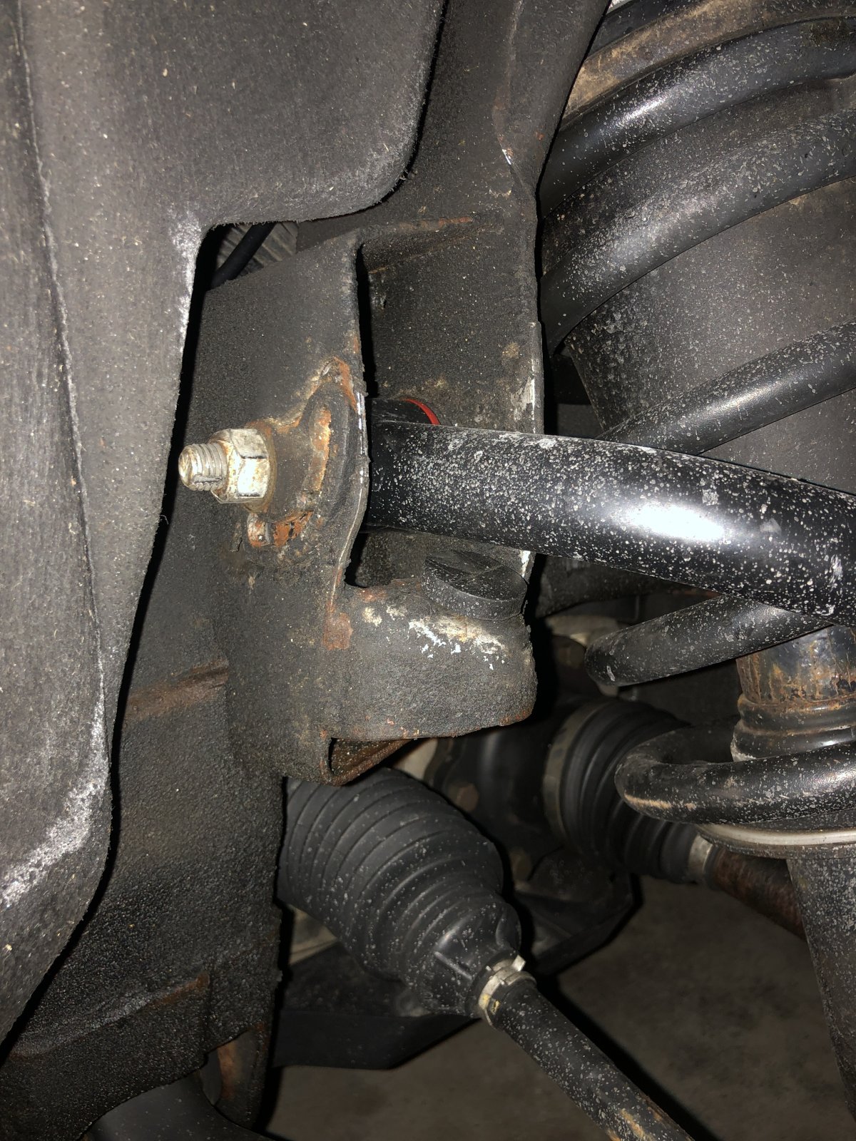

any chance of getting a front suspension pick with arms at full droop ? feel free to say no or take your time, it is just a wish.

Good point on ruts, I've noticed that. And the narrower tire is better in the winter, before I knew better I ran 325's on the snow/slush/ice, slip sliding my way through the season.
No problem on the droop pic, when I'm messing around with the zerk this weekend I'll throw the floor jack under the frame.

well, not as bad of an angle as i was expecting...that said, it appears to not have much droop
i am guessing ti is very close to the upper arm bump stop. typically, that make s for a harsh ride as most hits are initiated by a droop of the suspension
Agreed, huge impact on ride if there’s unwanted contact there during normal driving.
Pic of clearance between new UCA and droop stop bumper on drivers side, passenger is a bit less eyeing it up.
With the 2.5 suspensionmaxx they have you trim down that rubber bumper, I picked up new ones for the ReadyLIFT at full thickness. I thought with the level it looked a bit tight with stock UCA’s, looks like more clearance with the ReadyLIFT UCA’s. I’m curious what it looks like stock, I didn’t start paying attention until after I started making changes
