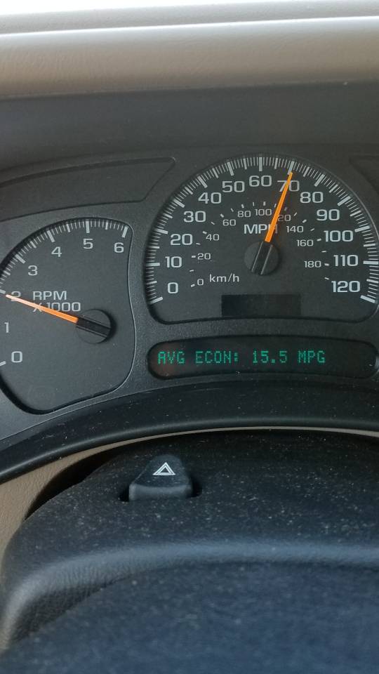

Ok so I'm documenting mialiage before my new maf sensor from rockauto gets here tues it's an 05 Tahoe Z71 getting bout 16 mpg at 60 mph ,I pulled codes and it read bad maf so I unplugged batt ,check engine light went off and hasn't came back on ,I will post results soon with new maf

Ok here's update with new maf

So no real changes I'm afraid new torque converter coming soon

Tahoe mileage is dependent on rear gear ratios , whether it is 2wd or 4wd and keeping cruise rpms at 2k or below. If you have a truck that’s 4wd and has 3.73s or 4.10s you are screwed on the hwy. our ‘04 2wd will do 21.0 mpg at 65-67mph. Our ‘03 4wd has never gone better than 17 and most trips are 15 mpg. We rented a ‘16 that would do 23mpg at 79 mph all day long.

Dead stock ‘05 Tahoe. Around town/mild hiway use, about 14.8. Extended hiway driving, was 20.6.
This is according to the DIC.
